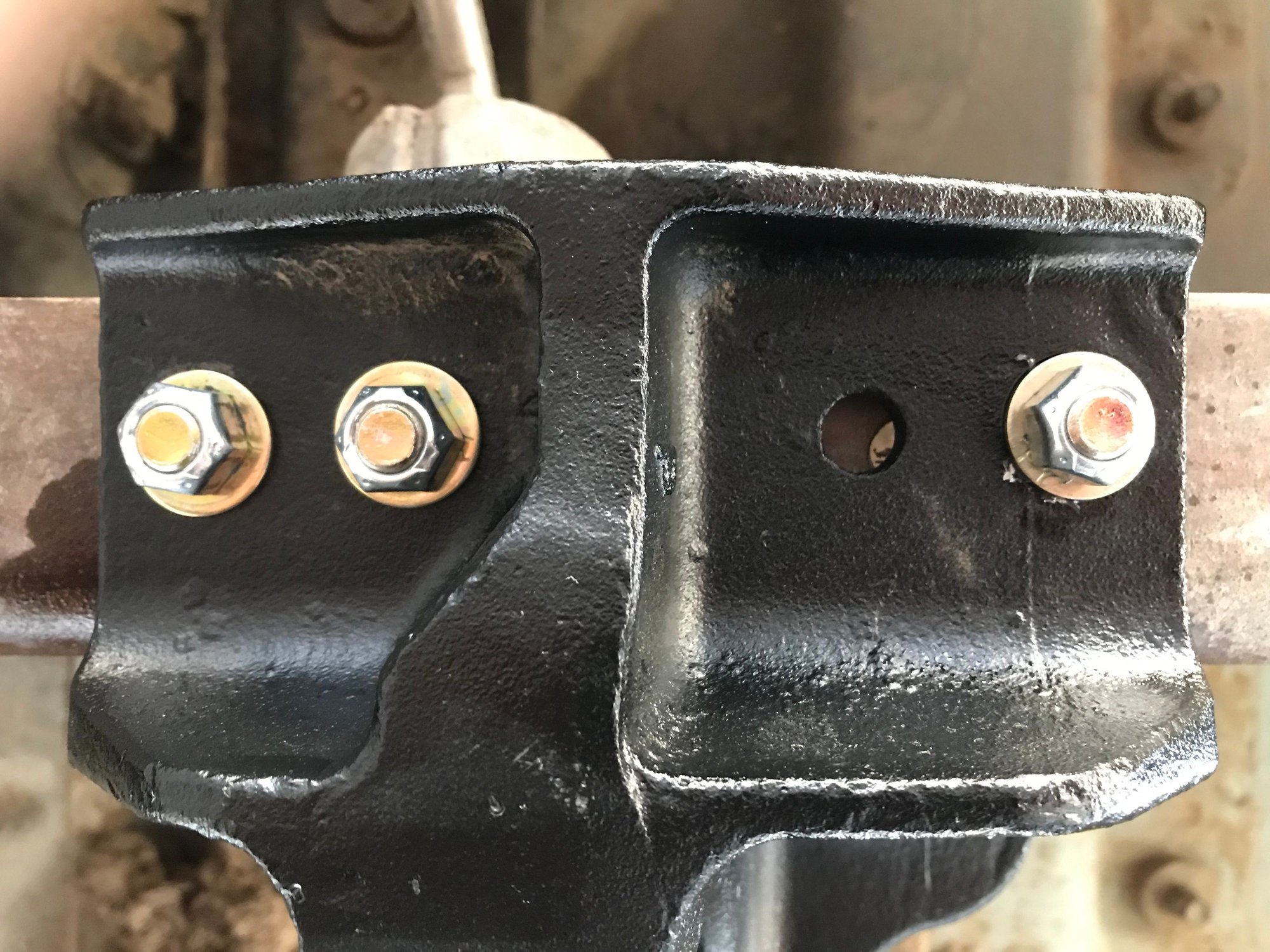

Talked to OUO: There are 8 holes per mount for the "self-anchoring" type bolts that would be used on a box-framed truck. For our old open "C" shaped frames, only 4 bolts/buts are necessary per mount.
I ended up using 2 out of the 4 factory holes on the frame, and drilling a 3rd on the bottom rail (sides I used all 4 bolts). The 4th hole on the bottom lined up half-way with a factory hole and if I drilled it, it would have essentially made one big hole shaped like a figure-8. I opted to not bother with this.

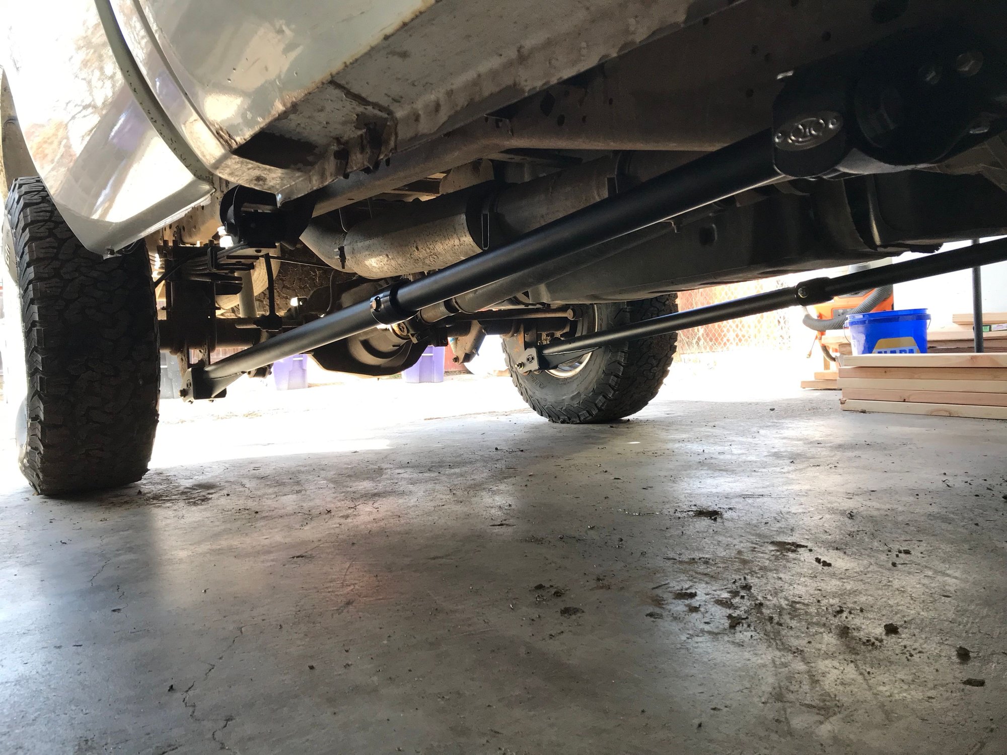

Got them on. The bucking I experienced at times with the wheel turned all the way in reverse is GONE. Shifting is also much smoother. I used to be able to feel the driveline flex in the shifter, not anymore.
Here is the hole I didn't bother drilling.

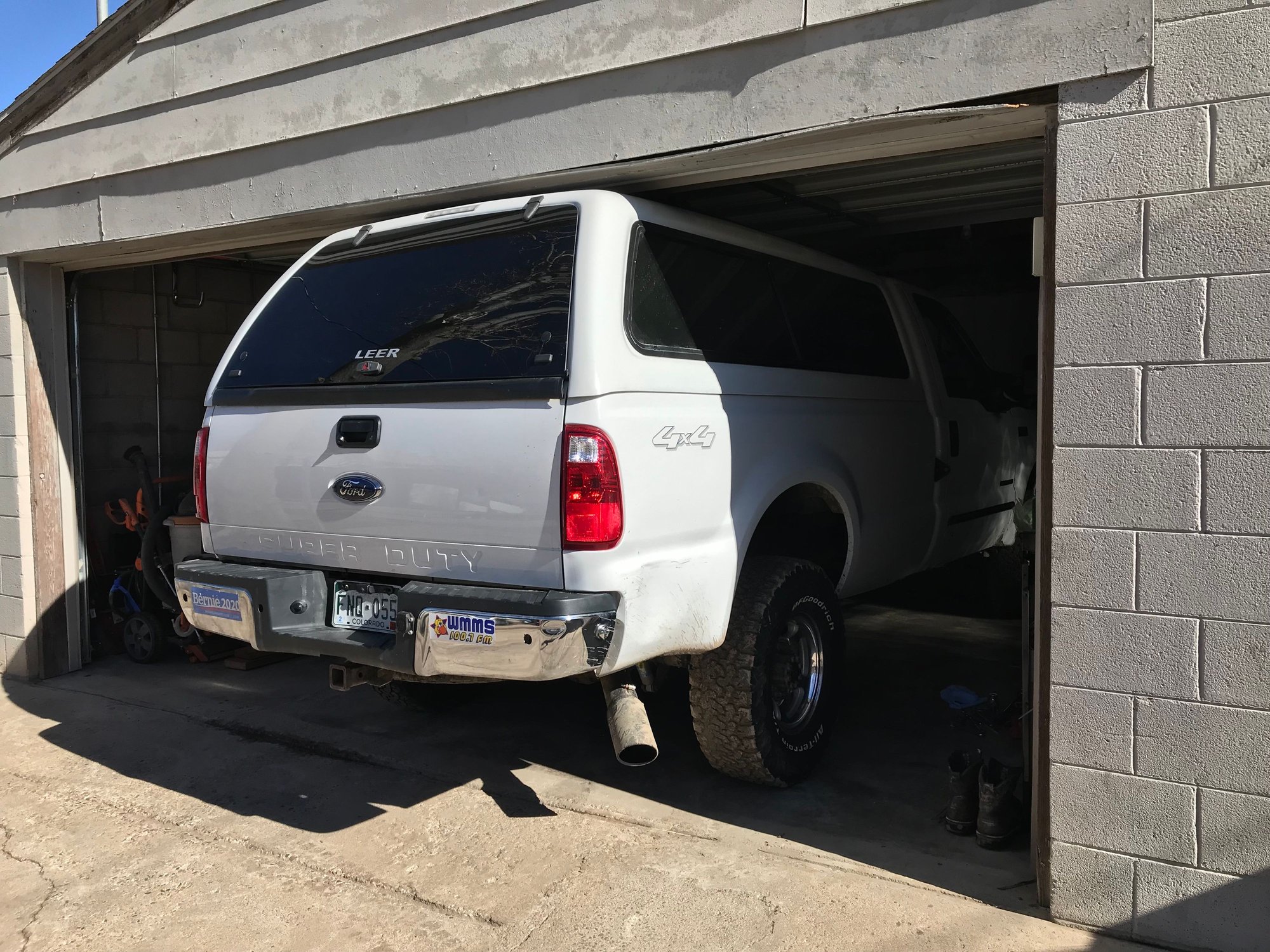

Truck barely fits in my garage (there is less than 1" clearance to the door after I changed to the 3-1/2" F350 rear blocks.

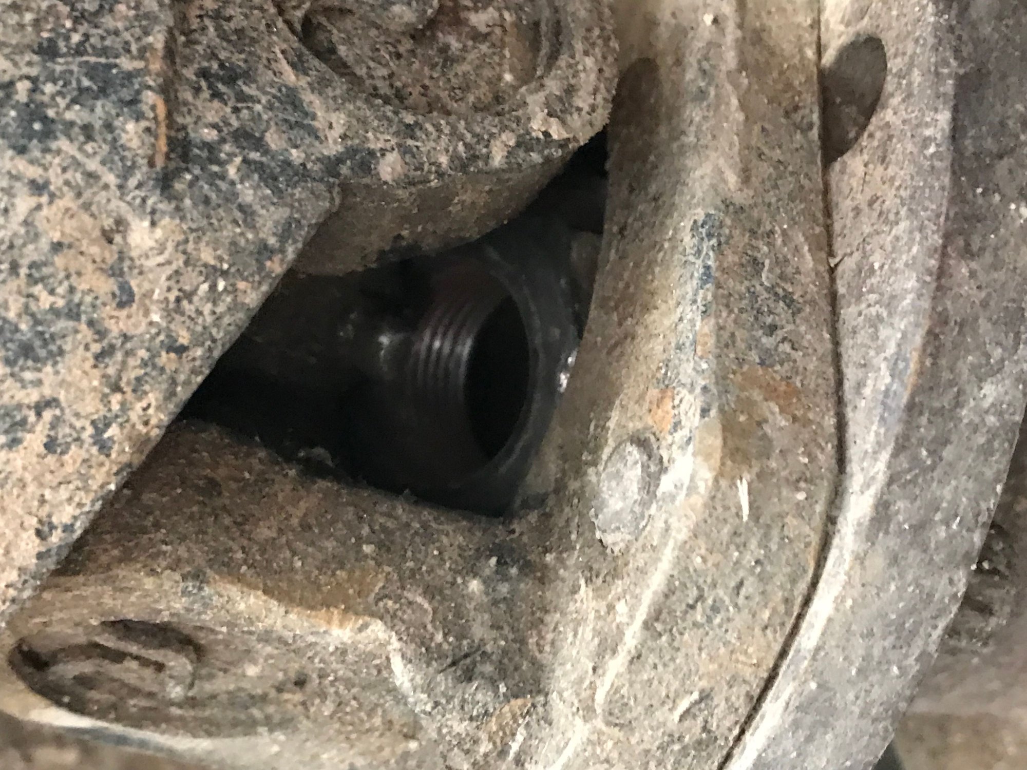

And my front driveshaft was missing a zirc fitting... got one put back in, but I cannot for the life of me get my grease gun tip to fit in there. How do you guys grease the front-most fitting?! (This driveshaft was rebuilt less than 10k miles ago - another stellar shop job!!)

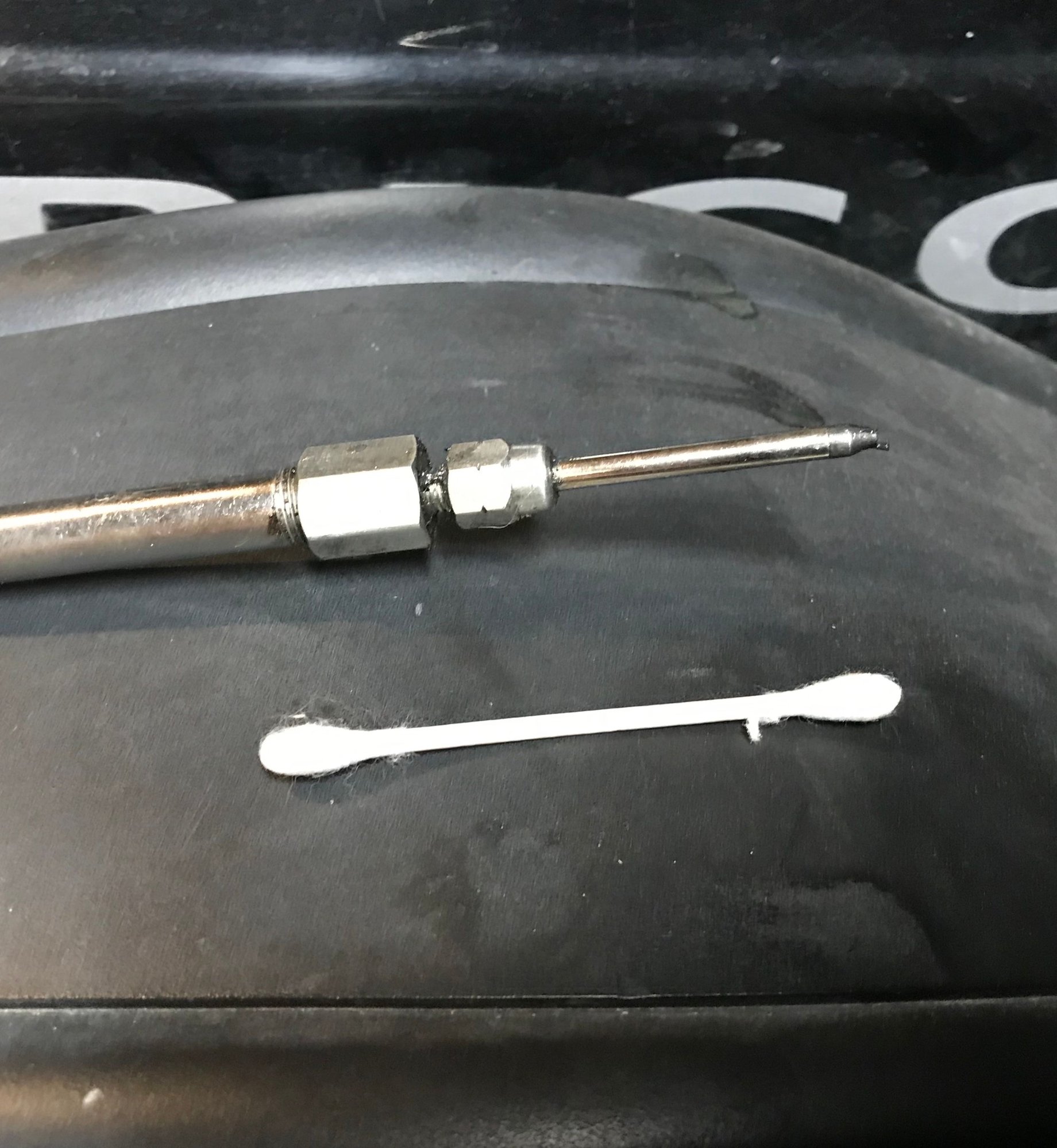

Those look great. Regarding greasing the u joint, try using a needle nozzle on your grease gun.
Amazon Amazon
This option works great, The initial investment kind of hurts but you use it a lot more often than you think.
https://locknlube.com/collections/lo...ase-coupler-xl
https://www.amazon.com/Carbyne-Greas...a-570352767525
The needle is interesting, hard to tell by the scale, is it so small that it fits in the tiny hole where the little check-ball is?
Here’s a comparison for reference....
