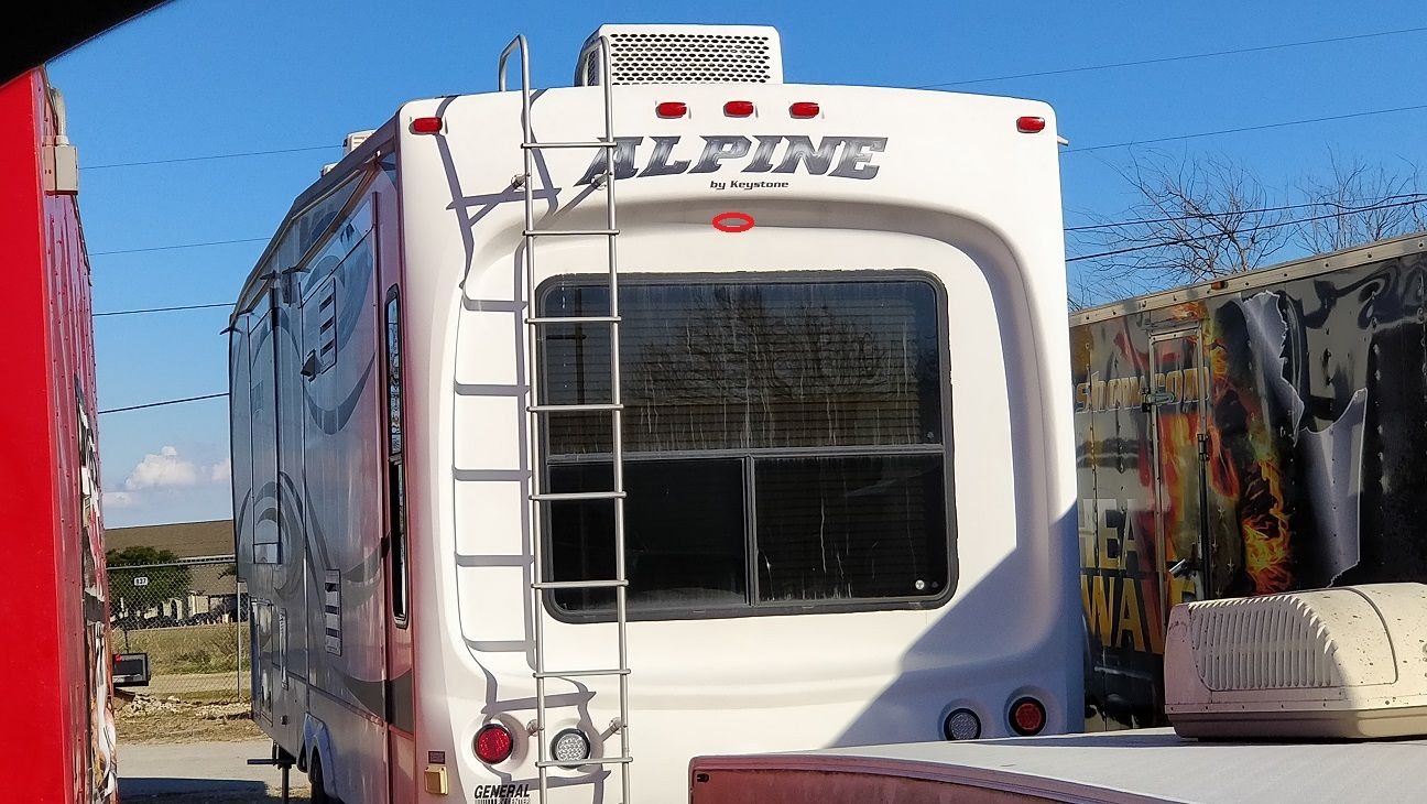

where did u mount your camera? i have a big back window and above that is the trailer brand logo, so I think in the window surround area is better...(red circle)
Looks like as good a spot as any, that rear cap is going to be a pain to deal with either way. I didn't have a window to deal with, so mine was installed just under my lights, above the logo, and then run inside the trailer through the kids's bunks. I've got photos of it installed over here:
Ford OEM TPMS for trailer - Forest River Forums

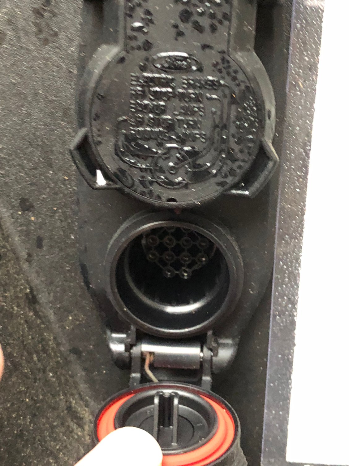

My understanding is with the 249.00 kit, you can get 1 of 3 different cable lengths (same price regardless I need the longest 64ft one) and it plugs directly into the empty dummy plug located by the spare tire. That plug off the truck just has a plastic cap plug on it, and is only on trucks with the ultimate tow camera 360 option which my truck will have. My truck is set for delivery on 2/19 hopefully!!!
That is how it works, just plug in, and voila!
I got the 64 ft cord
