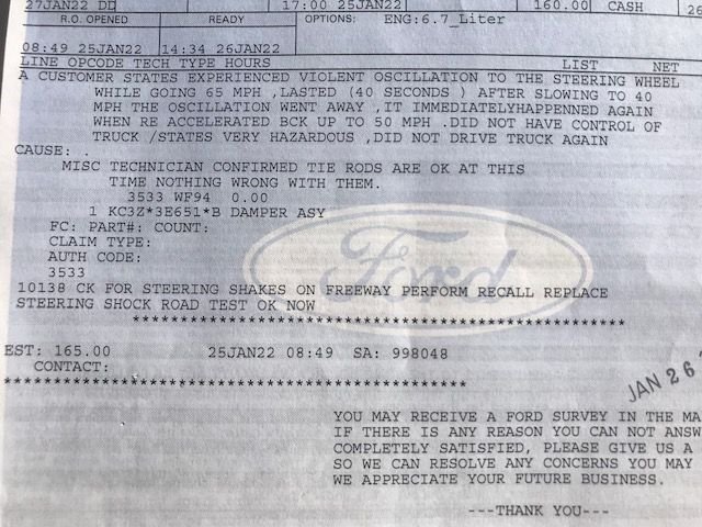

Update - Just got my truck back from Ford. The tech said he checked the front end and everything was tight and performed the TSB 19-2392. I hope this will solve the problem, but as others have mentioned 'it's just a bandaid'. Here is the paperwork from Ford.
Weird that he only mentioned tie rods being checked. Hopefully they actually checked everything else up front and just didn't note it.

I doubt they checked the tie rod ends, at least not correctly, or they would have been found loose when new.
Ford says put a stabilizer on because it's the cheapest thing to get you off the lot. It doesn't pay much to install, so the tech isn't going to spend time looking at other things.
Yep, agreed.
I'll beat the dead horse again...
Like I posted earlier, it's in the best interest of the dealer to put the cheapest and quickest fix to get you out the door. Congrats. They did not really solve your problem
Loose parts. Worn parts. Alignment. Tires. Shocks... check all these and throw the factory stabilizer in the trash. Just throw on ONE good stabilizer (bilstien, fox...) in the stock location, once everything else checks out...
And just because the alignment is "in the green" doesn't mean that it's correct. Aim for 4 to 5 degrees of caster, no camber, and a slight toe in condition (about .25 degrees which is about 1/8" in when measured at the outside of your tires)
