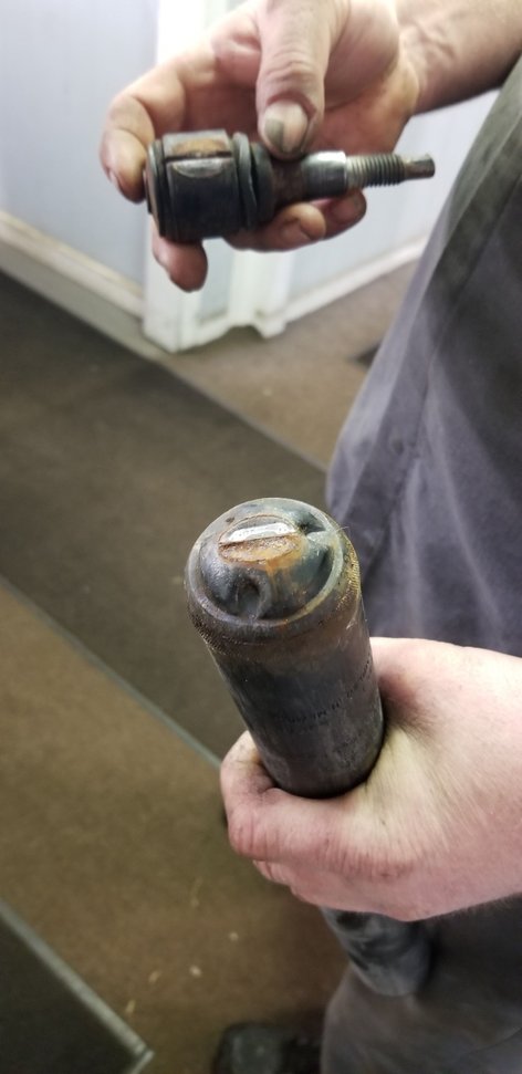

Well what do you think? This came off my truck today for the revised one. It broke in the techs hand. 2017 with 14k on the clock. Truck feels much better now. I had slight shimmy and bump steer hitting certain bumps. Now it's all gone so far.....

Originally Posted by KILLA ZILLA
Revised one? When did they come out with a revised one?
From what I had read is they had a replacement early on when all this DW started. That one didnt work and they came up with another one in December. That's what the service rep said at dealership as well. The latest one was on back order for a bit as well. That issue seems to be solved as this dealer was able to get one in a couple days.

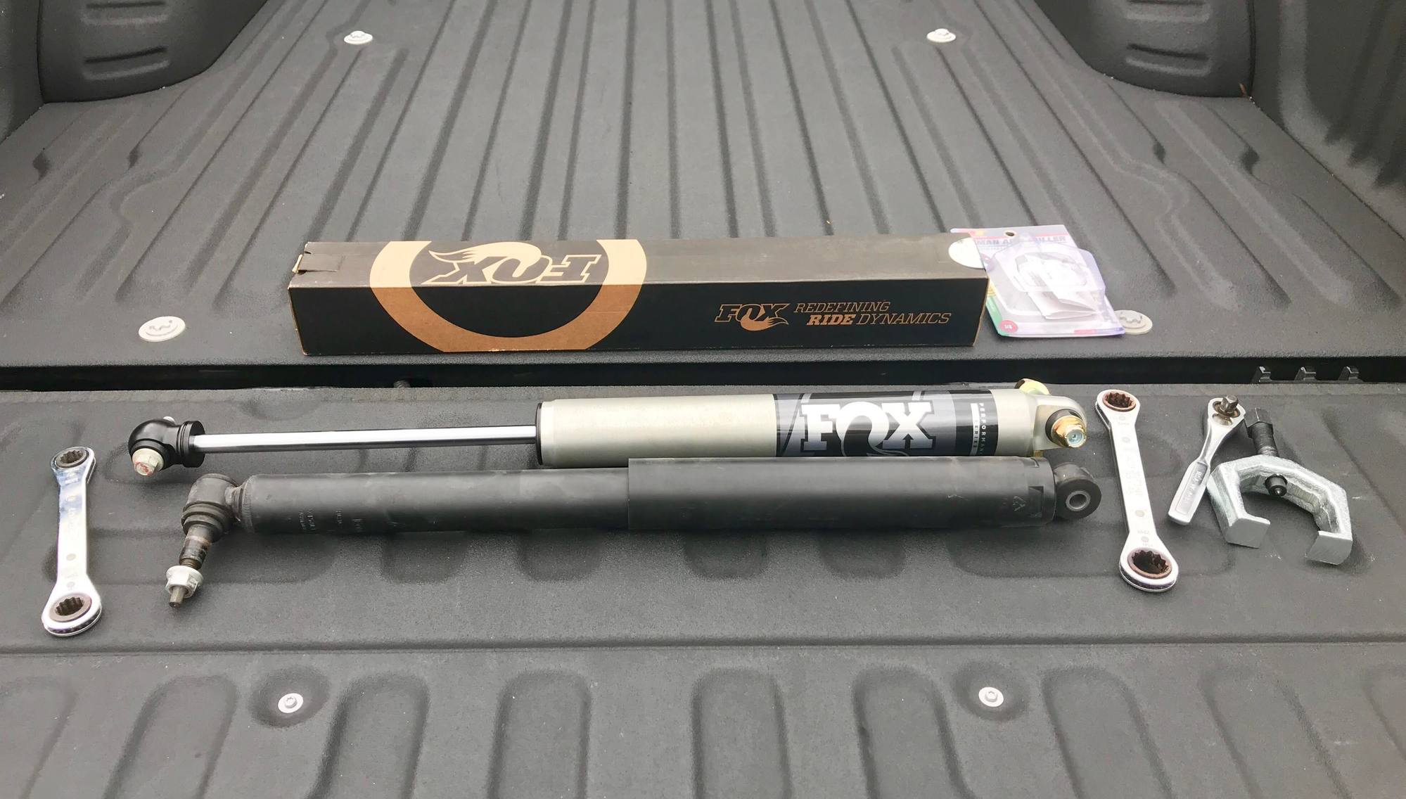

Originally Posted by TCNashville
My '17 has 22K and the steering still seems quite tight. I don't have any wobble hitting expansion joints, pot holes or anything. I do have the occasional wheel hop when hitting an across the road bump in a curve but I think that's pretty normal for a solid front axle vehicle. My question is since the steering stabilizer is part of the equation of DW, would it be prudent for me to replace that part now before it's potential failure lets the rest of the front end components wear out prematurely thus mitigating DW? What would be the best steering stabilizer to replace the factory one with and is it a difficult install? My truck is under warranty for another 7 months. Paranoia strikes deep.
TC: This is what I put on my 17. A puller makes it easier too. Made a noticeable difference...and I agree with replacing it before it becomes a problem.
CB, would you happen to have a part # for that Fox stabilizer? The Fox # I'm coming up with is 985-24-001?. Been trying to research this situation and it gets very confusing on what will fit and not fit. Also is that a Pitman arm puller? I need to research how that tool functions with regards to the Pitman arm which I just found out what that is as well. I'm very mechanically inclined and do all my own vehicle maintenance but my front suspension knowledge is limited at best. YouTube will be my friend I think. Thx
