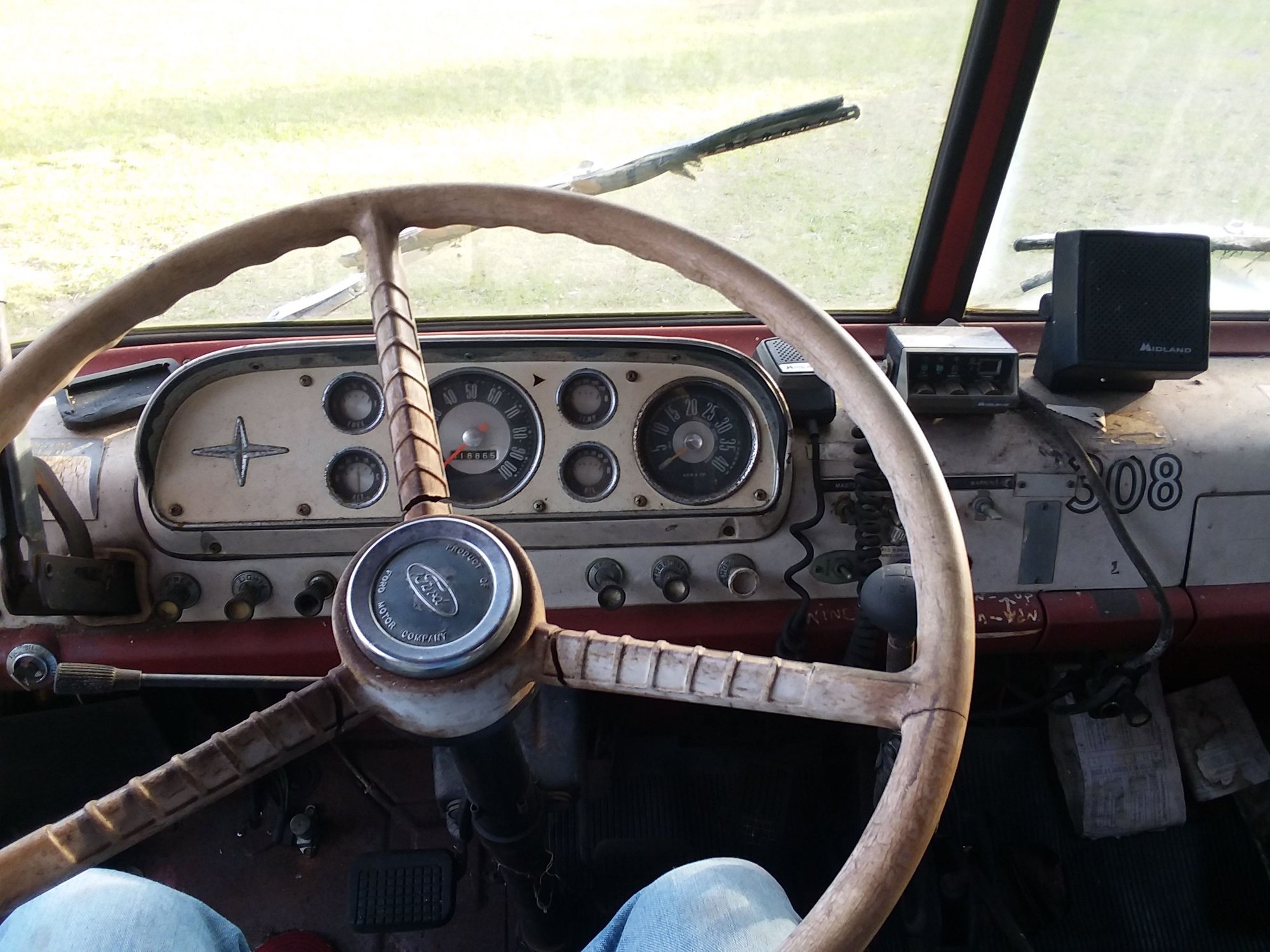

Hey everybody, I am in need of some help looking for all the weather stripping for my 66c850 I've had some from Number dummy on my vin. I would think somewhere out there I could get them seeing how they made the truck for 33 years. Any help would greatly be apreciated thanks.
