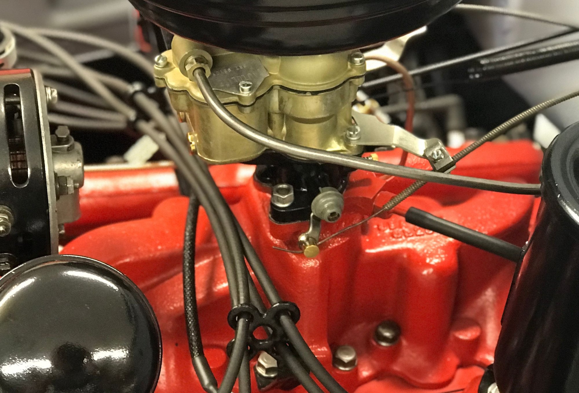

I have rebuilt several carbs over the last few years, the last one being the EAB v8 carb in our 52 build. It is the best running of any I have rebuilt, maybe a testament to practice makes perfect. I used a 94 kit from Daytona, the power valve and power valve gasket is from Charlie NY, and the jet plug gaskets from an EBay seller in FL. I soaked in Berryman, then an ultrasonic cleaner of pinesol, and the carb base in evaporust. Lots of small pipe brushes and compressed air. It’s rewarding and educational to rebuild them yourself so give it a try. Start with the best core you can find. If the outside throttle body parts are corroded, chances are so is the inside, making the check ball etc a real challenge to replace and clean.
