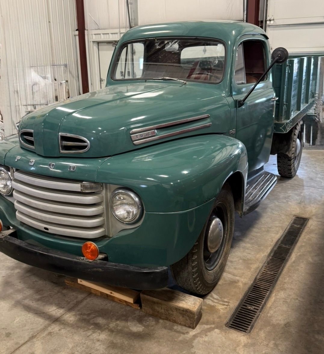

New owner 1950 F3
Originally Posted by Jafo56
Looks great......good progress on it.....just to let you know....round up 3 or 4 buddy's and lift the cab off...that's what I did...... not terribly heavy...... and meadow green is great looking....I just did this one......meadow green....
New owner of an F3 that looks almost identical. Couple questions. Well, several… Like to woodwork and want to refresh the flatbed. Having a hard time finding pics of an original bed. The current bed has no metal spacers. Thinking those were not original on F3 beds. Read where the metal frame was also same color as cab.
Learned all about oiling the fan bearing after the v8 flathead burned a belt when the bearing seized.
~49k miles on the original v8 flathead. Wondering what oil to run. All kinds of advice on non-detergent/detergent zinc, Rotella 15w40, 10w30 etc. Going to run mostly on the weekends to Menards in the Midwest summer.
Haven’t had a chance to drive it much yet, but it runs good. Want to change the oil in the 4 speed and diff and make sure the clutch is tuned. Assume 80/90w in those.

SS51, welcome to FTE the best Ford truck forum on the World wide Web! That's a good looking truck you have there. I like the color.
I have a '54 F100. I use 10w30. Some say we should use 10w40.
About your flatbed, it looks like your bed is an aftermarket bed. A Ford factory bed had the FORD script on the rear panel. The factory beds were painted body color. Aftermarket beds could have been painted any color.
BTW, this is an old thread. You should start a new thread with a good title, post more pictures of your truck and introduce yourself.

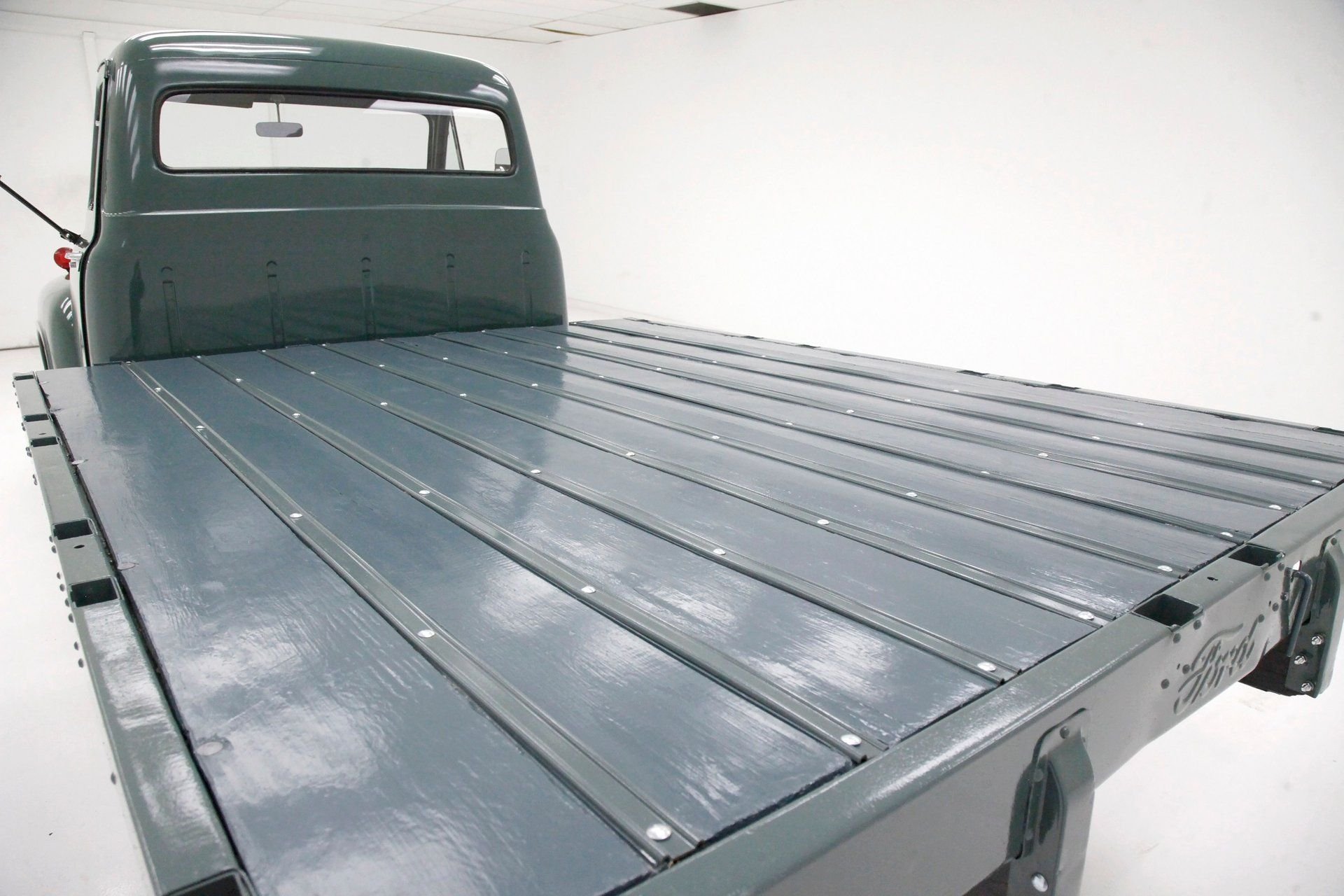

Here is the factory flatbed I put on my 55 F350 which I no longer have. The 48-52 beds were similar, if not identical.

more views of factory flatbed

Welcome to the forum! Good looking truck. I had to chuckle when you said you've been getting all kinds of different and conflicting advice. I'll say just because some of the most knowledgeable people on the planet for these trucks are here on this forum, it's quite likely your experience here won't be much different.
If you have an aftermarket bed, it's quite likely it was built with tongue and groove boards instead of planks and rub strips like the factory option, and if so, I wouldn't mess with it or worry about it or change anything. Just roll with it and enjoy it. From this angle it looks great. If the wood needs conditioning, you can prep it and refinish it with your choice of top coat; paint, varnish, oil, etc.
