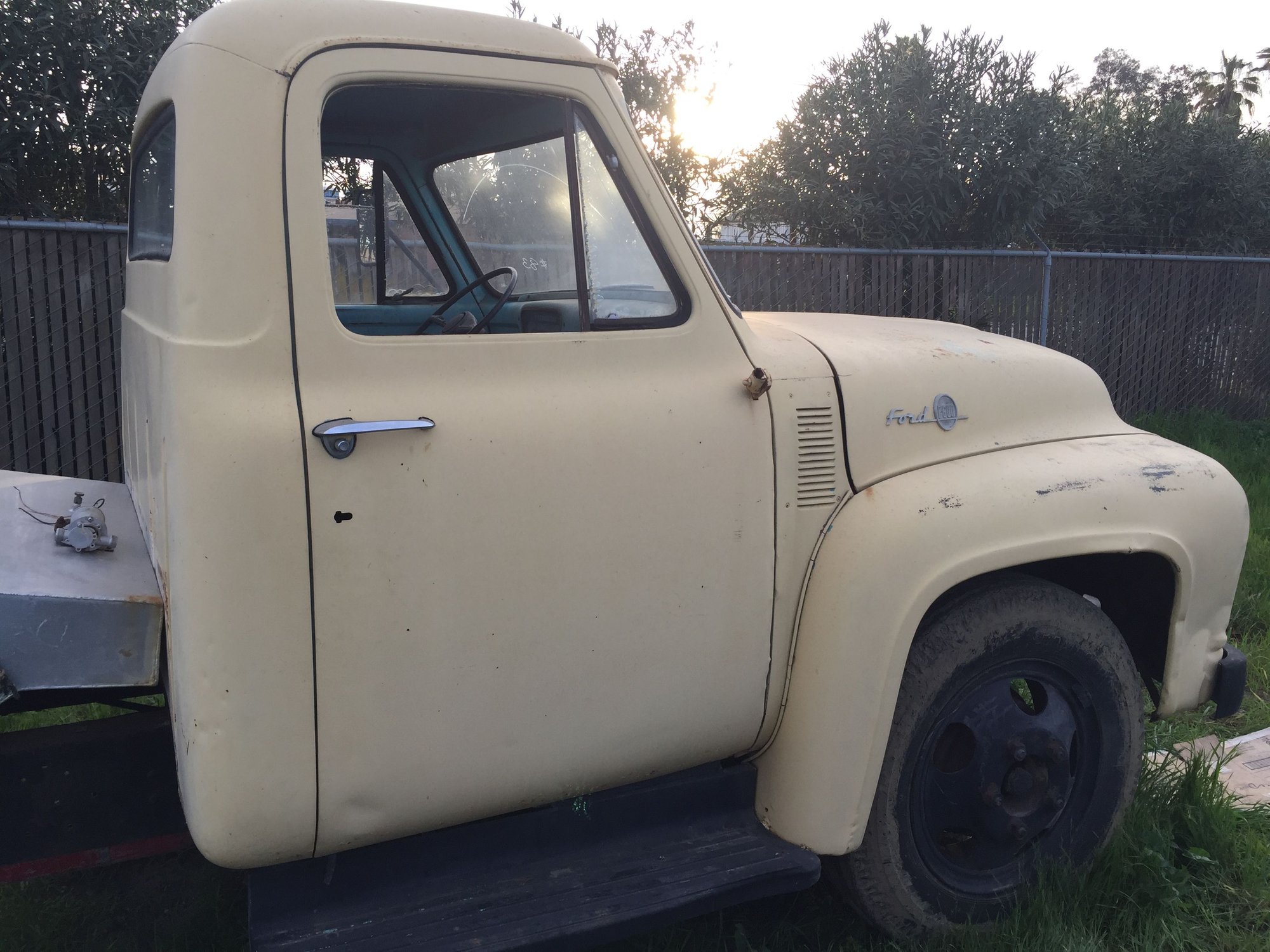

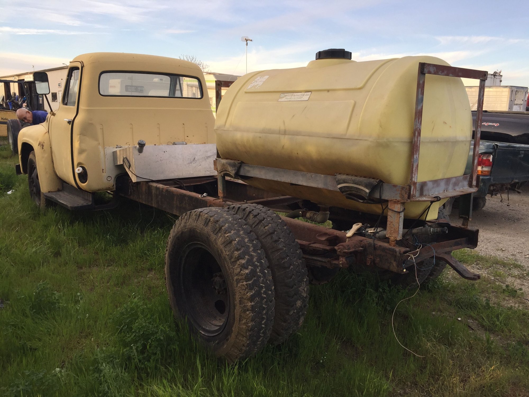

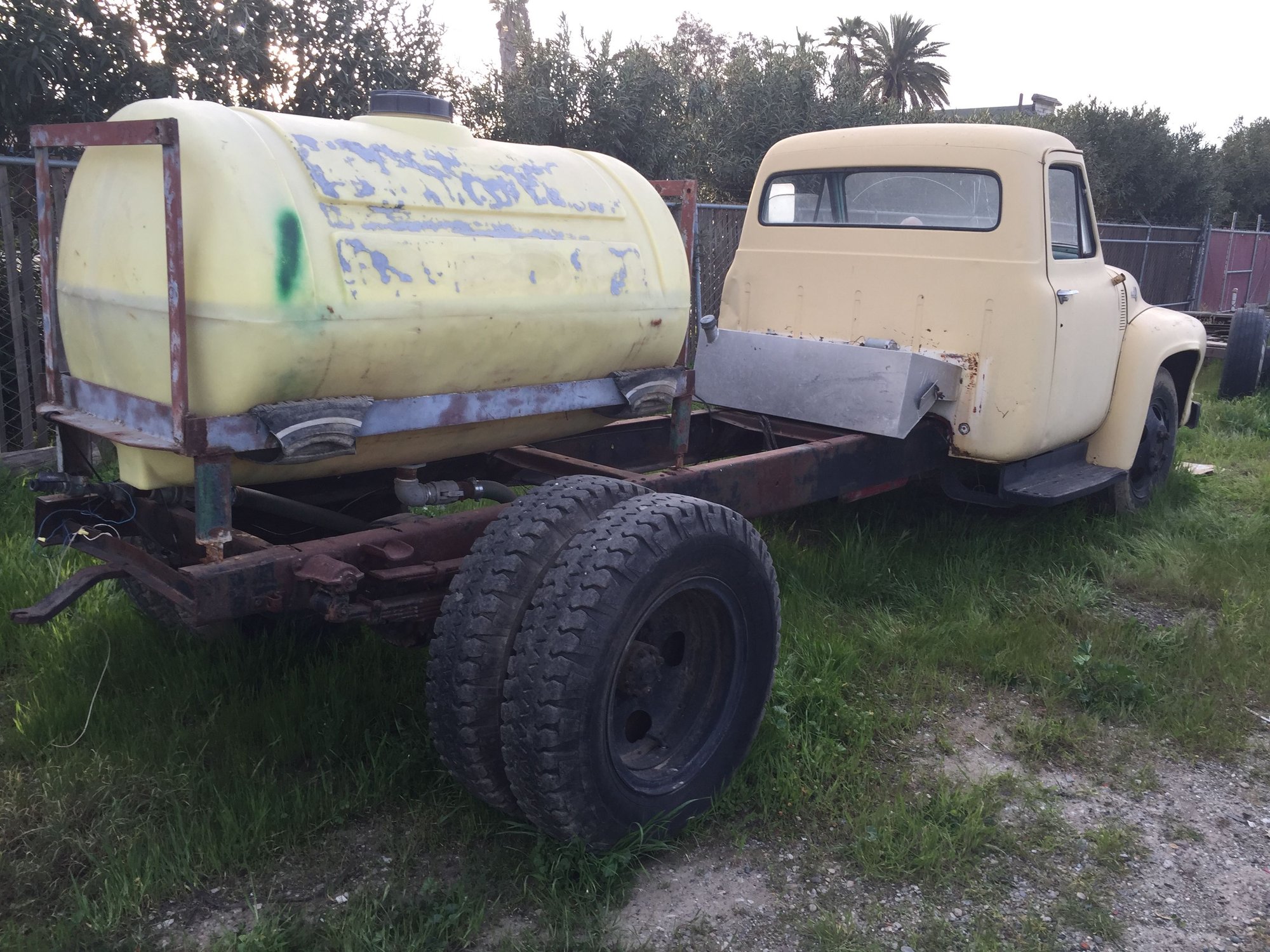

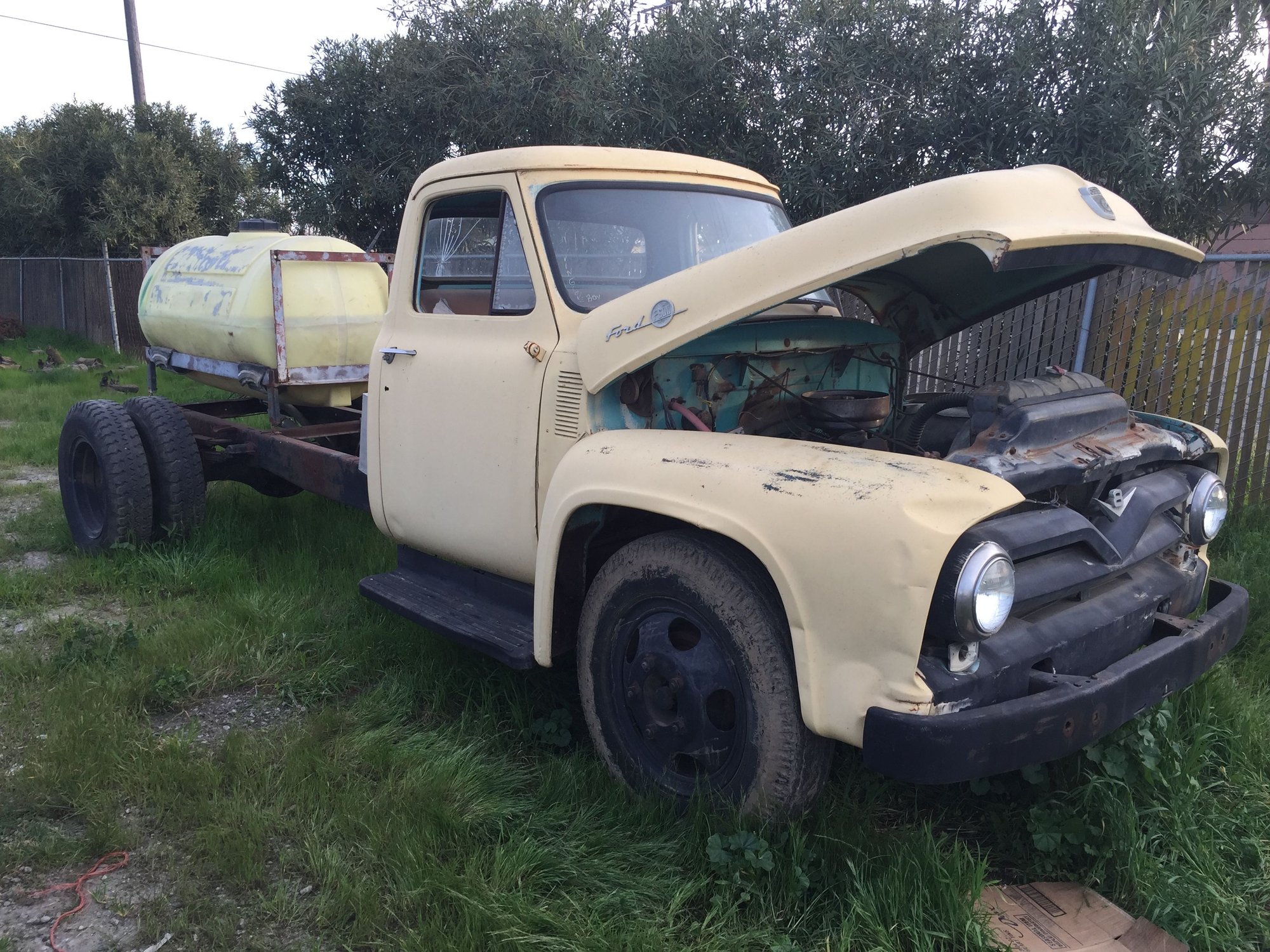

I just bought a 55 f600 thats very close to original. This is my second project truck, my first was a 55 chevy 1/2 ton. This new truck has some paperwork saying it is a 57, but the cab is 53-55. I probably wont be able to register it because of the messed up papers but thats not really a concern.
Its pretty rust free, I want to move the rear axle forward to either shortbed or longbed length so I have the option of mounting and old bed from a f100-f300 and then cut off the excess frame. I'll also remove a few leafs to drop it a little and make it softer.
Does anyone know if this body style did get used for the larger trucks in 1957?

that is a1955 identified by the grill. It is not a 57

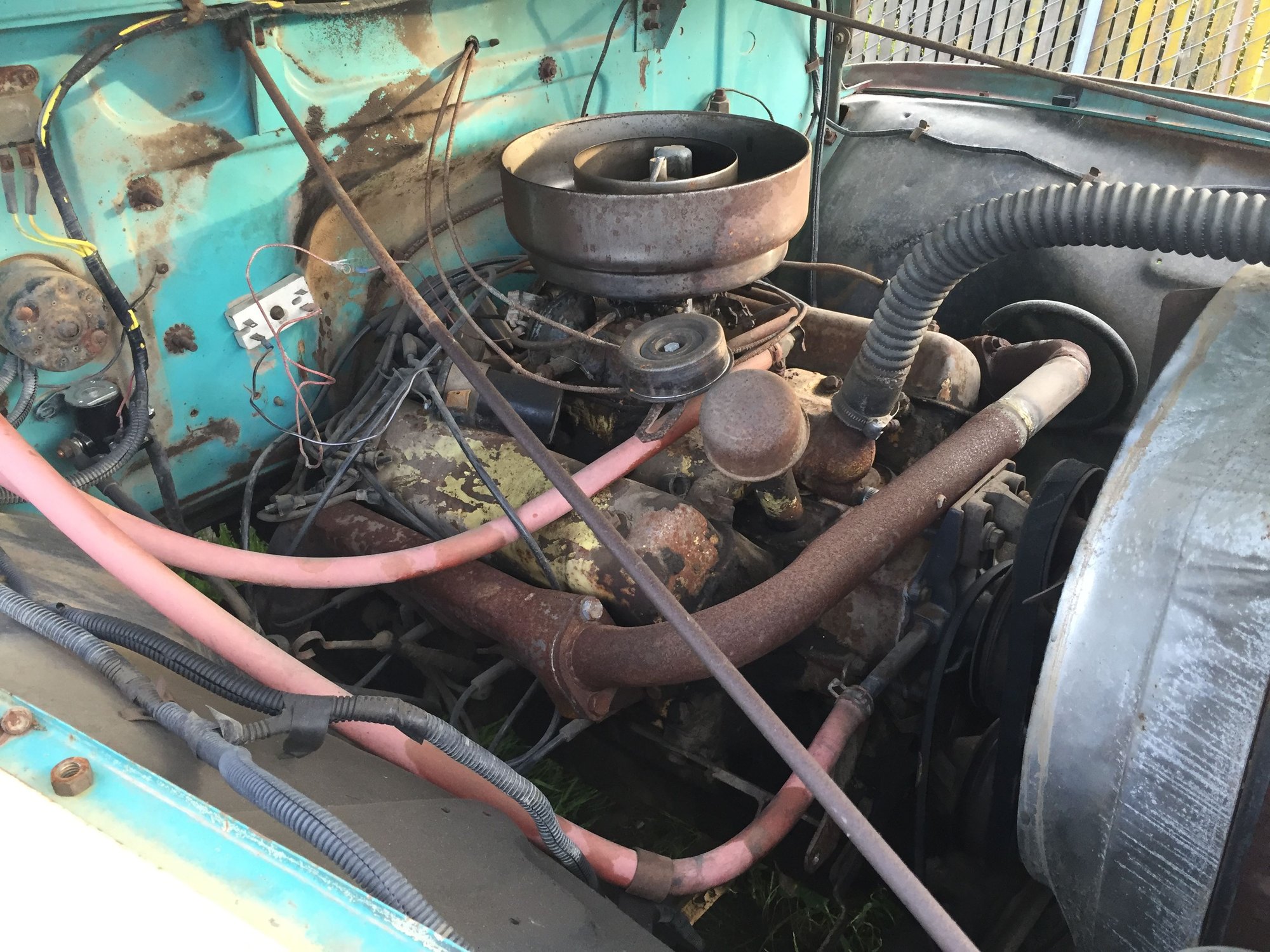

Nice looking truck. Yep it's a 55 for sure. It looks like it has the 239 Y-block in it. Unless it is a larger Lincoln Y. (High fan mount water pump indicates a 239)
Originally Sea Sprite Green. That the color of mine. Good to see that.

How about the engine, does anyone know what it is? I'm guessing its a Lincoln y-block???

I'll look at 239 y-blocks too, nice to know the fan mount is something I should be looking at to help ID this engine.

Looks like a 239 Ford Y block to me. Beware of the wheels, they look like "widowmakers".

Yes they are. Before getting real busy on it I'd suggest a Google search to study up on "Firestone RH-5°" rims. Also called "widow maker" two piece rims. Add my welcome. Stu

I learned from my 55 chevy to take my time. theres a lot i wish i had done differently. I am aware of the widowmakers and dont plan on touching them myself or replacing them. hopefully I can find someone to fix the one flat tire that it has.
Does anyone think that could be a 256 y-block?

4th digit of the VIN is the engine code: V = 239; Z = 256.
279/317 Lincoln derived Y blocks not available in 1953/55 F100/600's.

The vin plate that is screwed into the glove box is f60z5r so it should be a 256 if that vin actually belongs to this truck. I'll have to go look at the casting numbers sometime. But is there a way to visually identify just from the pics I posted?

.............plus the yellow paint makes in a 239!!!!!!!

The VIN on the Rating Plate that is screwed into the glove box is F60Z5R so it should be a 256 if that VIN actually belongs to this truck.
F60 = F600.
Z = 256 2V
5 = 1955.
R = Richmond CA Assembly Plant.

No one in their right mind will work on those wheels.
Of course, you are near or in Fresno....
There are a bunch of threads on replacing them. Since you are 5 lug it's going to be a challenge.
Don't even try to air that tire up unless you have it in a cage.
