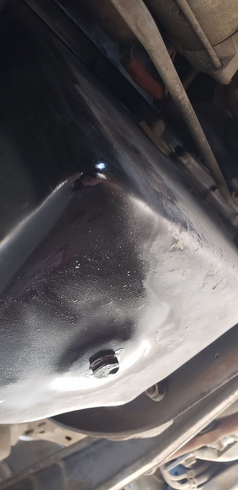

I have noticed I have some small leaks. First place is the oil drain plug. I have done 4 oil changes and not once changed the drain plug and gasket. This is probably my biggest leak out of the two. The drain plug has oil puddled on it. Common sense probably says the gasket is worn. I just changed my oil about 800-1000 miles ago. Is it ok to drain and reuse the oil or would that be a no no?

I had a leak at my drain plug from the very beginning. I got one of those cheap blue oil plug gaskets from the cheap parts store, 400,000 miles ago. Same gasket! Best $.50 I ever spent!
Yea I was just going to purchase a whole new plug + gasket. They are cheap. Good to know.

Old Jan 10, 2019 | 05:00 PM
L-ight's Avatar
L-ight
Joined: Mar 2017
Posts: 571
Likes: 12
Here are the pictures.....So it looks like it's dripping from the drain hole and it's puddling on the starter too.
If it's coming down from the drain hole on top there are lots of possibilities.
There are three "pockets" in the valley: forward, middle, and rear. Whatever the forward-most pocket that has fresh oil in it is probably where your culprit is (the engine is tipped slightly down going from front to rear...probably why they put the drain hole in the back ). It's not a complete list but some things to look at:
Forward - High Pressure Oil system (pump, lines, fittings), Injection Pressure Regulator (IPR), and Injection Control Pressure (ICP) sensor.
Middle - oil fittings/plugs
Rear - Turbo, pedestal, Exhaust Backpressure Valve
As for the wet starter area the only things I can think of are the dipstick tube flange into the oil pan and the oil pan gasket.
