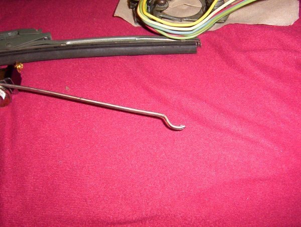

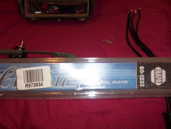

Need help before the rains arrive...
I ordered this set of (Windshield Wiper Blade 1953 - 60, P/N B2T-17528-A), from DC but for the life of me could not figure out how to mount them on the arm itself. Upon further research with DC I was informed that I needed this instead (Wiper Blade 11" Original Design 1953 - 60, P/N 8A-17528) Yet I STILL CAN NOT figure out how in the world these "eFing" things go together! Pardon my french...
It's supposed to rain this weekend (soon) and I would like to wash my truck with it's newly installed windshield wipers and park it back in the garage before it gets too wet. LOL
I know it's got to be very simple but this idiot here is not able to figure the puzzle.
Also looking to diminish or stop the front disk brake dust as it turns my white walls black! Sigh...
Disregard the cylinder looking thingy please.

The wipers you reference from DC both look like they are for the "hooked" wiper arm. Your wiper arm is straight. The B2T-17528-A will work, but you need the adapter clip. It should have come with the blade.

EffieTrucker
This is exactly the setup I have!
In the 2nd picture, how "do you make them click" together

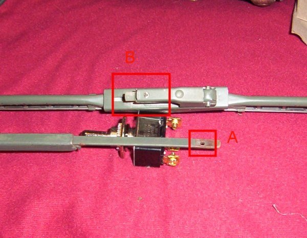

Originally Posted by ImSoQuazy
EffieTrucker
The adapter just hooks under the pins on either side of the blade.
The wiper arm either has a pin sticking out of the top, or a hole. (at box A) I think most of the old Fords had the pin, this is a modified Kaiser arm with the hole.
The adapter should have a hole on top that the pin locks into. (at box B) If the arm has a hole, there is a catch on the locking lever that locks into it from the bottom.

Here is what I got going on...
You are right! My arm has the "nipple" popping up not the hole.
I can manage to make it fit in the whatever, but how do I make the whatever click to thingymajiggy?
nodding my head in disapproval...

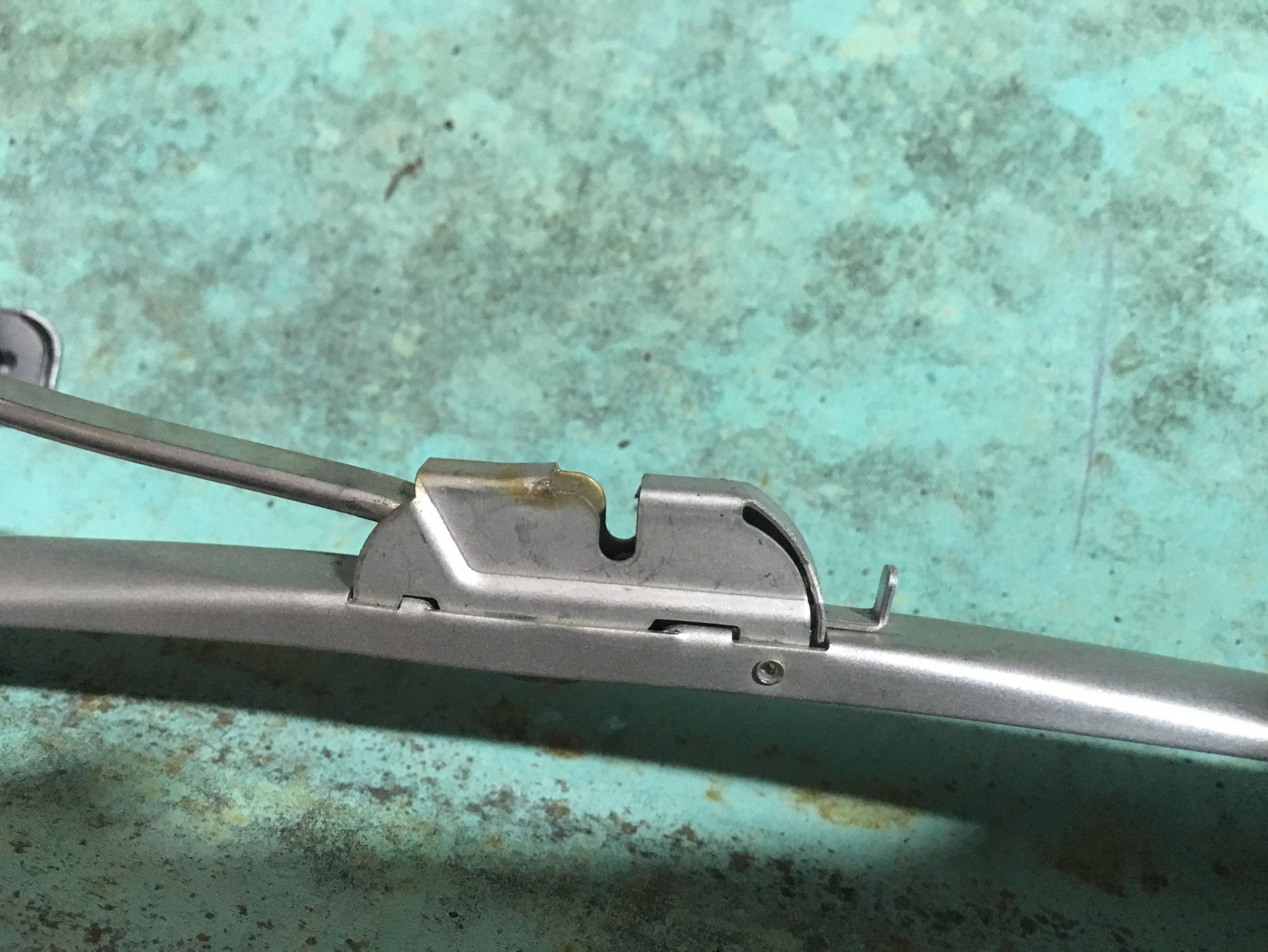

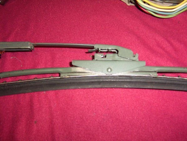

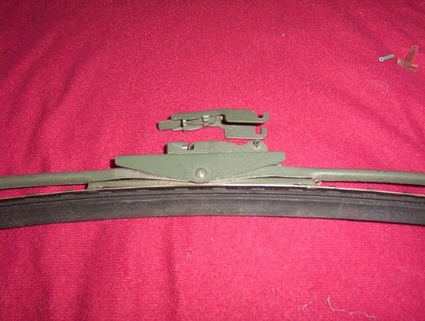

Oh, I think I see what you mean,
They don't "click" into place. If the arm is locking into the adapter, and the adapter is hooked onto the blade, that's it. I know it seems kind of cheesy, but that's the way the universal blades work.
Your arm/blade on the bottom, as you have it, is ready to go.
These are "universal" blades. The extra notch with the spring latch is for another kind of arm.
The blades on the bottom, that they say are correct, are for the "dipped" end arm. If you had the dipped arms you can still use the universal blades, but without the adapter.
Dipped arm:
Straight arm with adapter, ready to go:
