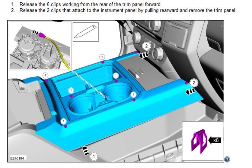

How do you remove the console cover on a 2019 Super Duty? I can't find any screws or clips holding it on. I'm referring about the piece that goes from the arm rest to the dash.

The videos I've seen the entire piece comes out as one unit.

Its just snapped in. Open the storage lid and work from there forward pulling it up.

Thanks for the help Old Duck and h20camper. I figured it would be something easy like that. With everything being plastic I didn't want to just start yanking and break something. Once I saw the diagram Old Duck posted, I popped it right off.
