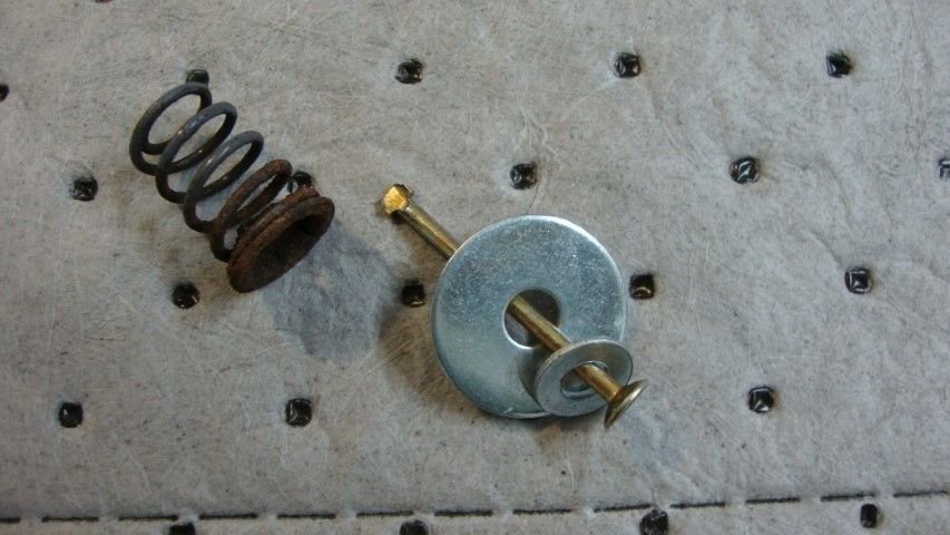

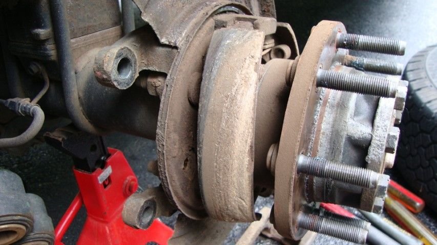

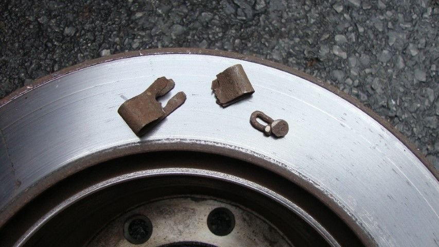

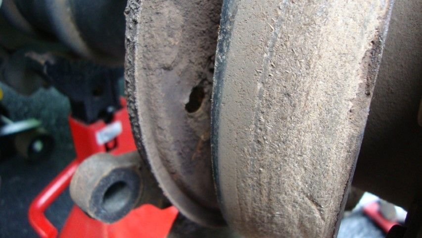

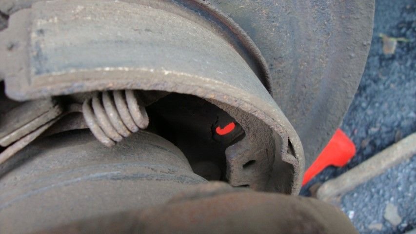

This made the sound your describing. Can't edit and add pics to the last post sooo Ill post another reply with pics of the mess...This is the notorious rotted rear brake backer plates and my temporary fix. This is at ~55K miles. The new springs, pins, pin retainers are out of a drum brake hardware kit. Once it's installed I pack the outside of cavity where the washers now live with grease. Two of the fender washers need to be shaved to fit flush against the backer. I'll be going in for pinion bearings soon so the new backer plates will get nickel plated and replaced using the old style retainers...Older IS better.
