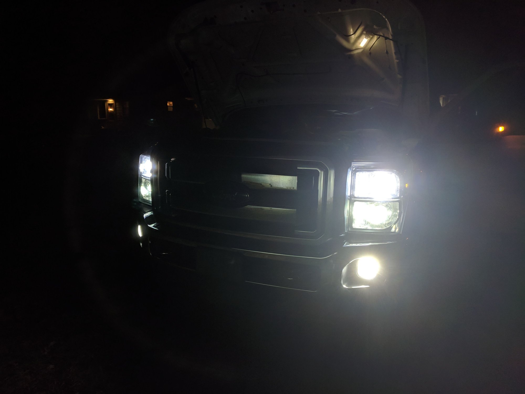

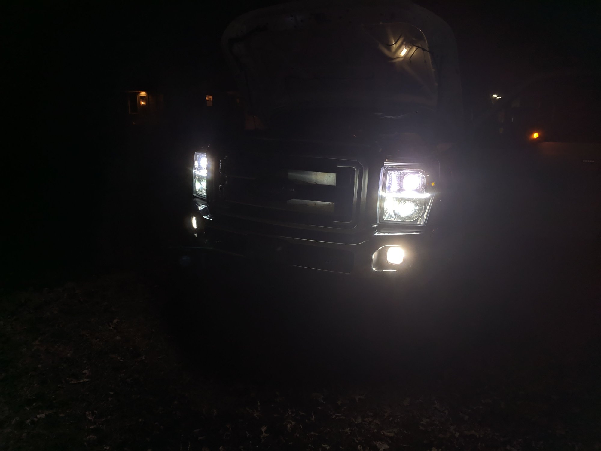

I just wanted to share some pics of my projector retrofit I just completed on my F250. I pulled apart everything on my own and retrofitted mini H1 projectors in the bottom low beam slot then put in "high beam" only profile hi-lens led's in the top. Since I got rid of my stock turn signal bulb and slot I installed a switchback led strip in the center of the housing. I love the look and the light output is great!
Low beams with DRLs
High Beams
DRLs
DRLs

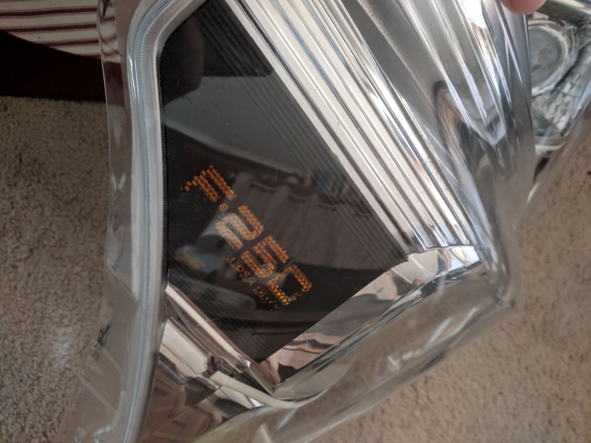

Stenciled the sidemarker lamp and sprayed the amber lens

Nice. Those look awesome! How much trouble did you have opening up the lenses initially?
Old Jan 3, 2019 | 11:50 AM
dkeyt7's Avatar
dkeyt7
Joined: Dec 2018
Posts: 10
270 for 7 minutes does the trick to get them open. The hardest part is getting all the permaseal out. I had to re bake to get it soft enough to remove everything
