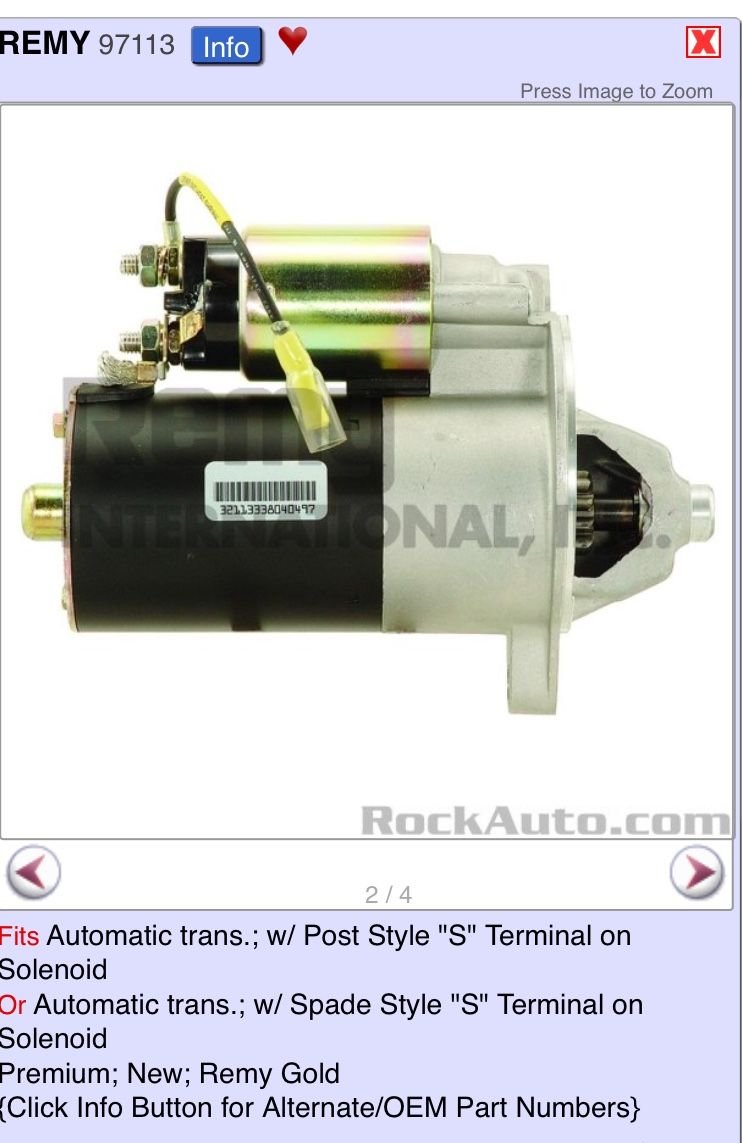

Would this work? Not the only one listed with both terminals
Spade or post terminal

I guess I'm used to using terms for house wiring haha, replace "hot" with "red" and "neutral" with "black."
OK wiring colors mean nothing. There is no ground wire to the starter, it is grounded by being bolted to the block.
If you have 2 wires going to your starter, then the big one is the 12V from the battery. The little one is from the starter solenoid, it goes hot when you turn the key to start and tells the starter to engage.
For the little one, if you have a spade terminal or a post terminal, it doesn't make any difference. Just put on the correct crimp connector to match the starter connection and off you go.
