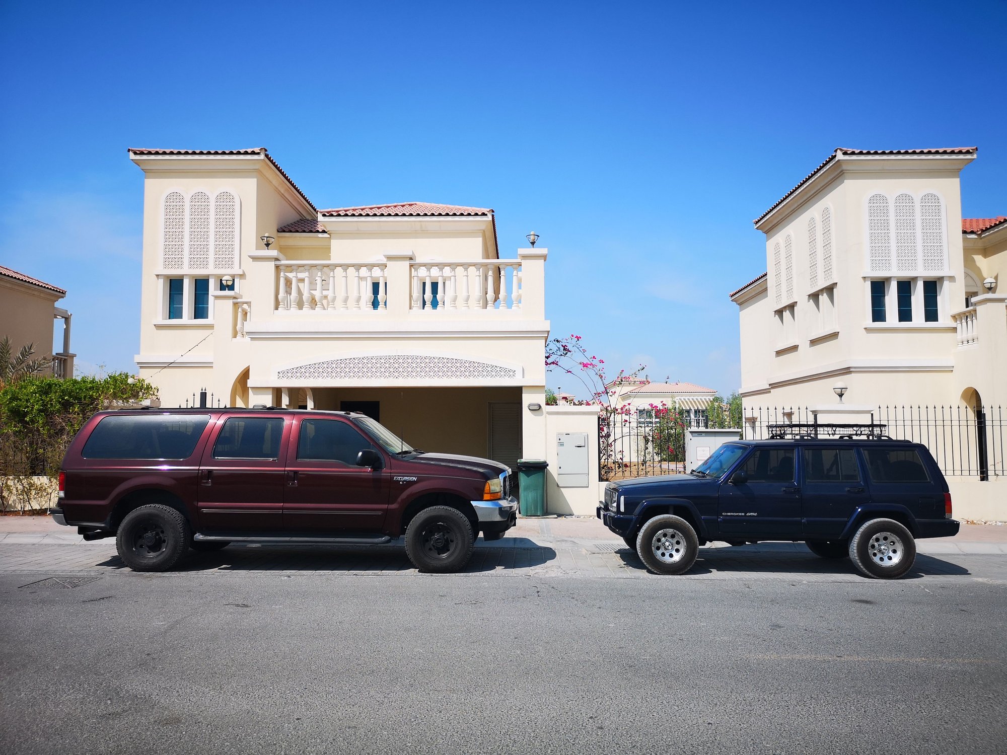

Hi FTE, I'm new to the forum - here's my 2000 XLT. I'm restoring it in Dubai, 1 of only 3 currently in the country. Looking for a few interior plastic parts if anyone can link me up with a seller? Thanks in advance

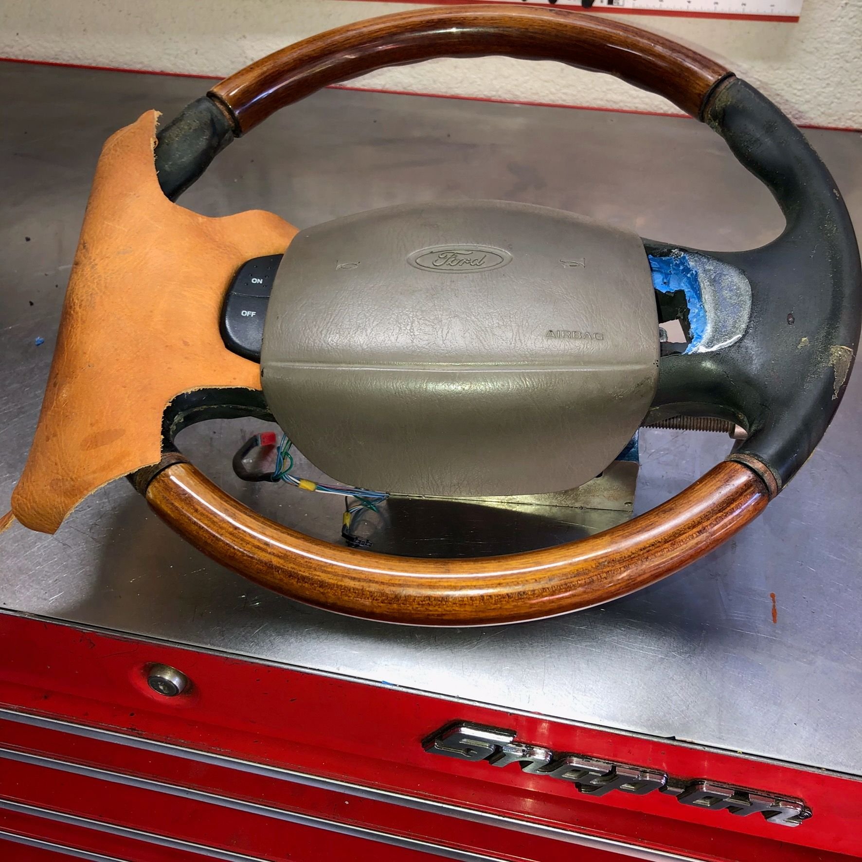

Front door panels are easy because they are the same as the F250 truck, rear door are larger and unique to the Ex so they are in short supply but can be found. Steering wheels are easy and new ones still available from the dealer as well as plentiful in wrecking yards and the used market.
the wood grain one is a bit harder to come by but that isn’t the issue, The Cruise and radio control system on the Woods is diffrent then the Ex and you either need to figure out how to adapt the wiring or convert to the Excursion button pods.
I remake steering wheels as a hobby starting with whole cow hides, hand dying the leather, making the patterns and hand stitching the leather, you can see on this woody how I epoxied the new location for the Excursions button pods.

pirate4x4_camo if only we had craftsmanship like that here. Certain standards are pretty low in the UAE but remains expensive so my only option I guess is to purchase a new oem steering wheel online from the United States. I found one on ebay (the link is in my above post) is USD425.70 the approximate market price for a new oem wheel with no horn cover?
