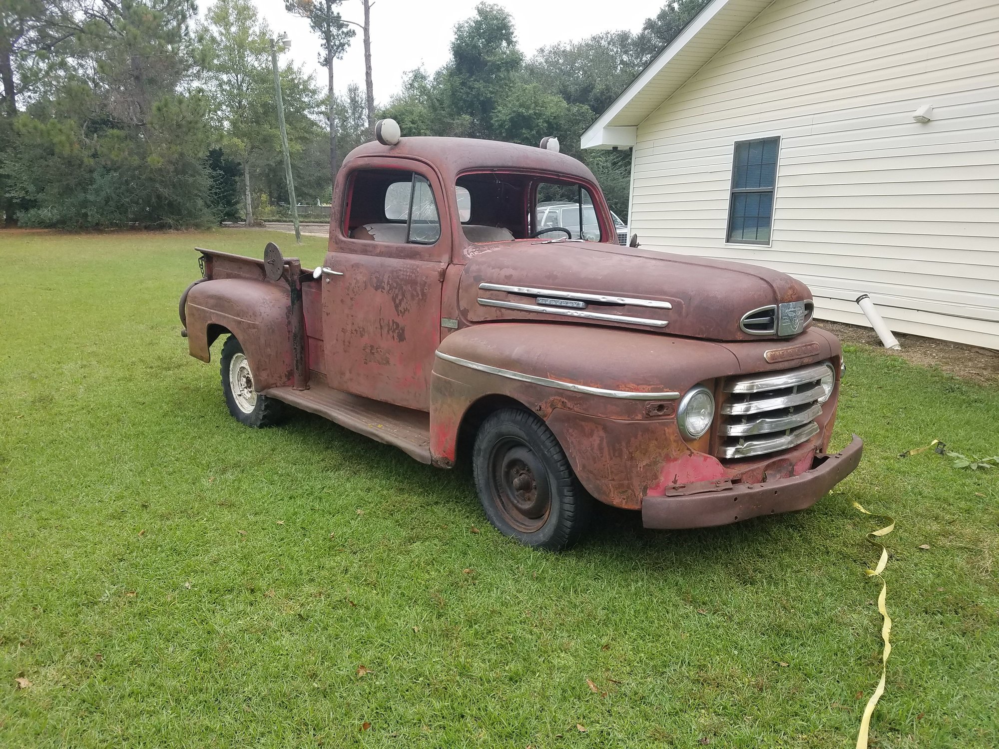

Hopefully the upload will work
1949 m47 original. I have recently got all glass shipped in, and starting parts.

Okay, i think i figured out how to upload!

Looks like a nice solid truck to start with. Welcome to this forum. Please keep us up to date and we like pictures.

in the picture you can see there isnt an oil filter canister on the drivers side. That is what baffles me.

Yeah, the canister is missing. I can only guess that someone removed it.
