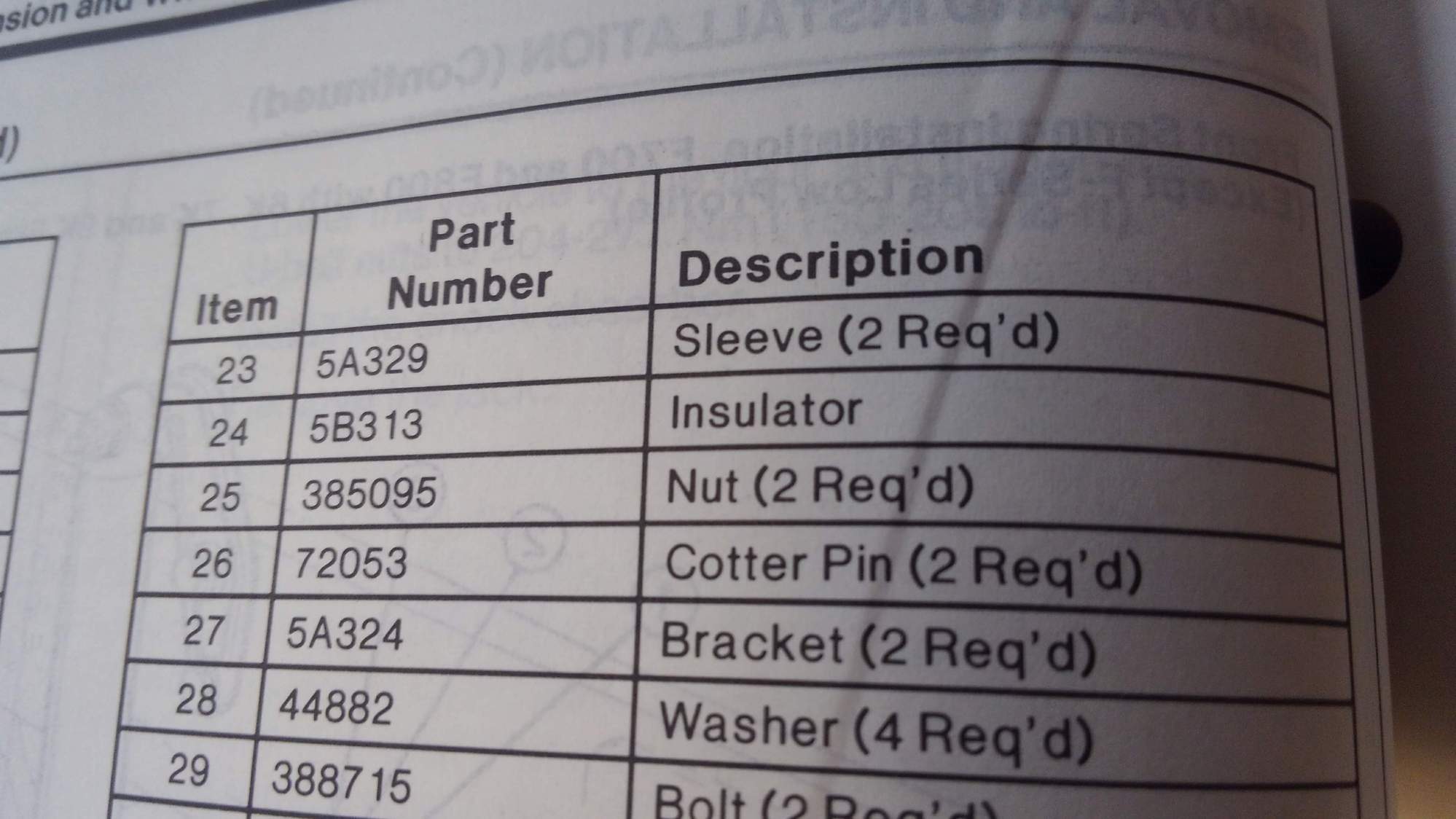

Looking for a replacement spring 'Insulator', Ford part# 5B313 (according to official Ford service manual).
This part (or insulator) rides on top of the front leaf spring, towards the rear, where it makes contact with the leaf spring bracket. My truck is missing one on the passenger side. I appreciate any help in sourcing one. Thanks!

This is not the part number, it's the basic part number. Basic numbers do not have a prefix and suffix added to them that give the complete part number.
The other problem is, 5B313 is an invalid basic part number. There's no parts catalog picture or listing for it.

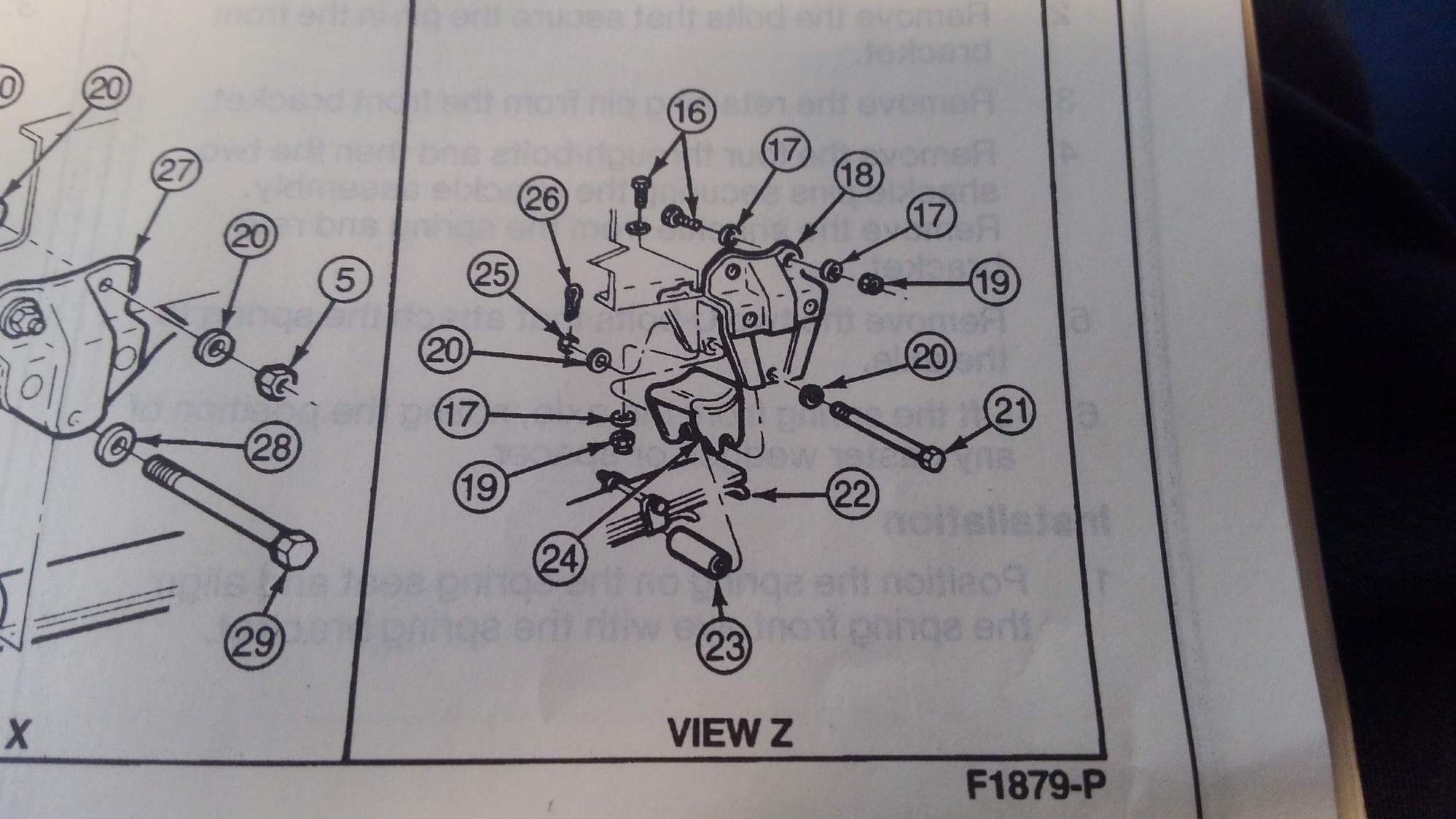

Thank you for taking the time to look into this for me, I appreciate it. The part I am looking for is the 5B313 or Item 24 in the following diagram. It appears to be closest to the 5A342 in the diagram you posted. It also appears that I will need 1 each of item 20, 21 & 23, the sleeve, bolt and nut.

There's no part number of 5B313
Comparing the pic you posted with the parts catalog pic (click on it twice to enlarge it), 24 is 5A342 = Front Spring Bracket Insulator Assy.
There are two part numbers, the insulator only (Edit: F5HZ-5A342-AA [replaced E6HZ-5A342-A]) - fits inside the assembly) and the insulator assembly (E6HZ-5A342-B) itself.
Edit: 1980/99 B/F/FT/LN600/900.
See 5A342 in pic:
