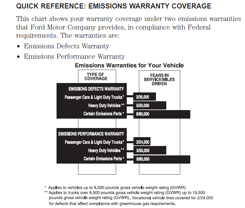

It's important to note Ford's ESP Premium Care plan is not bumper to bumper. There are many expensive parts not covered, such as the DPF or EGR cooler. However, it does cover the "DEF system" excluding the catalyst (I guess that's the DOC?) so it looks like you're in good shape to avoid this $850 repair out of pocket.
The DEF heater is not covered by the diesel powertrain warranty and emissions warranty on these trucks is valid for 5 yrs from date of sale or 50,000 miles. When did you buy your truck? If you get it in under the factory emissions warranty in time then at least you avoid the ESP deductible.

Bought new in July 2015 and has 41k miles on it so it's within the emissions warranty window. I thought I had heard/read somewhere that the DPF was covered til 80k miles ??
Some states make them cover it longer. California comes to mind...

Just a quick update. Got the truck back Wednesday eve. They replaced the DEF tank heater. It was covered under emissions warranty. No money out of pocket. Everything seems back to normal, no check engine light, no codes, and power is back to normal levels.

Thank you for posting this. I had the same thing happen and just got off the phone with my local dealer and it is covered under the Customer Satisfaction Program. One thing the dealer did tell me was to be sure not to reset the code when you bring it in, because the code has to be active in order for it to be covered.
