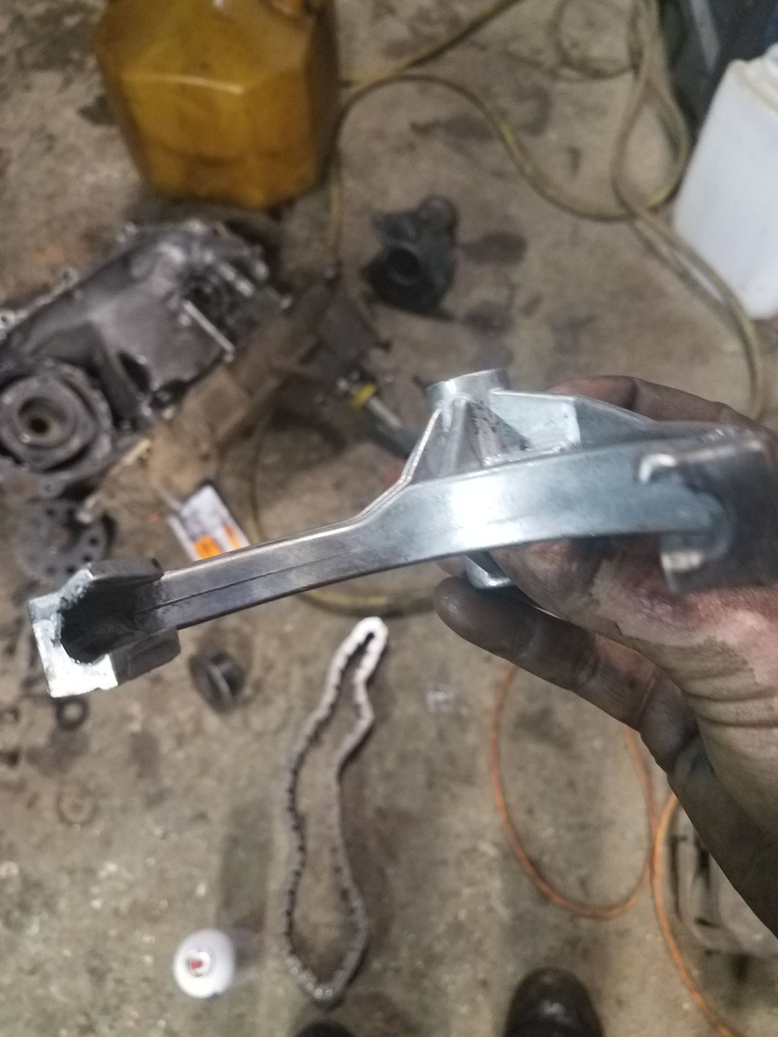

This is a unique case of bad luck. I not too long ago switched my truck from 2wd to 4x4, and I used an older Transfer case when I did. BW 1356, with about 400,000 miles on it when it finally puked up it's guts and the pump nuked it. So, I then replaced it with another junk yard BW 1356 out of an 1988 F350, that they say, looked clean and had no issues they knew of. Run and drove they said... Well 2wd never felt very engaging, like it was slacked and stuck in 4x4... So, I just heard it give out, and decided to do an autopsy to see what went wrong. The final diagnosis: When it was pulled from the truck at the junk yard, they forgot to disconnect the links and pulled her out the fun way, this broke the mode select fork and caused some awesomeness.

The multitude of evidence. Direction the mode fork was broken. Slack in the shift lever, mis alignment due to it being all roughed up. You can beat on these parts pretty hard. But ultimately steel links are much stronger than the aluminum mode fork. The evidence and the fact the t case sat on a shelf for a year, with chunks of the level and shift assembly coming out the drain hole. It was pulled the fun way, these links are not fun without the proper tool. Do I know for sure? No... but I know what happened. It is enough to convince me.
