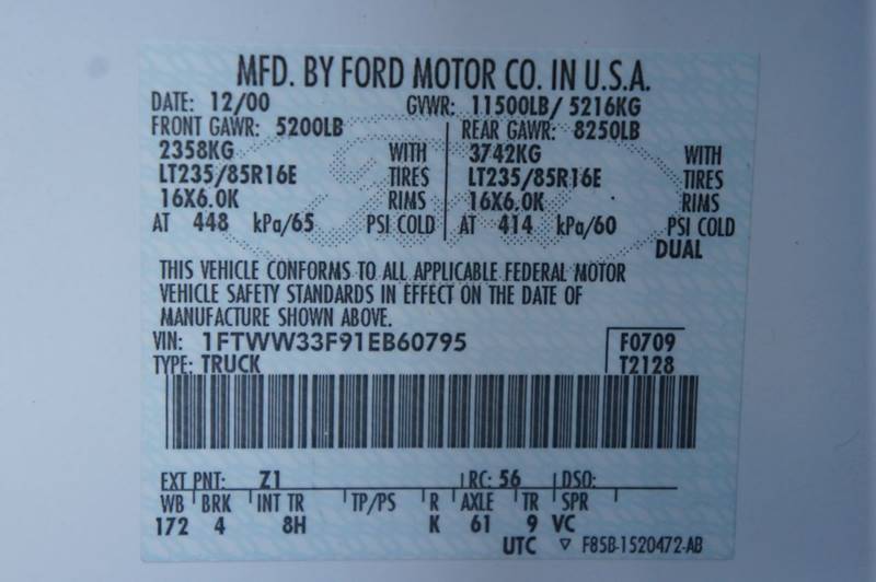

Thank you guys so much. I don't know if I'll be able to get the engine serial number from this seller. Like I said, it is a 2001 model - but was hatched in Dec./2000. I can shoot him an email, and see. Reading up on here the past few weeks, the forged rod thing really made since to me for a diesel. I'm not planning to "hop it up" much, but would like to boost the torque up a bit, as I'll be doing some towing. I watched the Powerstroke Video where he shows some minor things you can do without going "internal" (which I would not want to do). Oh......I almost forgot - I traded emails with the local shop that is known to be the automotive diesel geniuses here. They very politely warned me about 6.0's. This is another reason I'm back looking at low mileage 7.3's.

More than likely, a truck produced in December 2000 will have powder metal rods. It my understanding that the use of forged rods was discontinued in the early part of October 2000. My 2001 truck had a production date of 10/9/2000 and came with forged rods. I don't remember the exact date, but it was right after that when the change took place. A sure way to verify forged rods is to remove an inspection plug above the oil pan rail and rotate the engine by hand until you can see the fasteners on one of the connecting rods. If they have bolts with nuts, you have forged rods, If they see a bolt head (no threads), then they are powder metal. While there can be exceptions, this usually holds true when going by production date.

As we have discussed, of course, a vehicle manufactured in Nov./Dec. of 2000 would be sold as a 2001 Model.
In my Truck hunt, I will ask for the engine serial number, but not that they crawl down underneath and look.

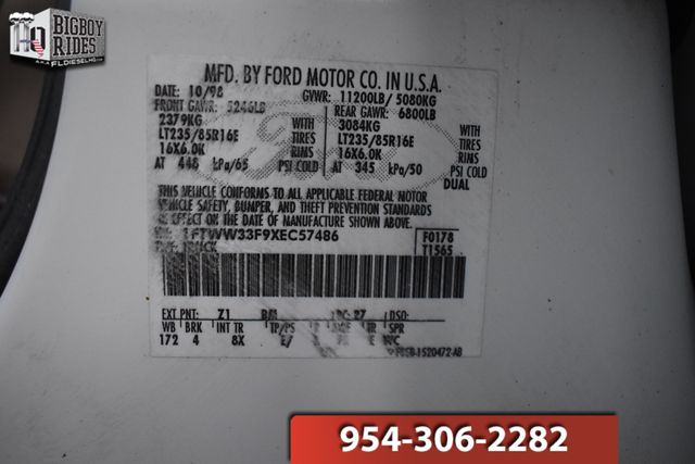

This is another nice low mileage 7.3 Truck I'm looking at - 1999 Model.
It was manufactured in Oct./98. So, it for certain would have the forged rods.
One other thing, though - this would be one of the "early 99's" instead of the "late 99's".
I know there were some differences. Anything to worry about with the Early '99's?

That's going to be 100% early but I don't see anything wrong with that if all else checks out.
