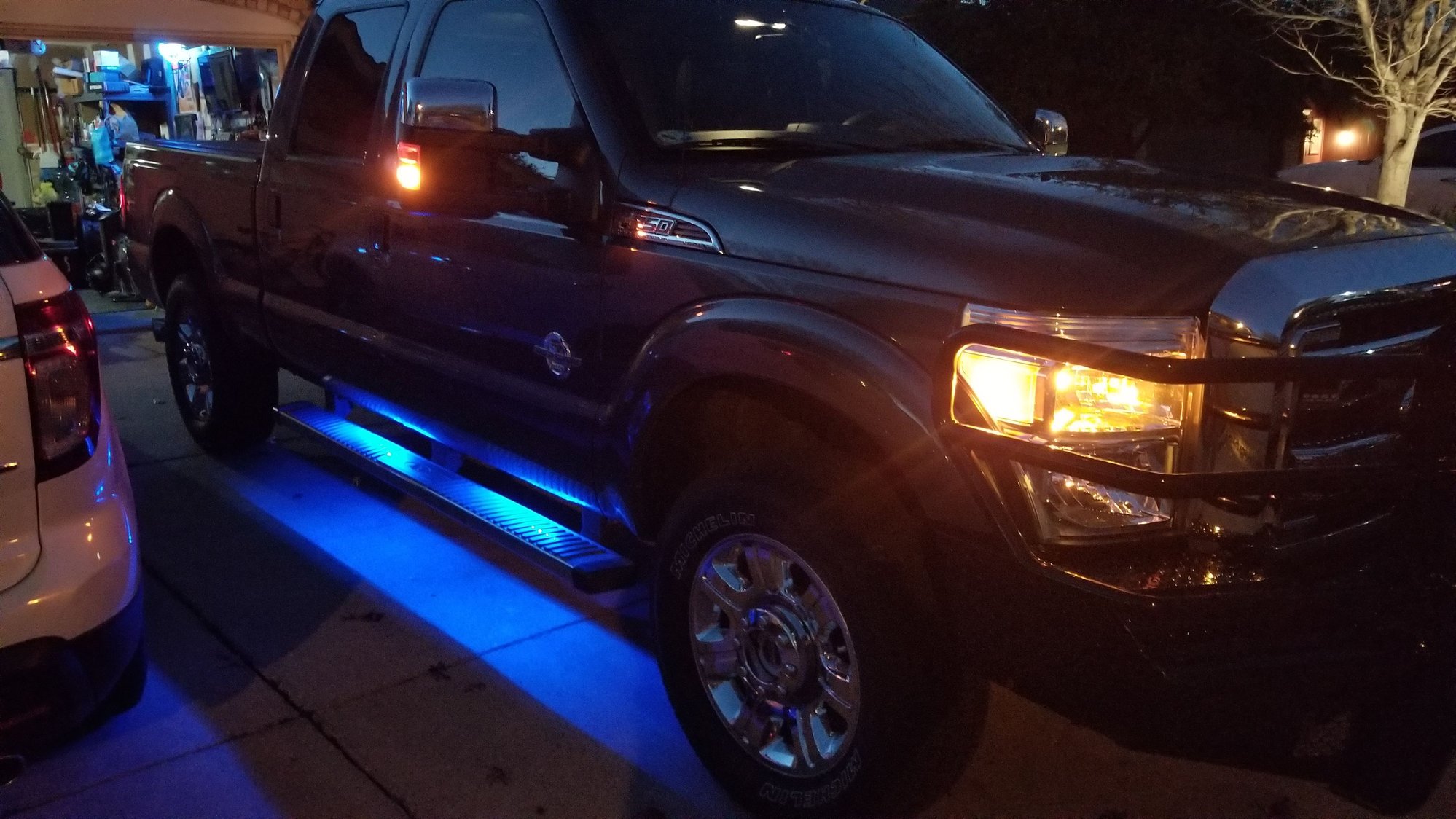

Found this on the Super Duty forum ( https://www.ford-trucks.com/forums/1...dle-lamps.html ) and added them this week. The plug is already there on some newer trucks just under rear doors on outside of the frame rail. Bought this pigtail thanks to CaptFX4,
Amazon Amazon
and some led strips on Amazon. They only come on when you unlock the doors.

Mine come on when you unlock or open the doors.

Which LED strips did you use from Amazon? I wired up some puddle lights earlier this year, but the stick-on LEDs from Amazon wouldn't stay attached so I eventually took them all off.
I used
https://www.amazon.com/gp/product/B017GR0LVC/ref=oh_aui_detailpage_o04_s00?ie=UTF8&psc=1 https://www.amazon.com/gp/product/B017GR0LVC/ref=oh_aui_detailpage_o04_s00?ie=UTF8&psc=1
(which aren't white), drilled small holes and put stainless steel sheet metal screws to hold them in, I did use 2 screws per light.

I am happy with lux lighting. They are expensive, have a magnetic base and work just as well as day I received. This time of year I really like that I can see and get a visual on ice and such. Highly recommend anyone thinking about it jump in.

Rocco I dig the blue, that looks nice

Thanks. I have them on my RV too. I like the blue.
