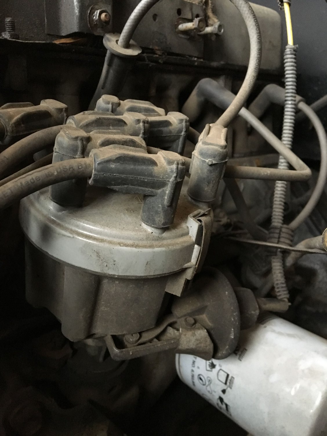

Has a single vacuum line.
84 Distributor.

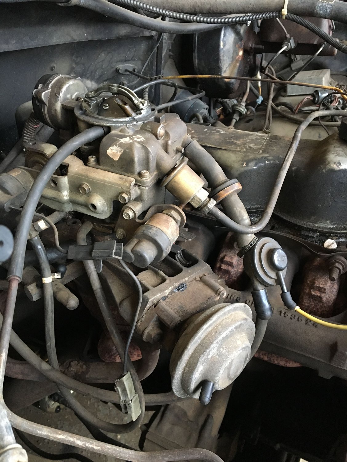

Carb.

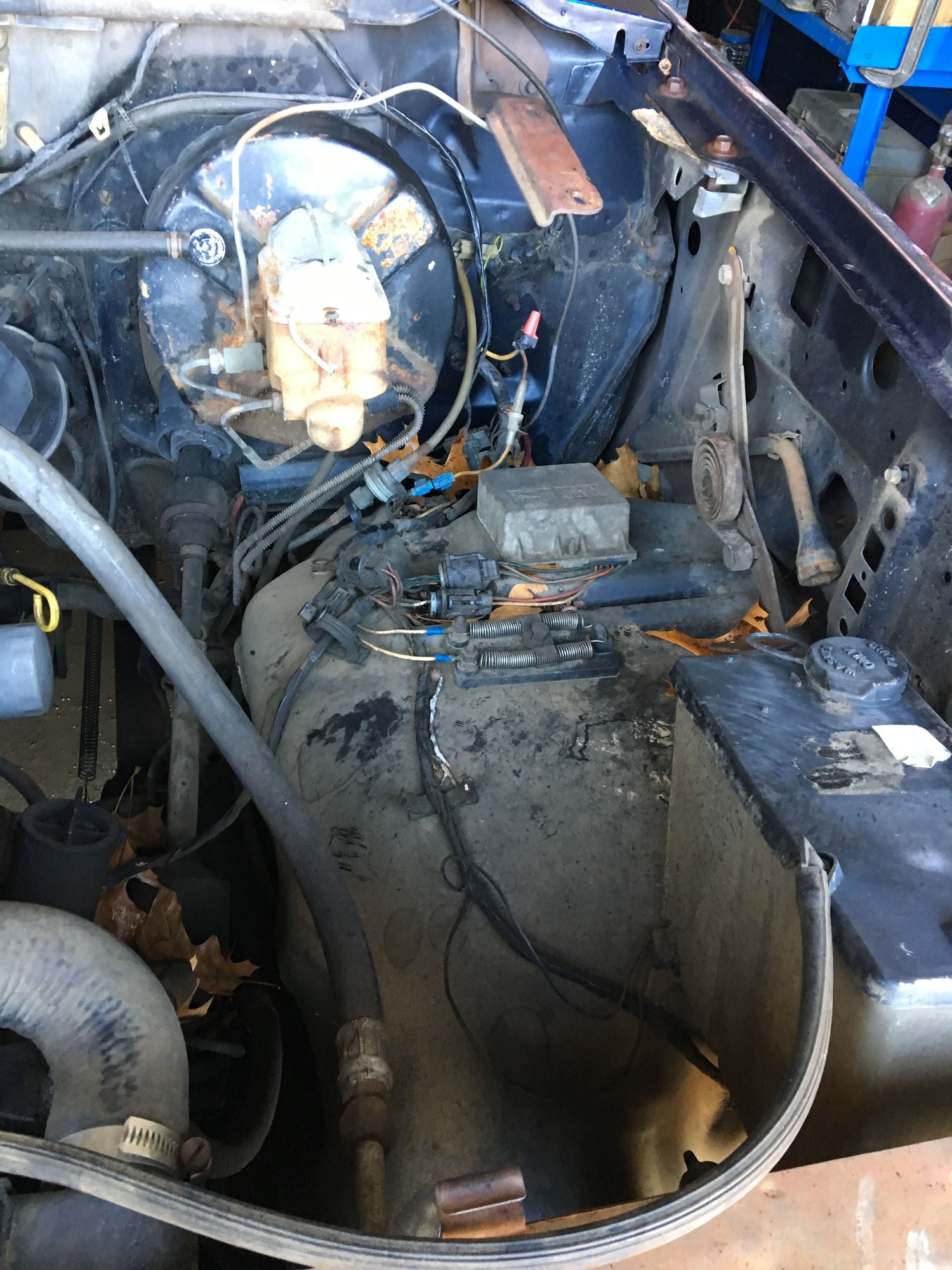

Here is what it looked like when I started the process.

It has been converted or you might have a Canadian model.

Originally Posted by xjghost
What did this FI system look like? This is a 1984 truck.
The feedback system was not F.I.. It was what Ford did just prior to the F.I. It was a carburetor which had some capabilities of varying fuel mixture based on input from a MAP and Oxygen sensor. I cannot tell from the carburetor photo, but on the driver's side, toward the front of the carburetor would be what looks like a solenoid with wires attached. If your carburetor does not have this, then it has been swapped for an earlier model. The metal box located on the driver's side inner fender is the Duraspark ignition box, which is what was used for the ignition of the earlier models.

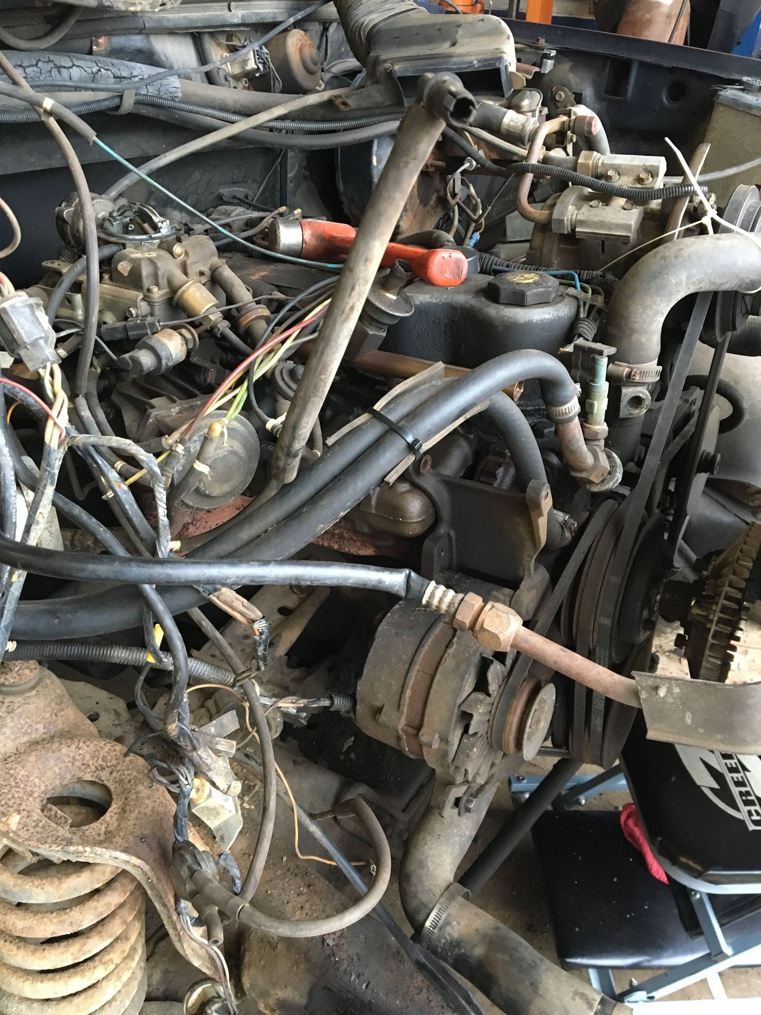

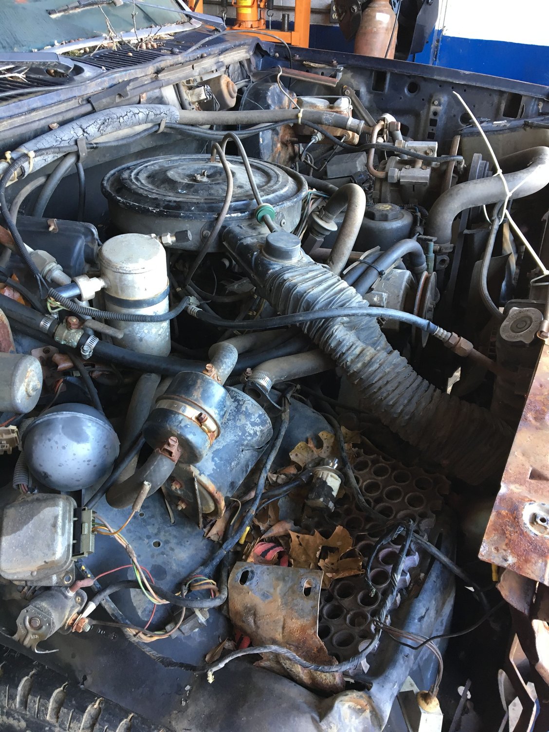

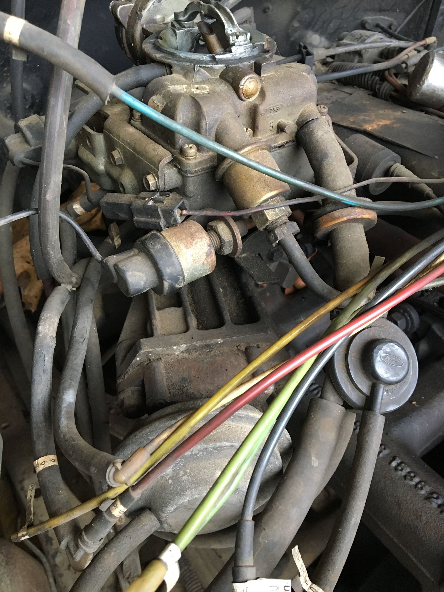

Here are some more of the mess I started with. I'm going to see if I can find out what should have 12 volts with the key in run. The more I tinker with it and think about it the more I think it's either loosing voltage when it goes from start to run.
The carb and vacuum lines before I started removing them.
The mess I removed.
The motorcraft "computer" is on the Driver inner fender.

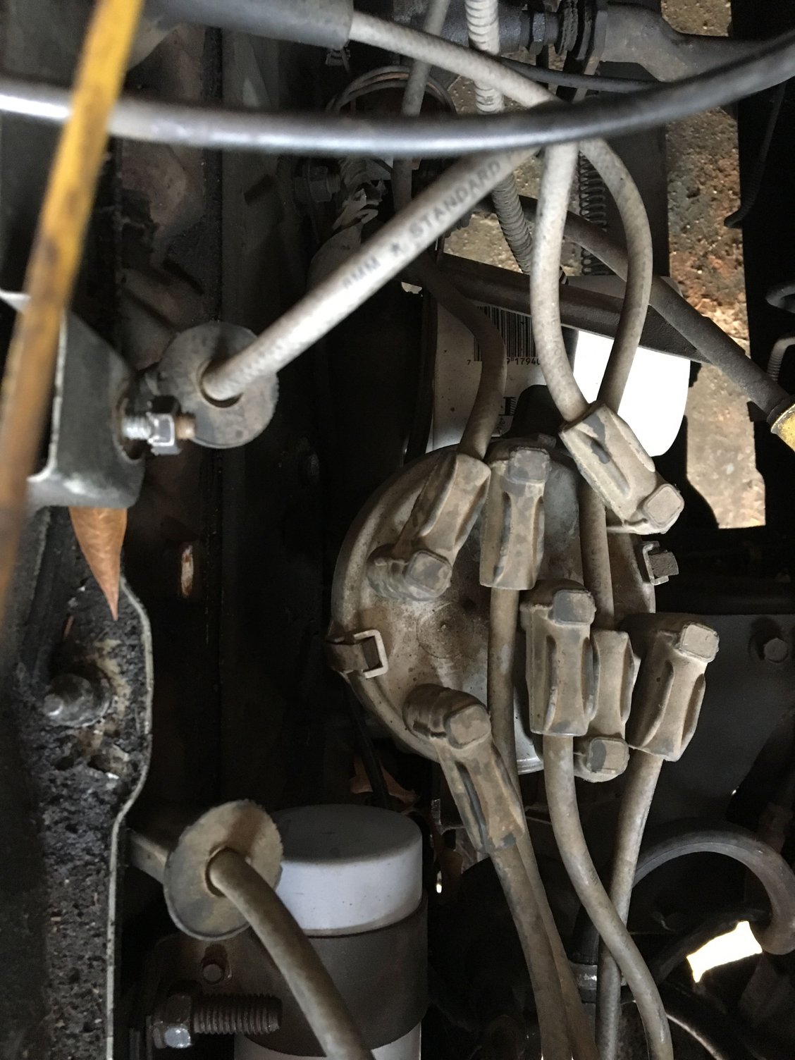

Distributor from top.
84 Distributor.
Where does the Yellow vacuum line attached to the Dizzy connect to ?
