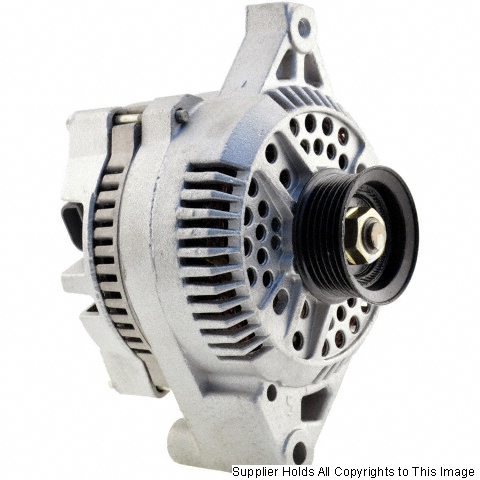

2G alternator has an external fan.
And as pictured in the previous post, a 3G has an internal fan.
