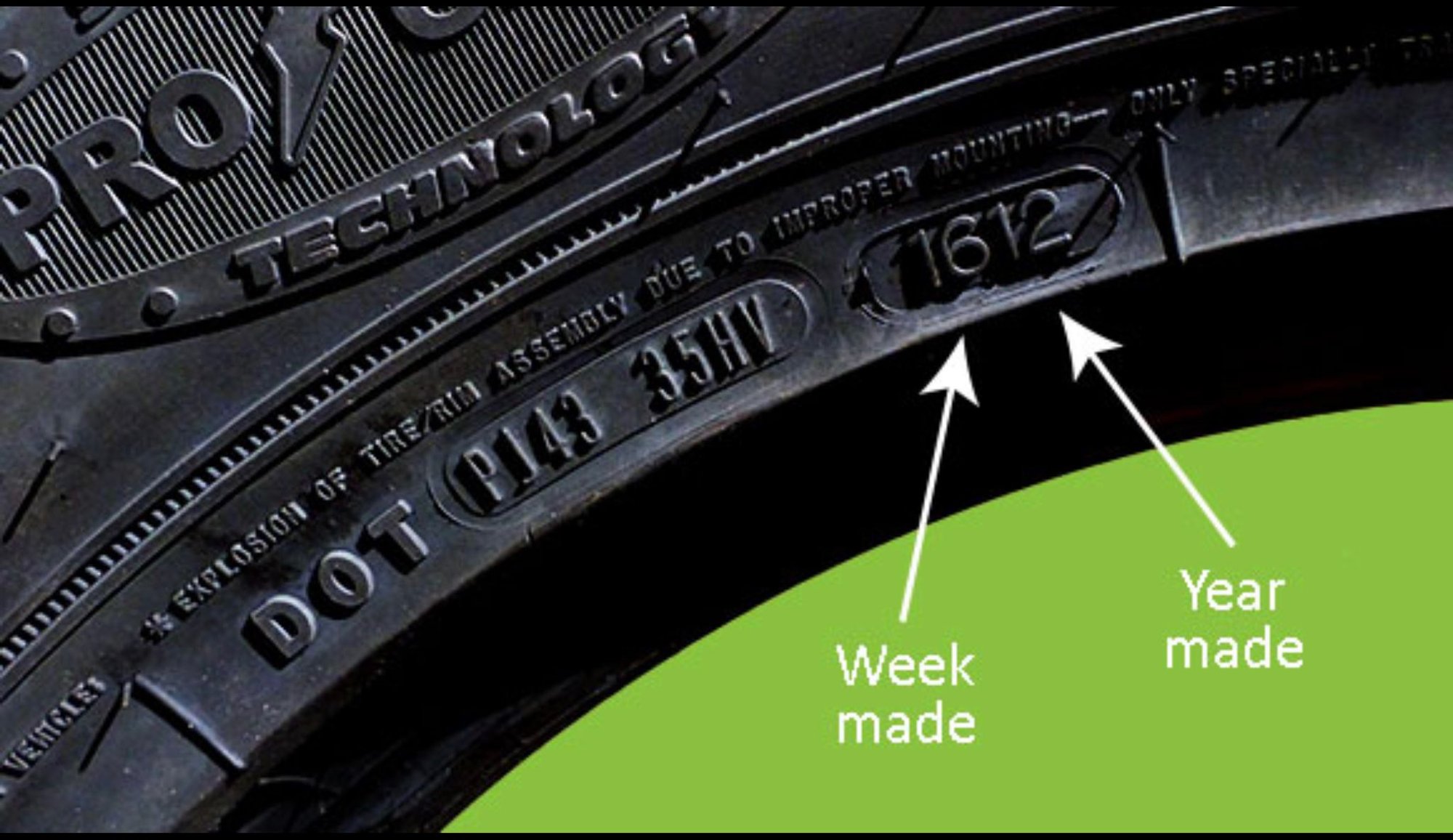

You make them sound used. I would check the born on date if older than 5 years I would not mount them. Also make sure they’re Load E.

To clarify, I purchased the rims with the tires on them. The previous owner claimed low miles on the tires. 2 of the tires have nearly all the tread depth. Measures out at 13/32 where new was 14/32" The other 2 were about 11/32". I mainly bought them for the rims as they were Lariat 6 spoke 18 inch. I currently have the 18 inch 7 spoke chrome clad rims. I am not a fan of the look. Lariat rims are more my style. I am debating to keeping the HT3s that came on the lariat rims. One of my thoughts were to have the tires dismounted and flip them on line. Sell the other rims I have for the truck. Maybe have the Michelin's LTX AT2 swapped over to the Lariat rims. Those are not too bad maybe 50% worn. I just wanted to know if should bother with the HT3s or not. I had a set of AT3s which mixed results with. Hence a gut check.

‘This is how you determine how old those tires REALLY are, tread depth is irrelevant if the tires are over 5 years old.

CO F350, I understand date codes. I know where you are going with your thought pattern. The tires are 5 years old. They were made at the end of 2013. I know your are using the 5 year mark as a guide for replacement. Most vehicle manufacturers states 6 years from date code on the tire. Completely understandable.
