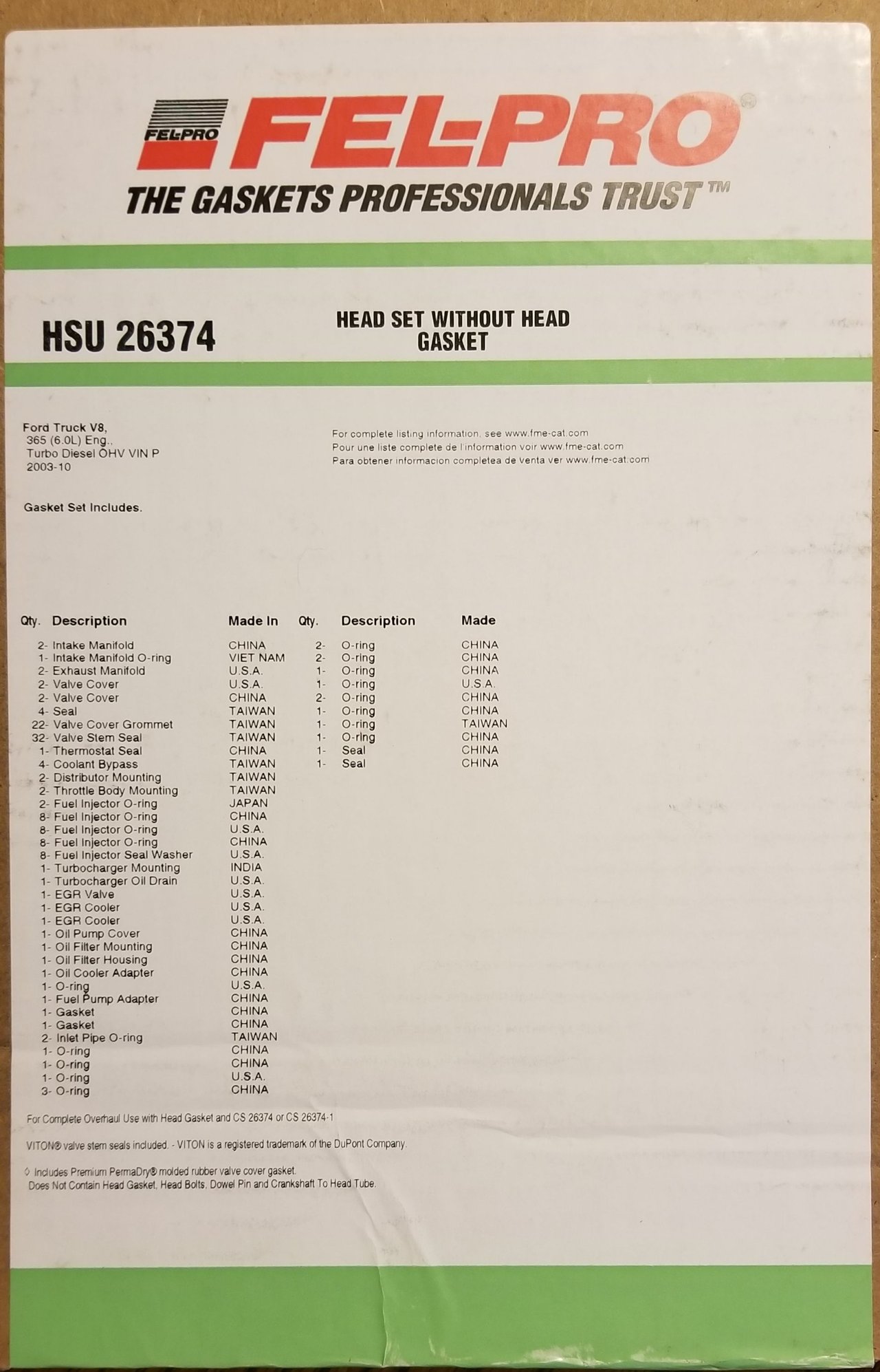

I had high mileage on my 2005 re-usable gaskets (valve cover, intake, ect.) so I bought the Felpro kit. The kit also came with the rocker box o-rings which I dont see on your list. The kit also comes with a full set of injector re-seal kit and an oil cooler seal set. Head gaskets are not in the kit, they are separate and offer 18 or 20mm dowel size (dowels not included).

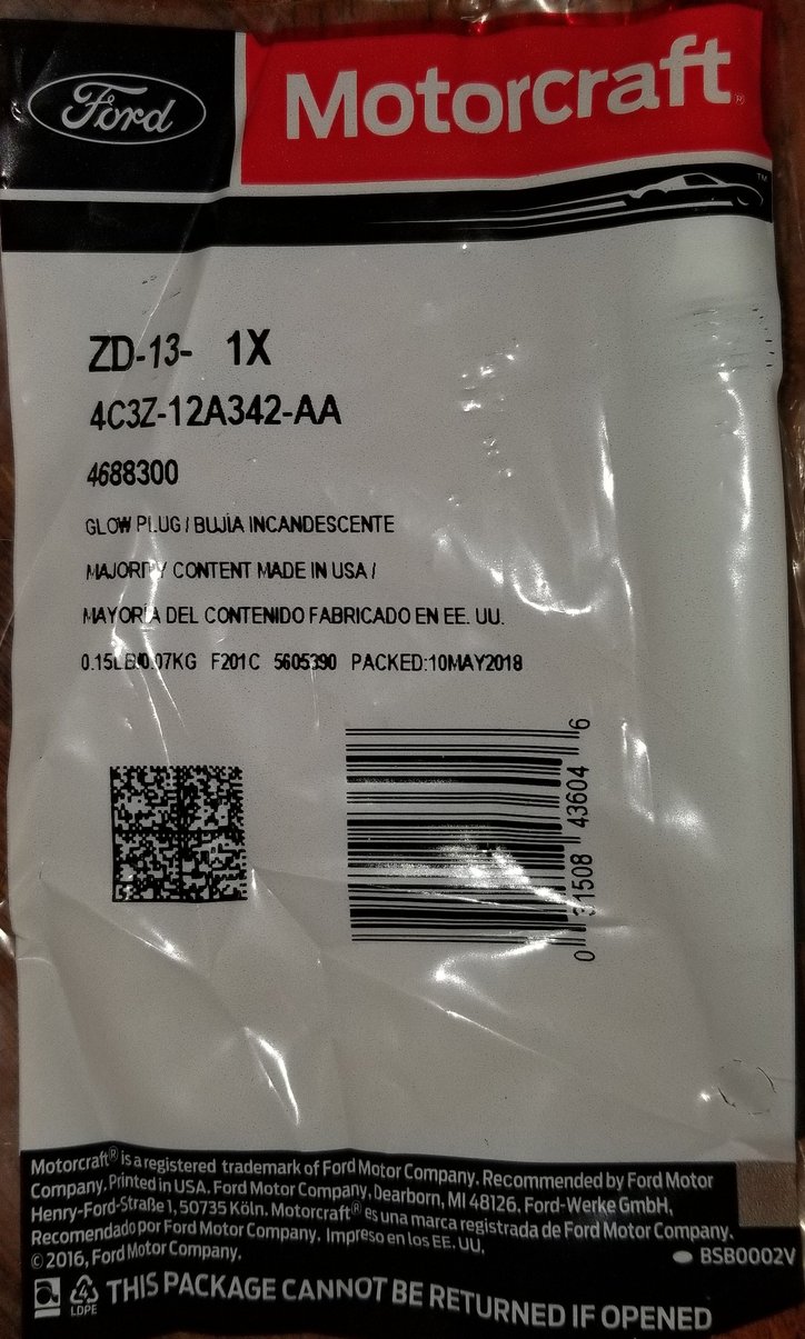

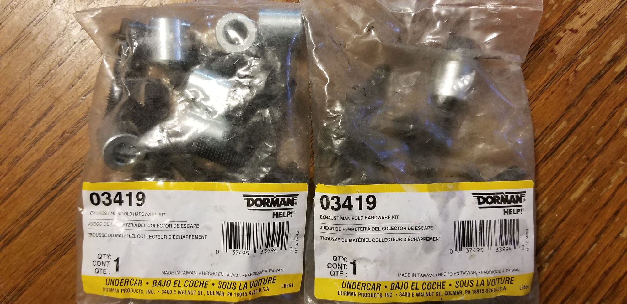

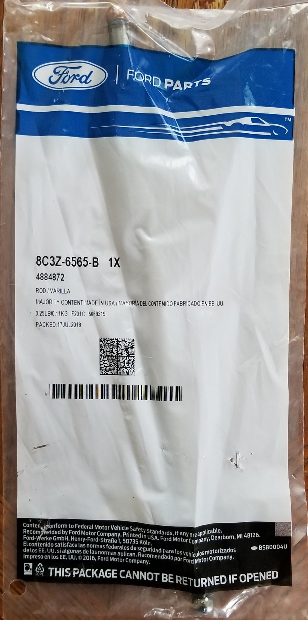

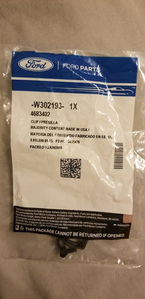

Other considerations are manifold bolt kit, Rocker retainer clips, New Motorcraft pushrods, Belts, Motorcraft Glowplugs, glowplug harnesses, Cam/Crank sensors, Y-pipe (inspect flex joints), Y-pipe flange bolts and new lock nuts.

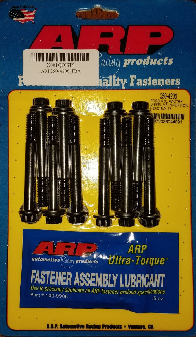

Majority of these parts after shopping around I found on Amazon and were genuine Motorcraft. I also used the ARP upper bolts for the heads but are not really necessary.
