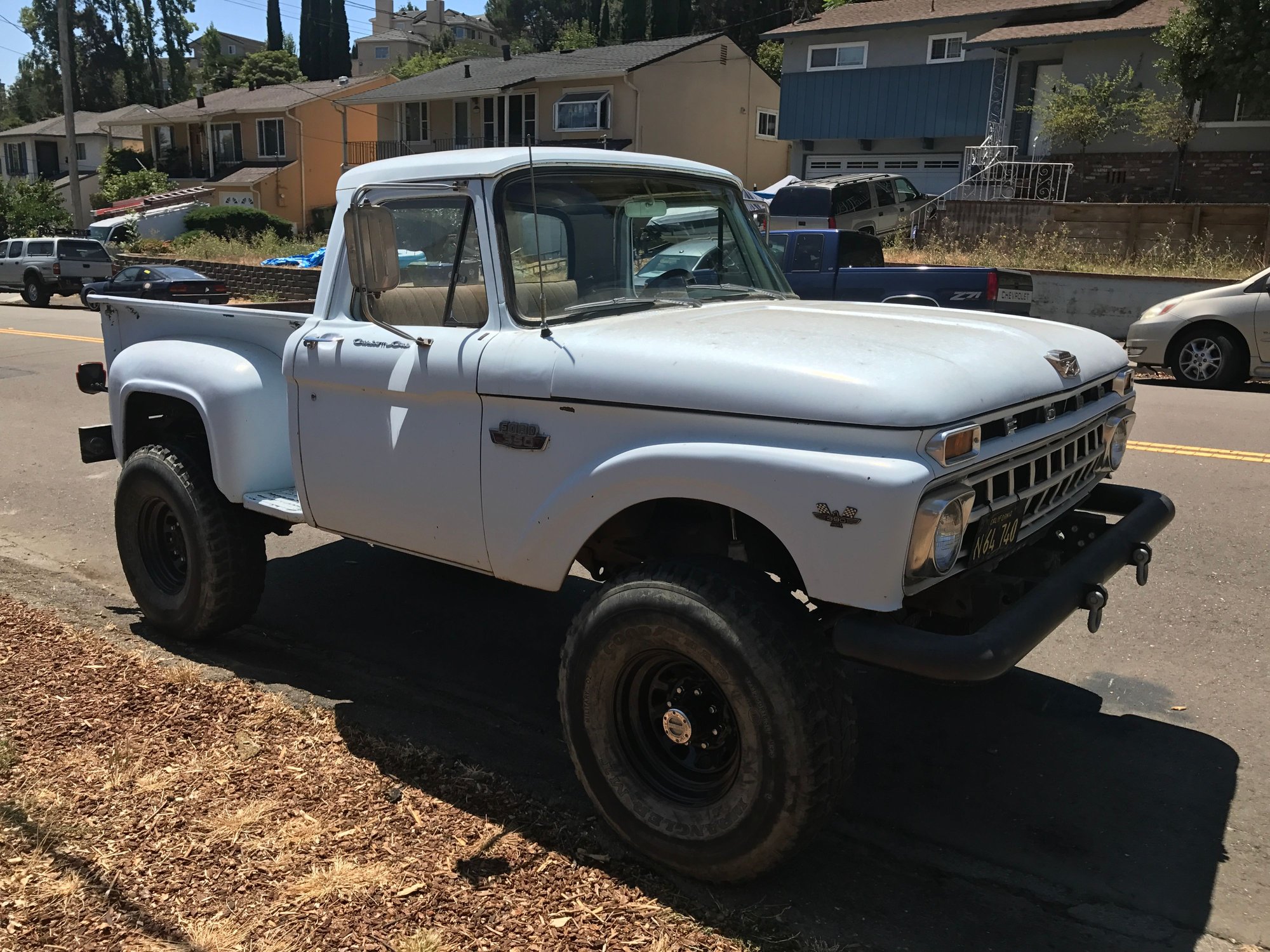

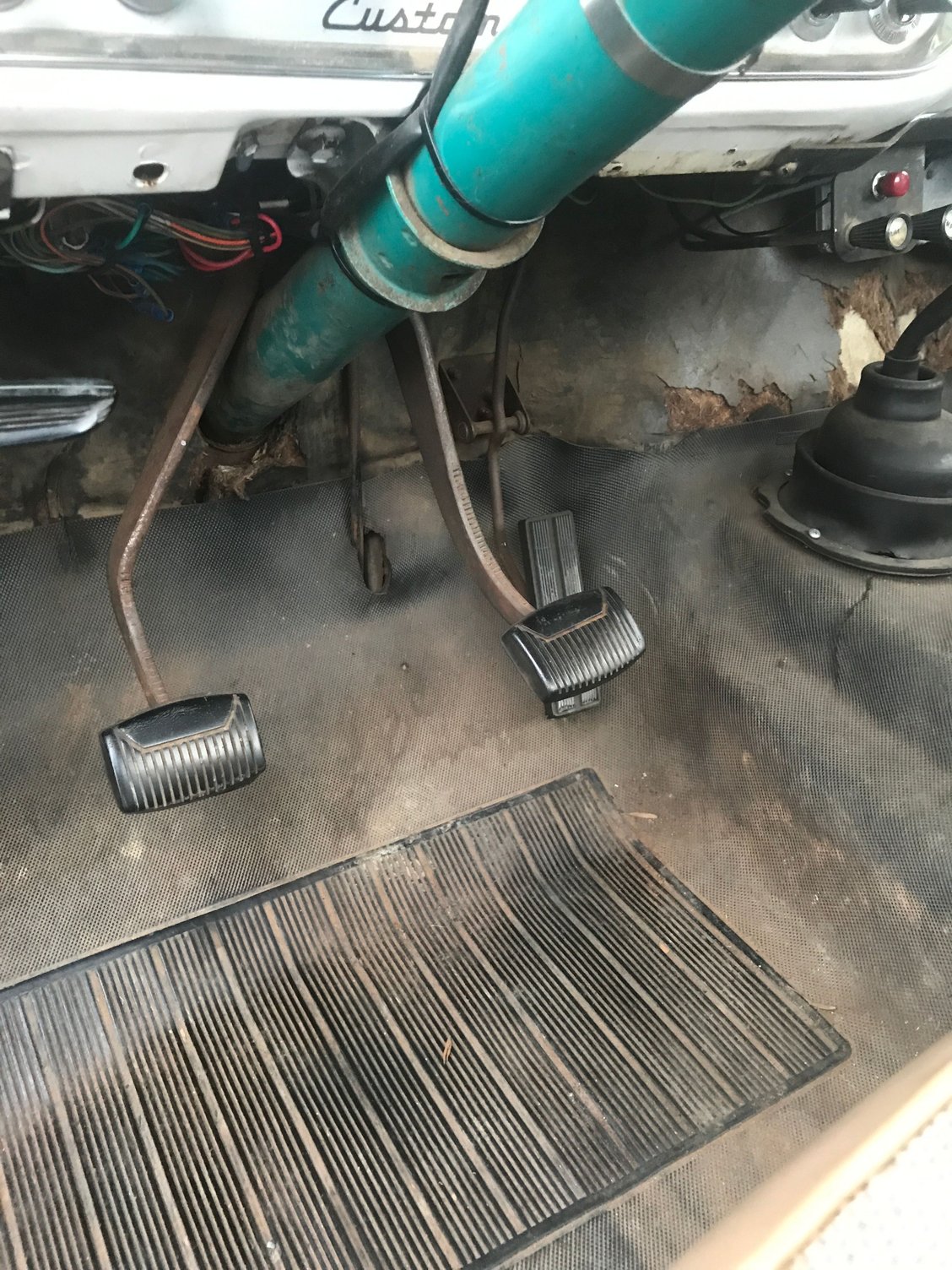

Ok so it's a '64 then with a '65 grill and upper grill panel. If the grill was swapped maybe that's why my inner fenders are from a '65 also. But then there's the floating gas pedal...which i guess could have been changed out? Anything else I can look at to visually verify its a '64 cab vs '65?
I want to buy a new floor mats, firewall pad, and some other parts and i notice a year break at '64/65 and i just want to make sure i get the right stuff.
Thanks again! Here's pics. Will get the VIN plate later and any other shots you need.

Sequential Unit Number 472848 = Nov/1963 Production (**Year of production has been corrected, see post # 10 & 11)
**If the Inner fenders are the "Square" style, it's most likely the front clip was replaced at some point, as only the 1965 & 66 Twin I beam two wheel drive trucks, and the 1966 F100 four wheel drive used the squared inner fenders. The straight axle trucks used the rounded inner fenders.

The floorboards, clutch and brake pedals, steering column, and floor mat are indicating 1965/1966 and the floating gas pedal is indicating 1966 "From Serial 696,001" . A 1964 and earlier cab will have a feature on the firewall where either there is a cap covering the heater blower motor or there is a cover if no heater blower, whereas 1965/66 both have the heater blower motor on the inboard side pointing at the passengers knees.
Cab step or lack of one will also be a good determining factor. No pictures of firewall or cab step yet, but those would help to identify this one.
