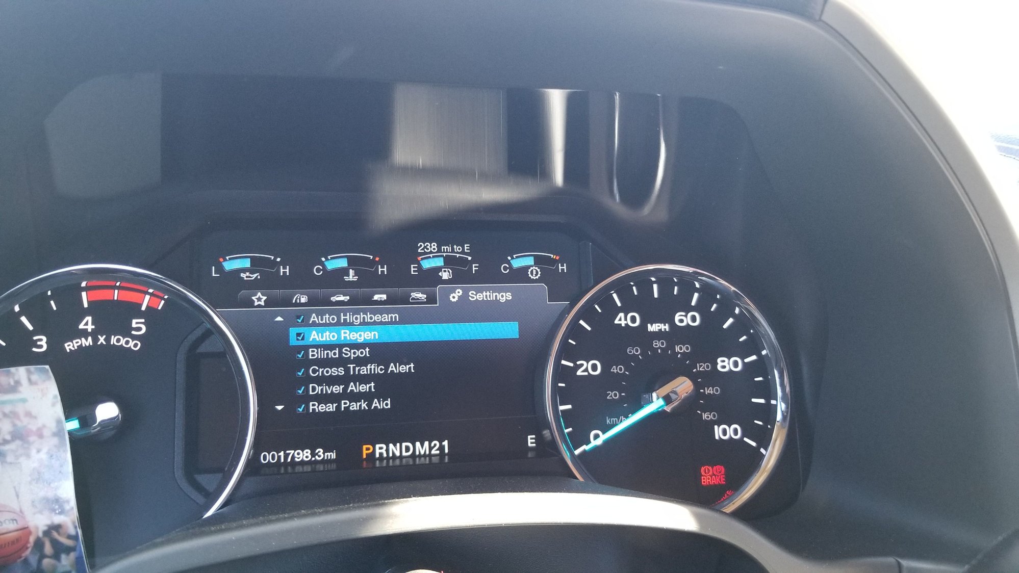

Just left my local dealer and asked them to enable my filter status as it did not come that was on my 2018 F250 Lariat. Took all of 15 mins and they even did it free of charge. Now just waiting to see if it hits 100% to see if I can do the ORC. Below are some pics I pulled from other threads to show them at the dealer. I also noticed that they enabled an "Auto regen" option that noe shows up in my option settings

I didn't have a blank screen either. Once they enabled it in the "fuel" settings with the IDS, it then showed up under the truck tab. After it showed up in the truck tab, I can then add it to the "My View". The "Auto Regen" on/off also appeared in the setting tab in the far right.

You do not NEED IDS or a trip to a dealer to enable manual regen.
I added / enabled the auto/manual regen option on my own truck using FORScan....I even wrote it about it in the FORScan thread of this forum - post number 3850 provides screen shots of the option being edited.

Ive enabled manual ReGen's - unless im traveling a distance or running the truck long enough to (fully) complete a regen - I keep the auto-regen turned off or disabled.

on long trips I ping pong back and forth between WAZE and FORScan Lite.
on short trips or running around locally - I generally only look at FORScan if I know I'm getting close to a ReGen...or when I initiate one.....
generally I run w/ Auto-ReGen disabled....if im 15 or 20 minutes (or more) from stopping or home I'll turn on AUTO-ReGen - knowing I have enough drive time to fully complete the ReGen.
Than particular screen shot was during a 1400 mile (non-stop) drive - Northern Shenandoah Valley of Virginia to Houston....it was quite cold that day....11*, dipping to 4* during.
