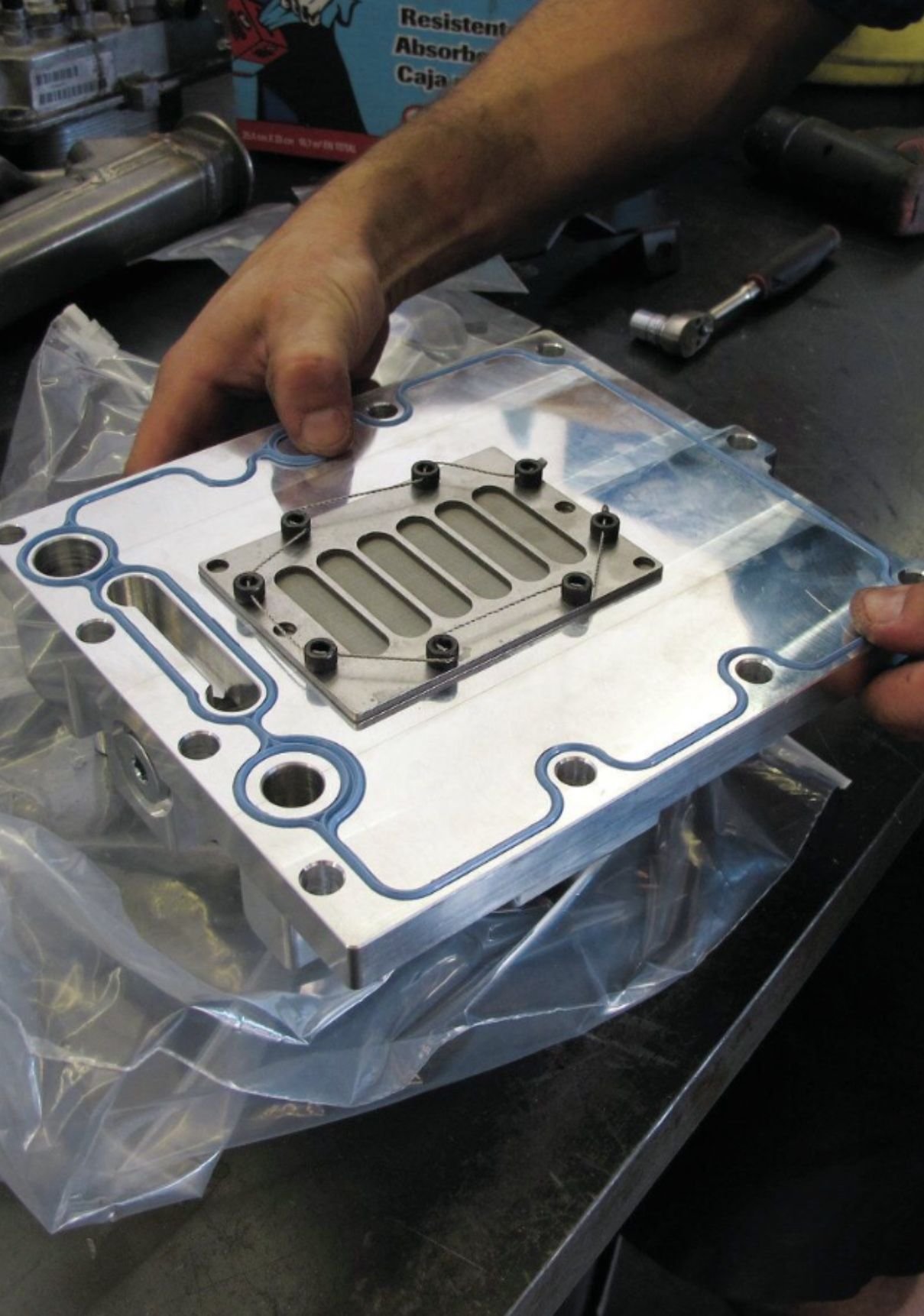

I ordered an IPR stainless screen to put in my truck, but then decided to go ahead and get the BPD oil cooler. It has a screen in the oil block. Would it be ok to put the other one in to or would that cause problems?

I don't know what you mean by a screen in the oil block, can you take a picture? I would definitely run the screen in the HPOP sump if that's what you're asking.

I would not bother with the OEM screen if you put the BPD one in. The OEM one does tear. If a piece breaks off, it could lodge and cause problems.

This is the screen on the BPD block

Yeah, the BPD is worlds apart from the OEM. Nice craftsmanship

They even got all but the one bolt safety wired correctly.
But they ran the twisted wire thru the holes, defeats the purpose of twisting the wire.

I did not look close enough the first time. But your quite I missed that.

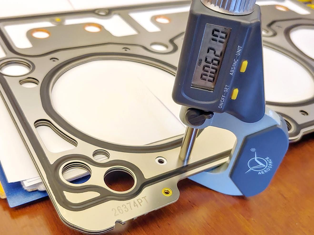

BD is not perfect. Over on the org they did this write-up about differences in head gaskets and it started to get me second guessing my engine work. I remembered FelPro saying they made their gaskets thicker to compensate for aftermarket machining but when I looked up the data from that work it didn't show any difference, the FelPro was the same. I contacted the guys at FelPro and not only did engineering state theirs was 0.010" thicker, tech support even rechecked with a mic and sent me the image. I then triple checked one myself, they are 0.010" thicker and allows me to use the Colt Cam. I then asked FelPro if they ever changed the thickness and they said no.
So here is this whole production of photos and a spreadsheet of checking head gasket differences in the tech folder and it's not right for lack of correct micrometer readings or addition. You can't trust any of it.
FelPro sent image.

Oh I see what you mean now. It wouldn't matter if you ran the IPR one or not. I'd probably just sell it.
