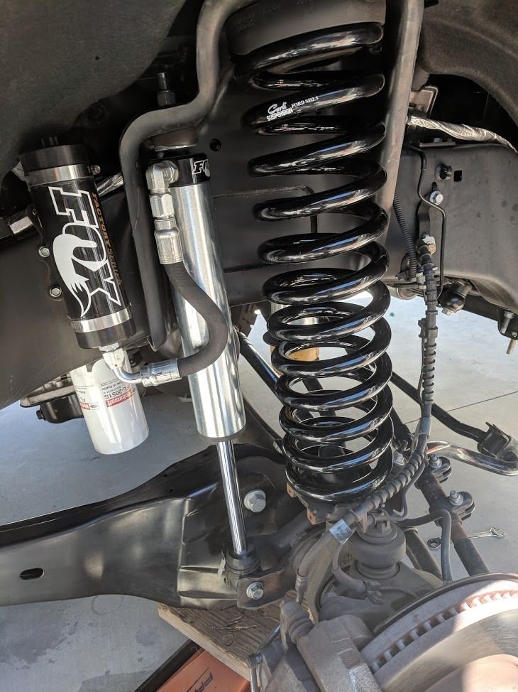

I like to see/hear what people have for resi mounts in the front. I have some 2.5" Fox's to mount and the standard mount brackets.

I mounted mine in the standard position, only an issue if you keep the stock +40mm offset wheels, you'll rub at full lock. I don't even come close with my 0 offset wheels. You can get the Carli mounts that go in above the coil spring, or PMF I believe makes some nice billet ones for $$$$.

Thanks Tricon. I plan on using OEM 18" wheels, so using the supplied mounts might be out. Is it close enough that tucking the resi's a little tighter to the tower flange will allow enough clearance?

You're going to have to get a coil mount. The Carli ones are $70, the PMF look awesome but they're $200.
There's just not enough room there for how deep those stock wheels go towards the frame. At full lock, pretty much any bump you hit will rub the reservoir or hose.

10-4. I'll just get the Carli ones.Thanks
