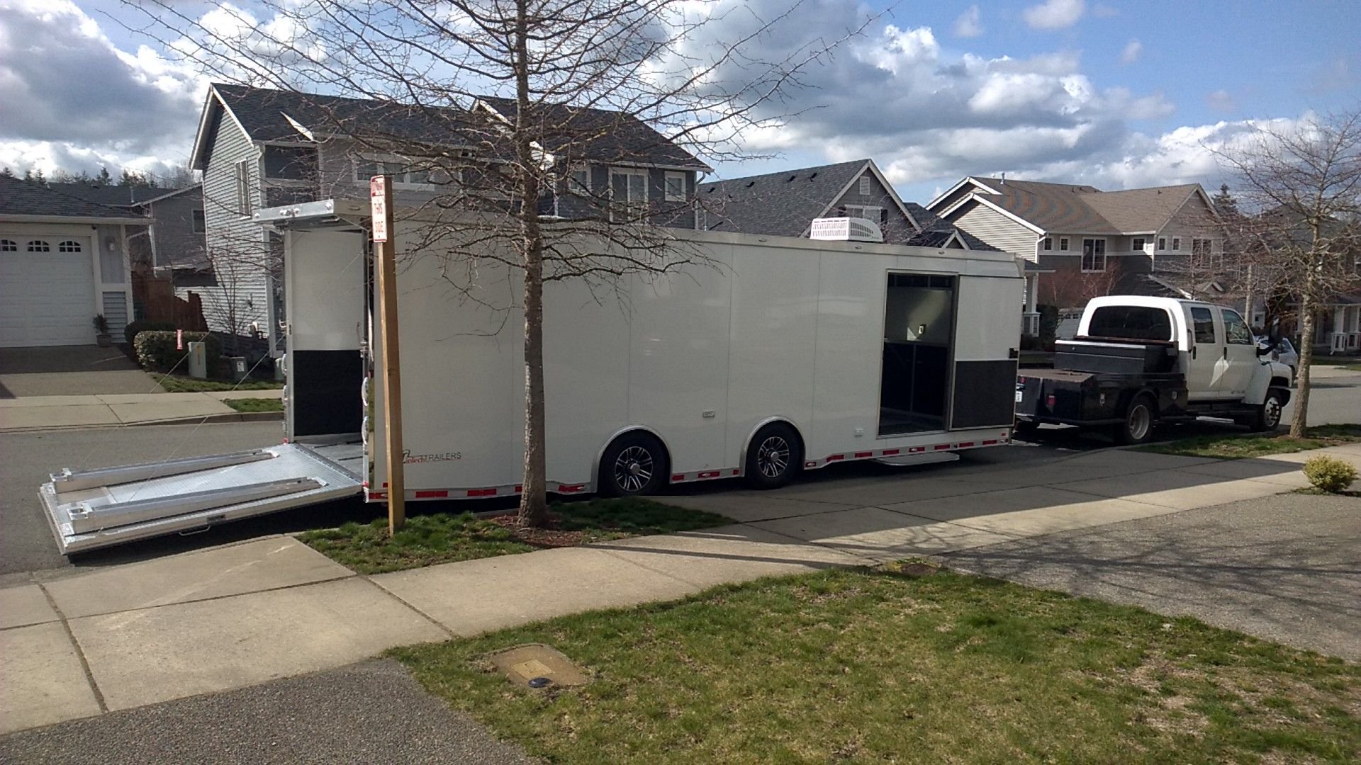

New to the site, looking to buy a SD to pull my enclosed trailer and be my everyday truck. My biggest question so far is how to integrate my trailer backup camera. When the trailer was built in 2016 I had them run the wire and add a VCMS155 Voyager camera.
I noticed on my friends truck he hast the Ultimate Tow camera stuff that his camera has a whole different plug style. Has anyone figured out a converter or been able to change the plug to use their existing backup camera? I need to come up with an electronic solution as running new cable in a 40k trailer is not an option after it has been built.
