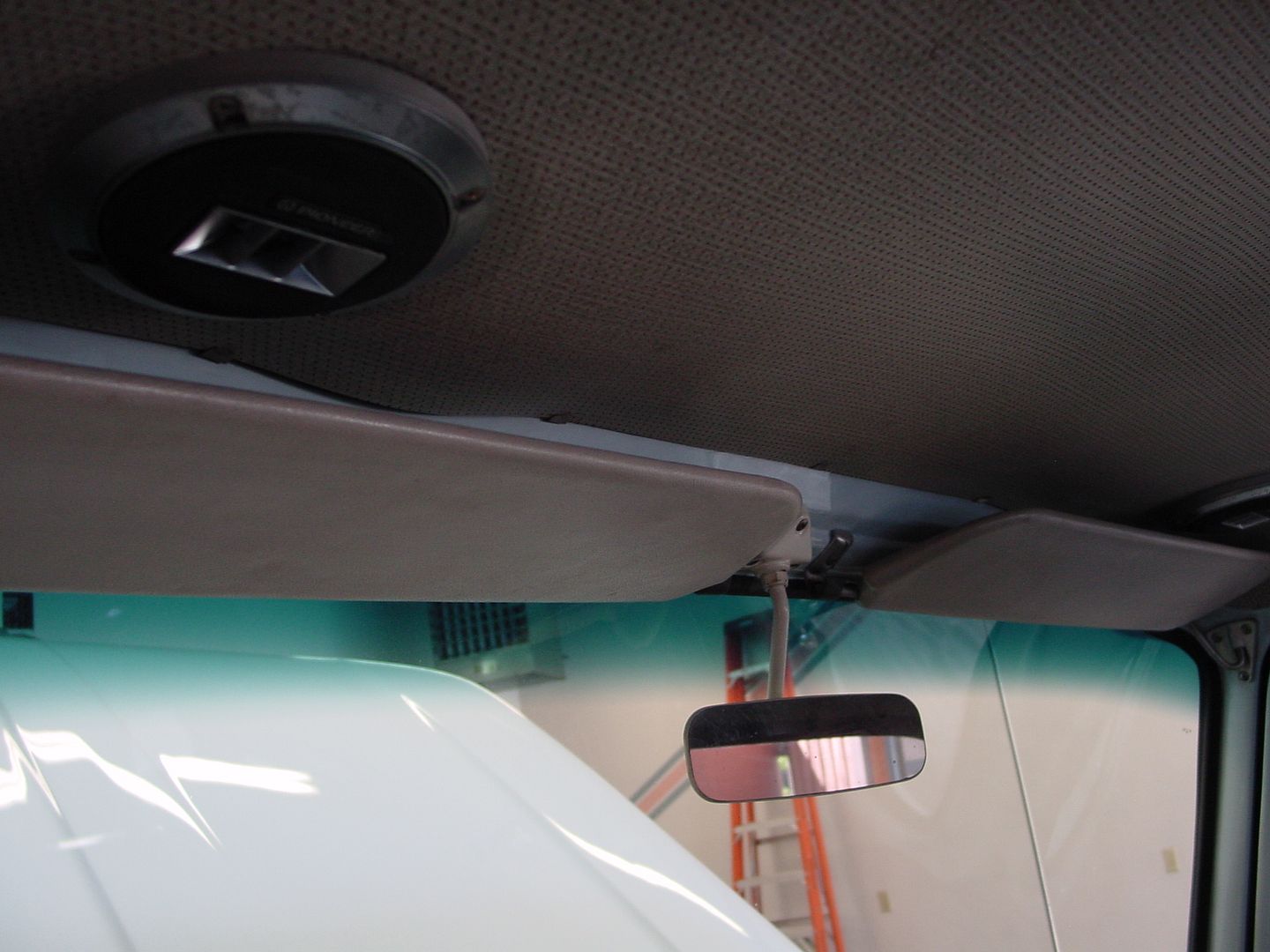

Here's another option. These speakers have been installed in this truck like this for years. Original headliner, too.
Chad

Thanks for the pictures Chad. Like the ones up in the headliner. That's a good option and probably would look good in the rear also..

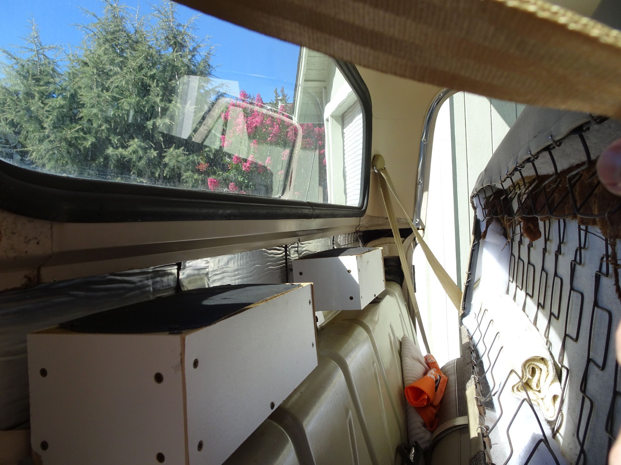

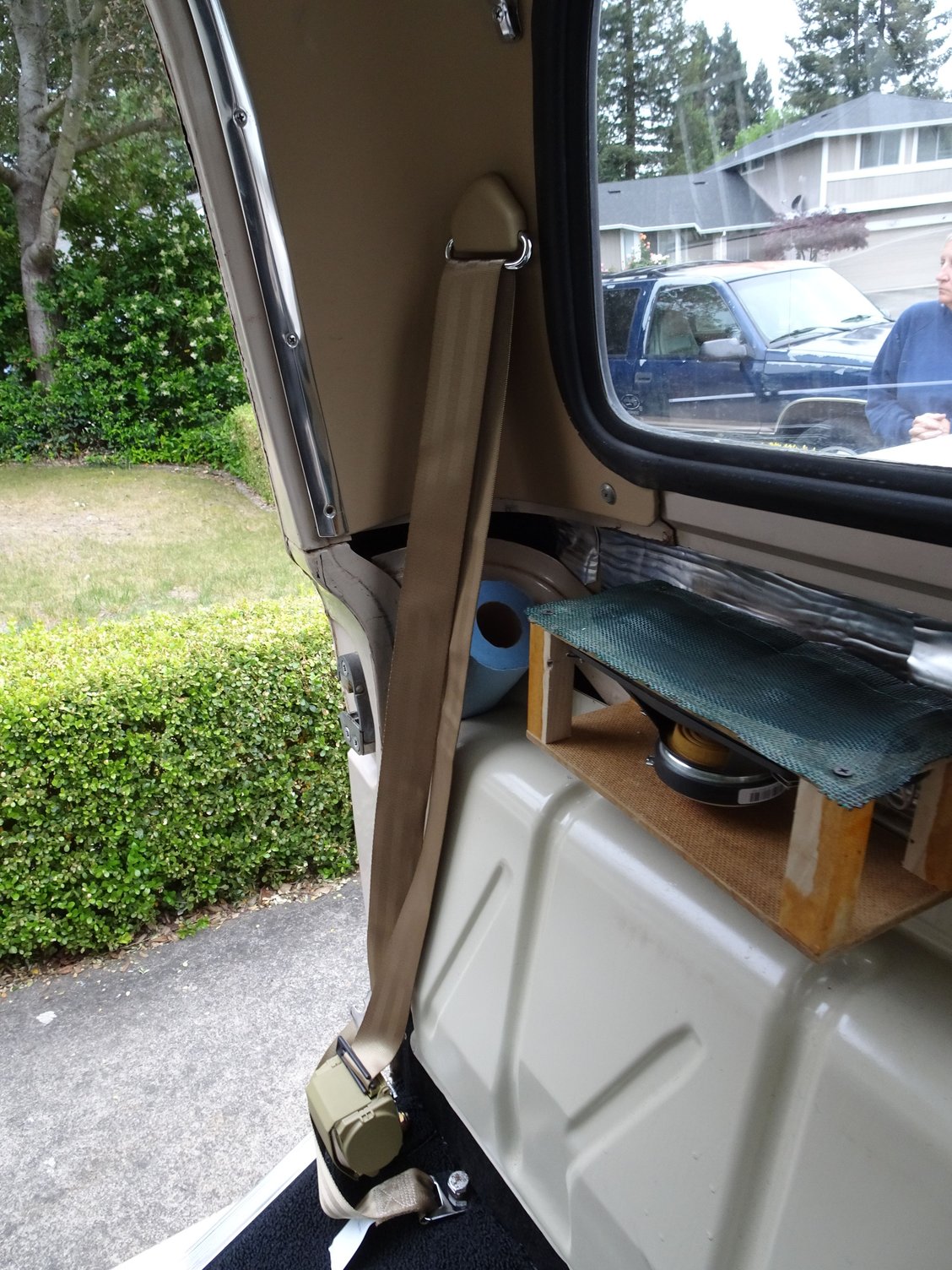

Here is what I did in my '65 Custom Cab. Pics below.
I is a 300 6 cyl with single exhaust and a glass pack.
I lined the entire cab(except the higher part of the firewall that would have required removing the heater and the original firewall pad) with sound deadener, two types. I slid the sound deadener as far as I could up behind the pad. Also put it in the doors. 1st layer is Fat Mat 80 mil Rattle Trap version. I believe the 50 sq ft roll did it all, about $100. 2nd layer is Frost King Duct Insulation(Lowes or Home Depot), foam foil on one side self adhesive on the other, much cheaper. Each 15' long x 12" wide x .125" thick about $19 a roll here in Calif.
I also used the RetroSound Huntington.
Dash speaker is a RetroSound 5x7 Dual Voice Coil and it sound good. Removed the original screen material for the tweeters to clear and it fit fine under the exterior factory grille.
Rear I put two 4x10 speakers. I built some thin walled boxes to hold them. Made brackets to mount them off the upper fuel tank retaining bolts. The driver side had to be more towards the middle to clear the fuel line out of the tank. I may be losing 1, maybe 2, notches on how far the seat can go back to clear the speakers but I'm 5'8" and it's fine where it is.
It all sounds pretty good. Can hear it with the windows down at freeway speeds with it turned up a little. Hear it really well with the windows up. Not using an amp but were told by the folks at Crutchfield that that would really help wakeup the rear speakers. Use good gauge and quality speaker wire too that helps.
I'm not a music snob but have played piano and trumpet most of my life so I want it to sound decent.
Grilles for boxes were cut from some old speakers. Speaker cloth could do that job too. Boxes will be painted.
Box before it ws enclosed and the metal grille added. Also lined the inside of the box with the Frost King Duct Insulation.
