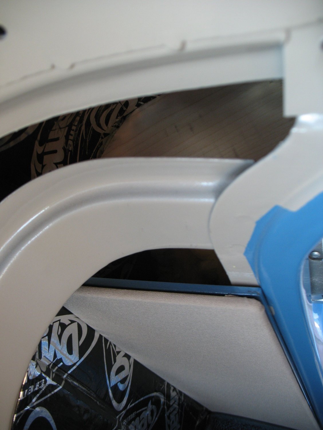

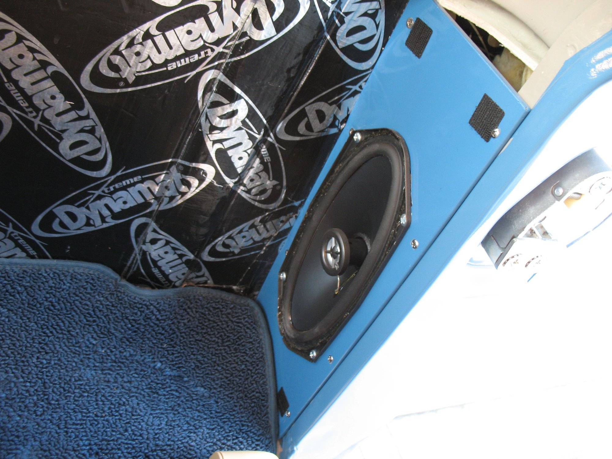

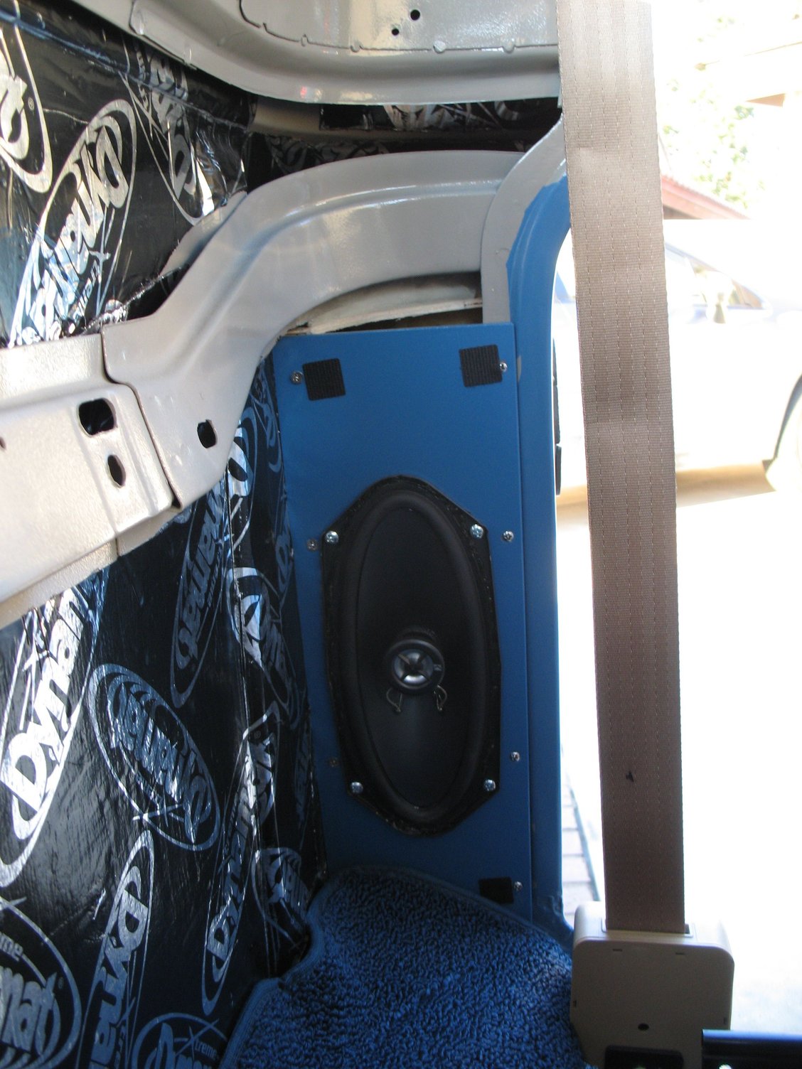

Here are some photos of my idea. The grille covers are 3/16" hardwood ply with cloth covering to match the interior. The interior will all be the tan color when done, including the back of the cab. The speakers are 4X10 Kickers. The speaker baffles are also 3/16" hardwood ply, fastened to the forward edge with sheet metal screws and to the back side of the cab on a 1/2" angle steel strip with holes drilled and threaded for machine screws. I tack welded the metal to the cab back, since the cab was yet to be painted. In some photos you can see the small piece of plywood shaped and glued into the panel above the speaker to make the rear quarter panel "semi-closed" similar to a speaker cabinet. The inside of the quarters are well insulated with the dynamat and fiberglass batting.

Thanks again all! Resonateur, thanks for the pics. Looks good and clean =- I like it.

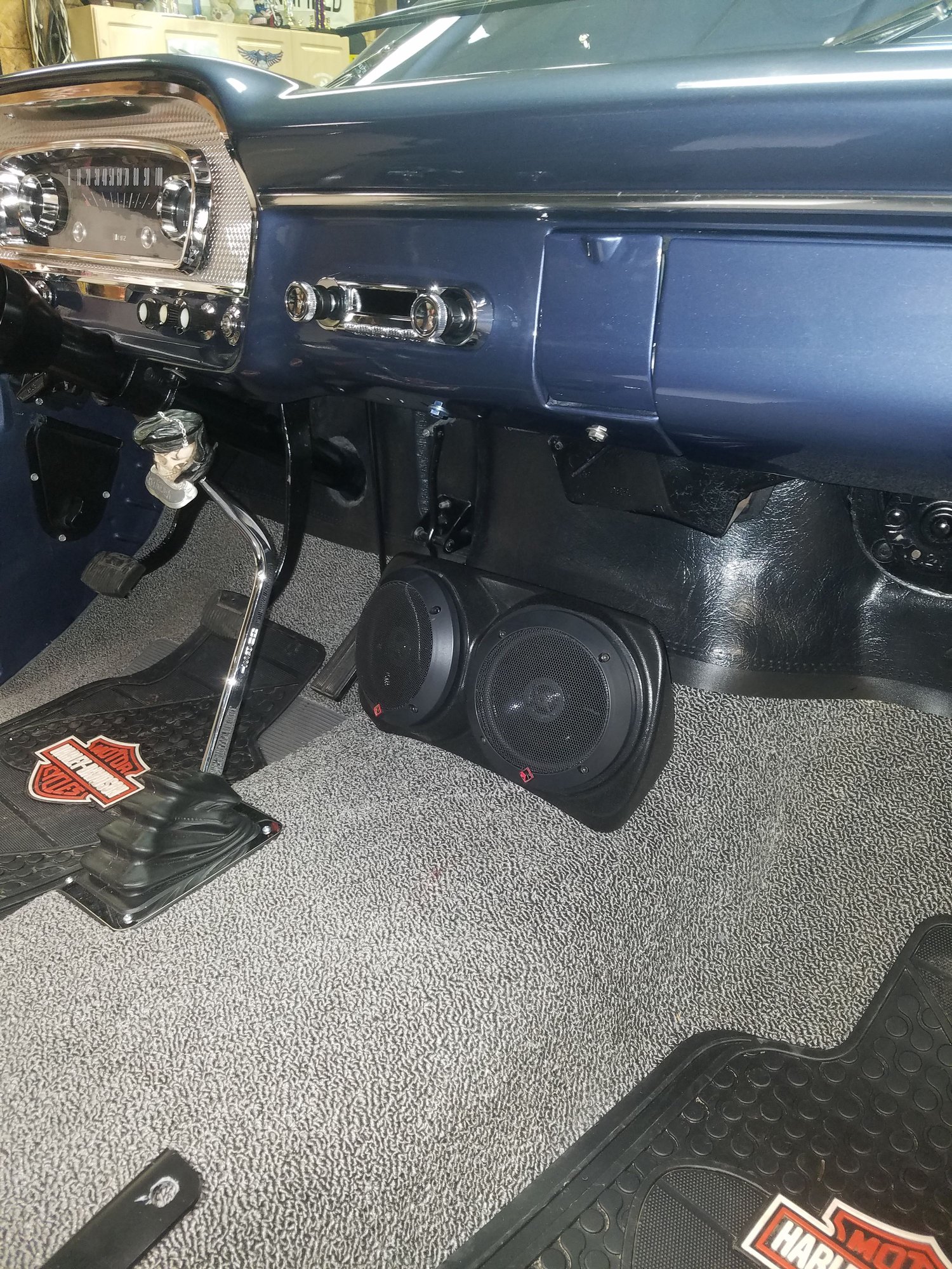

Morning all. Thought I would give a quick update on the front speaker situation. Decided to go with a Centra-Pod unit from Select Increments with a pair of Rockford Fosgate P152 Punch speakers. The pod is for a Jeep, but, I think it works well and looks good. Really did not want to cut the doors. As far as the rear, still looking at options as I still don't like what I currently have. The front works and sounds great.

I don’t blame you for the no cut policy. My truck didn’t even come with a radio, so I’m not sure I want to cut the dash or the door. That’s a sharp looking interior you have there. Three speed moved to the floor?

Thanks for the compliment. Yes the 3sp went to the floor. I like it better there. I have a line on a couple of 4 speed top loaders. The guy says one is from a 67 Cougar and one from a 68. Said both had 390 motors.

Can't make out what your shifter **** is....can I see a bigger pic of it?

Its something I picked up at a bike swap meet a few years ago. Didn't know what to do with it so I made it into a shift ****.

Back to the floor shifter, I may move mine to the floor so I was wondering what brand shifter you used? About 10 years ago, I used to see hurst shifters from one seller on EBay that weren’t priced bad at all.
