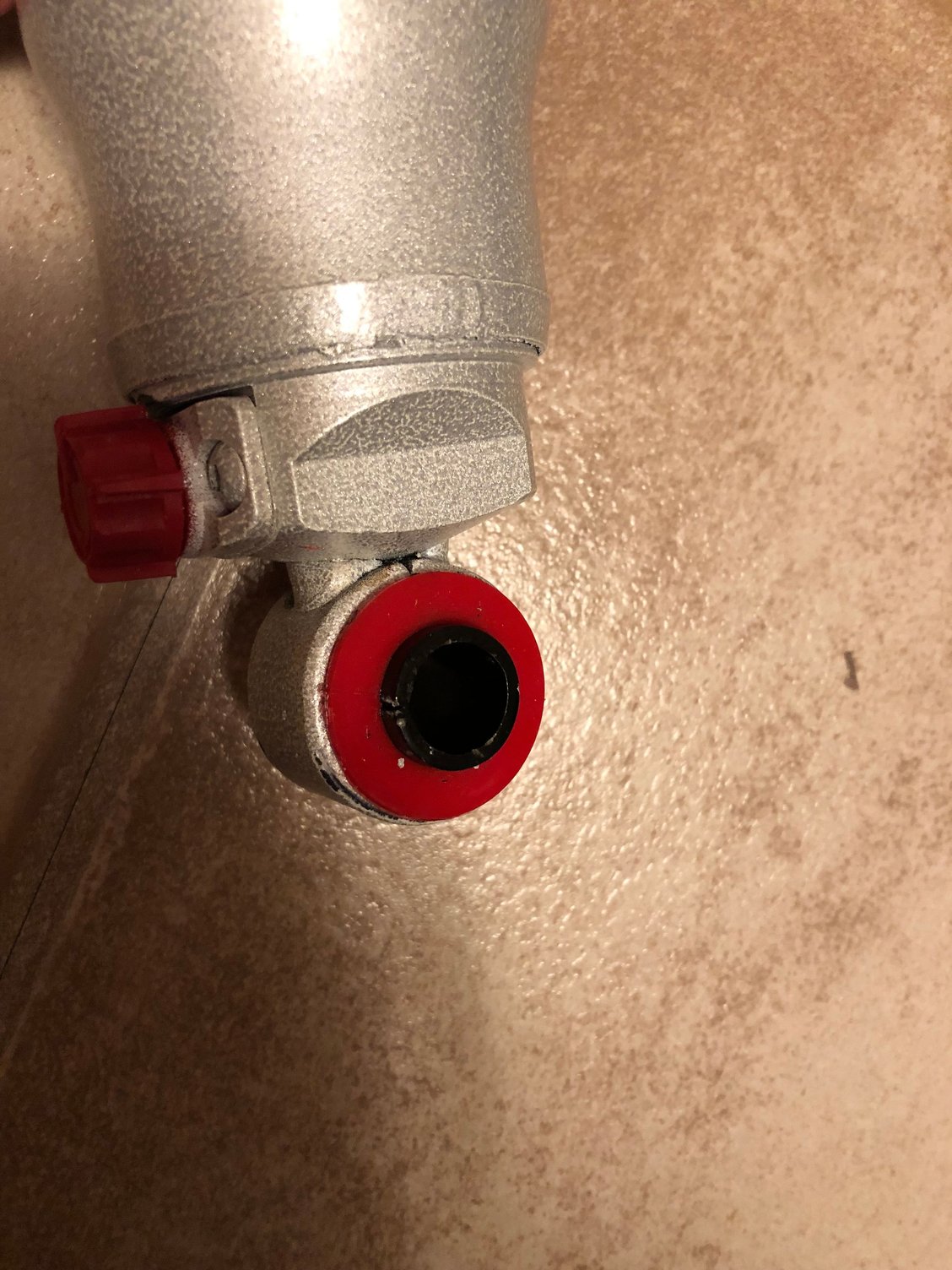

So I got my Rancho 9000XL’s today. Plan on installing them this weekend. I have a quick question. On the rears, should I have that black bushing on both ends? I only have it on one end, but they are both like that, so I assume that’s how it supposed to be.
Old Jan 11, 2019 | 04:50 PM
  #59
Imadentguy's Avatar
Imadentguy
Joined: Dec 2018
Posts: 652
From: Katy Texas
You need a steel sleeve running through that bushing. Sometimes a hardware kit will come with new shocks that have an assortment. Not sure about the ranchos though. You may be able to press your sleeves out of your OEM shocks but you need to make sure the OD is the same size as the bushing on the rancho shock. I’d hit up the rancho rep on here and find out whats up. He’s a cool dude and hes all about helping people on here.
