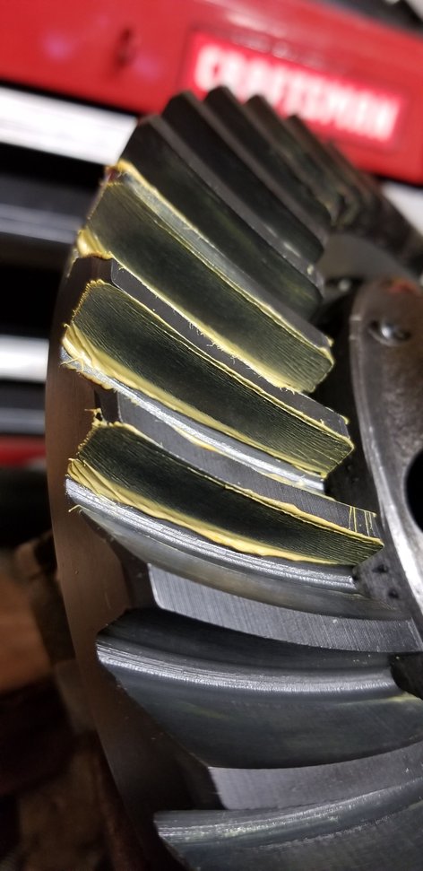

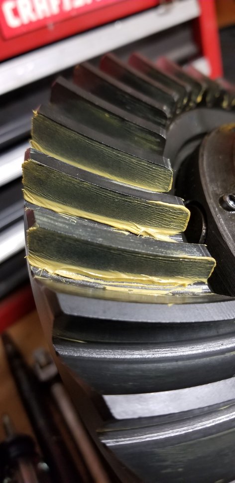

I'm setting up my 9" with new 3.50 Motive Gears. Backlash is .007 (spec is .007-.009).
Here is the Drive side.
Here is the Coast side
Is there anything I can do to improve this pattern?

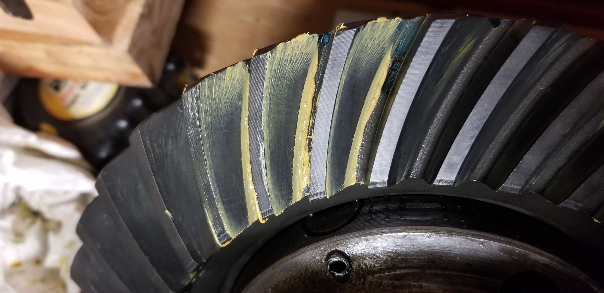

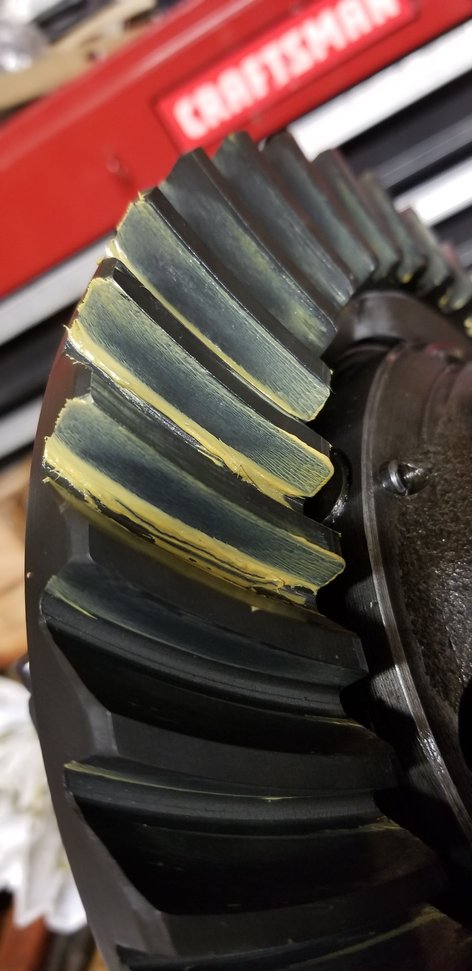

Here are pictures of the pattern with a little added resistance when turning
Drive side
Old Dec 4, 2018 | 09:04 AM
jswartz84's Avatar
jswartz84
Joined: Jun 2007
Posts: 2,723
From: Roseburg, OR
Coast side

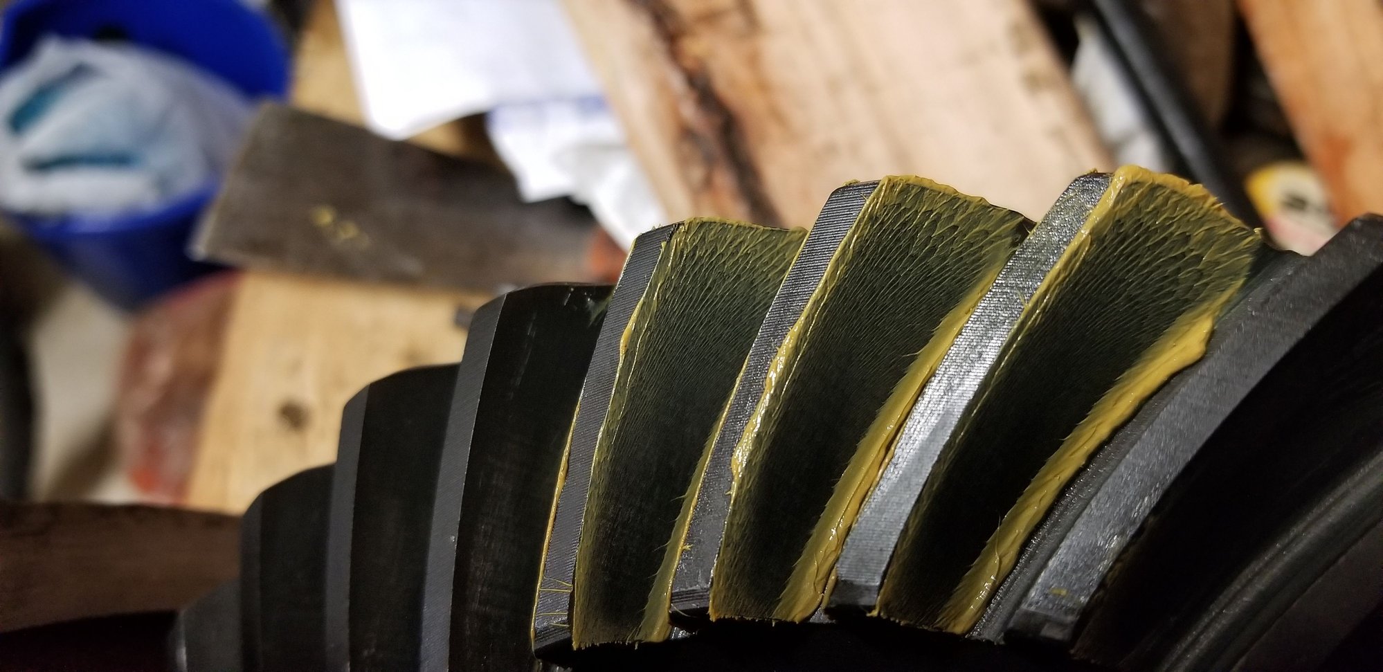

I sent these pictures to Motive for critique, the tech suggested to add .002 pinion shim. This is what it ended up looking like on the Drive side
Here is the Coast side.
He said that was it, button it up.
