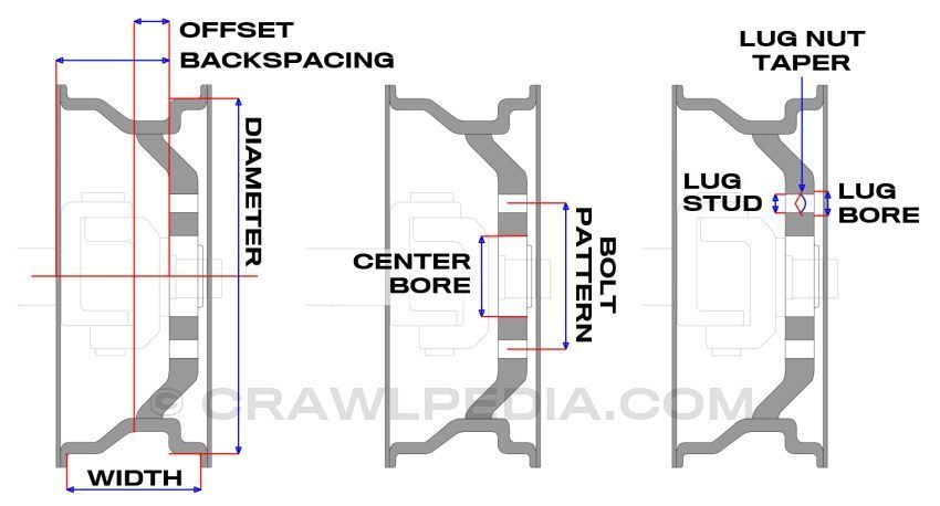

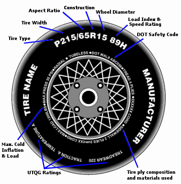

Wheel, Tire, Bolt Pattern, Lug Nut Information
The chart says 1988, but goes back to 1954.
Note: E250 and E350 rims fit up to 2014
The site that I got this from was up to 2008.
Note: E250 and E350 rims fit up to 2014. The chart that I got this from was up to 2008.

It is good info. Is there a difference between back set and off set?

Back spacing and offset are different.
Offset is the offset of the mounting surface from center. Usually close to zero, or within 1".
Backspacing depends on offset and overall width of the wheel. It is the distance between the inner lip, and the mounting surface.
