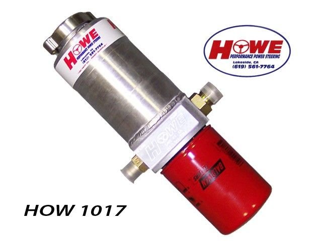

The Howe reservoir with built in filter can save some space if you are running the remote filter Lee suggest.
Products | Howe

Pirate4x4 Camo, do you have that on your truck? If so, howe does it steer?
not yet, But I’ve used them on 4 other rigs.
Still collecting parts to do a ram assist on my excursion.
Products | Howe
Now that is a trick res. I put Howe at the top of my list for the gear rebuild, due to the reinforcement they install on the superduty boxes and not hearing of any others doing that. I guess I hadn't scrolled down far enough because I completely missed that filtered reservoir.
