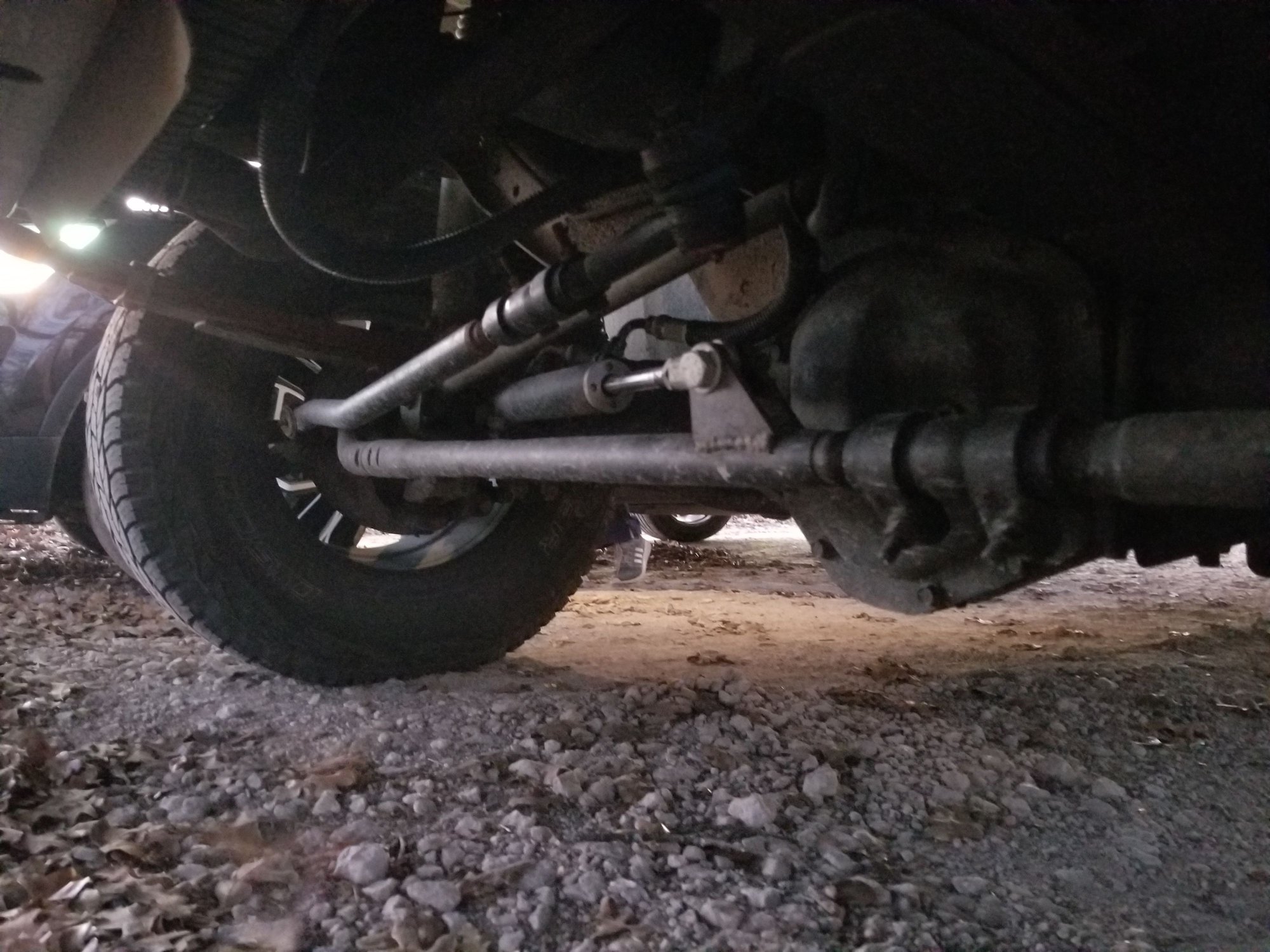

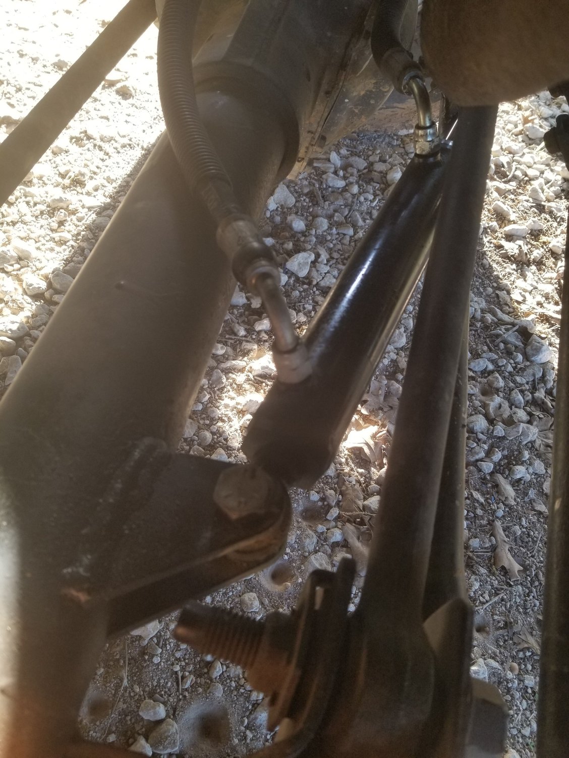

How did you mount your ram!?!?!
Old Mar 28, 2020 | 08:30 PM
  #45
CousinCarl's Avatar
CousinCarl
Joined: Oct 2008
Posts: 1,321
Likes: 250
From: North Texas
Welded to the axle housing and the tie rod.
