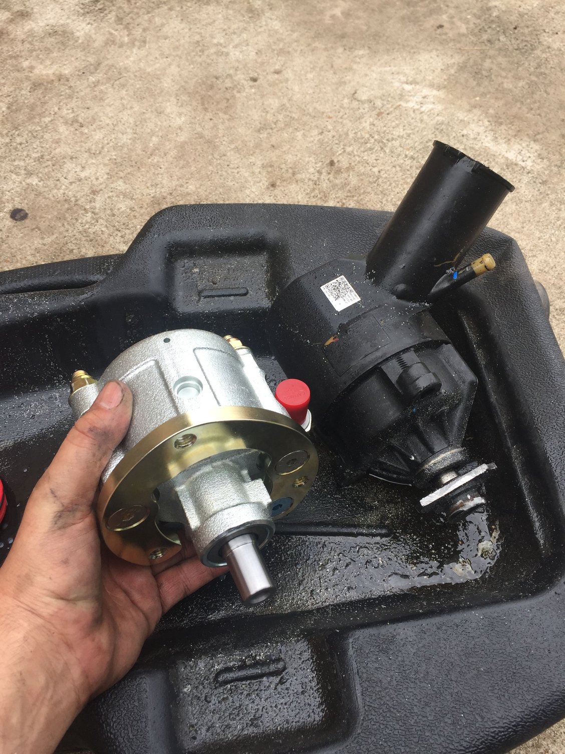

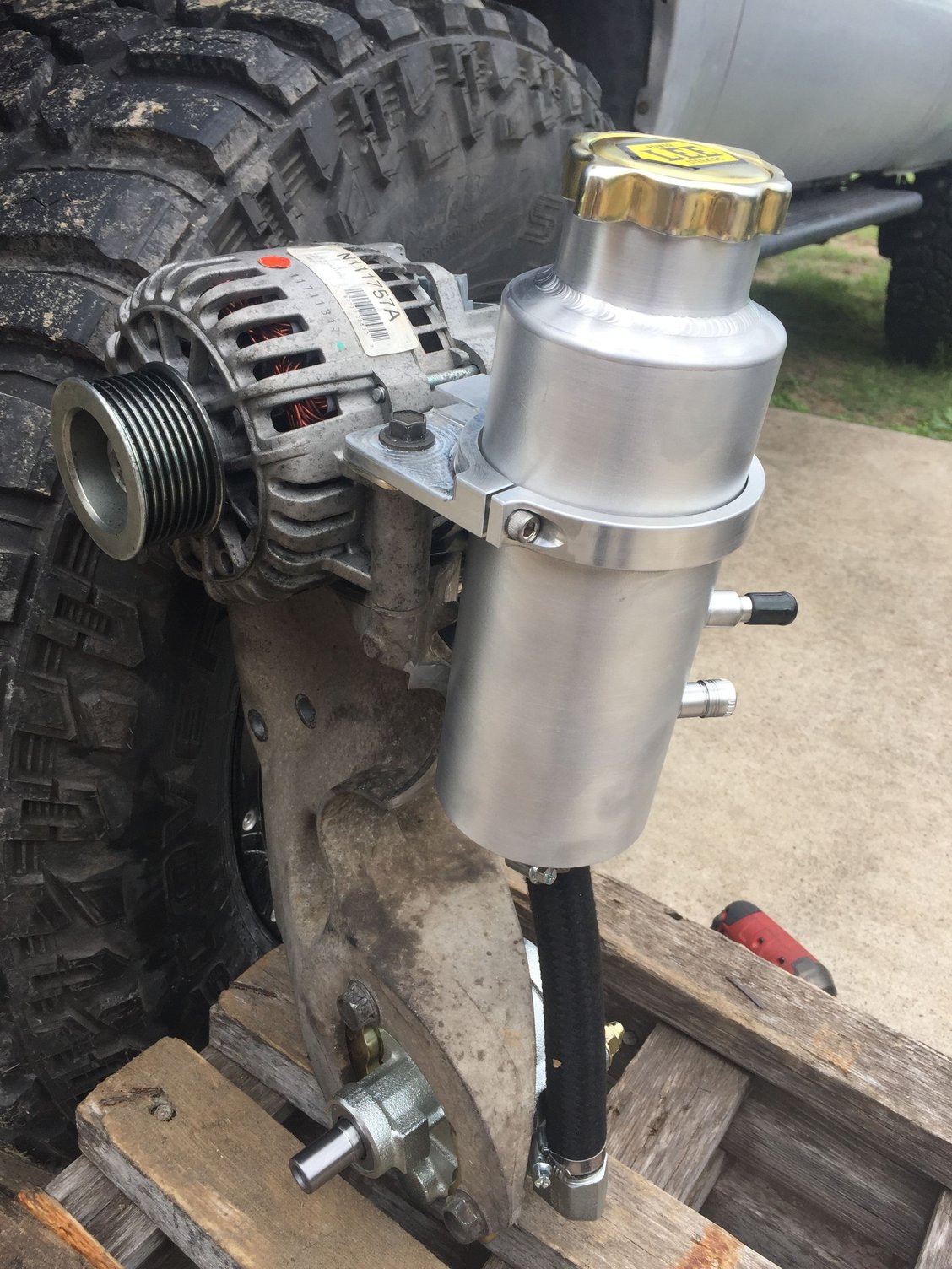

I finished my install yesterday after the previous pump failed within a week! Also replaced my Hydro-Boost unit with a motorcraft unit due to age and slight leakage inside.
With an S&B intake it is really tight but doable and I had to change the upper rad hose. The hose that routes outside if the belt would rest in the reservoir.
Test drove it today and it’s waaaaay better and quiet. Expensive but so far it’s worth it, AND I can easily check the fluid level with the S&B. BTW, I’m rolling on 38’s 👍🏼
New HB installed...
Saginaw N pump vs locked up week old unit
Reservoir will need turning once you start going on with piping and intake and line adjustments. Not complicated just tedious
That’s the most of it!
