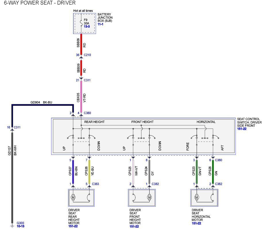

Here is a diagram from a later model with 6 way power seats. I suspect the operation is similar but maybe the wire colors are different. This is from a 2014 F250.
If you notice, the switches only change the polarity of the 12vdc going to the various motors.
