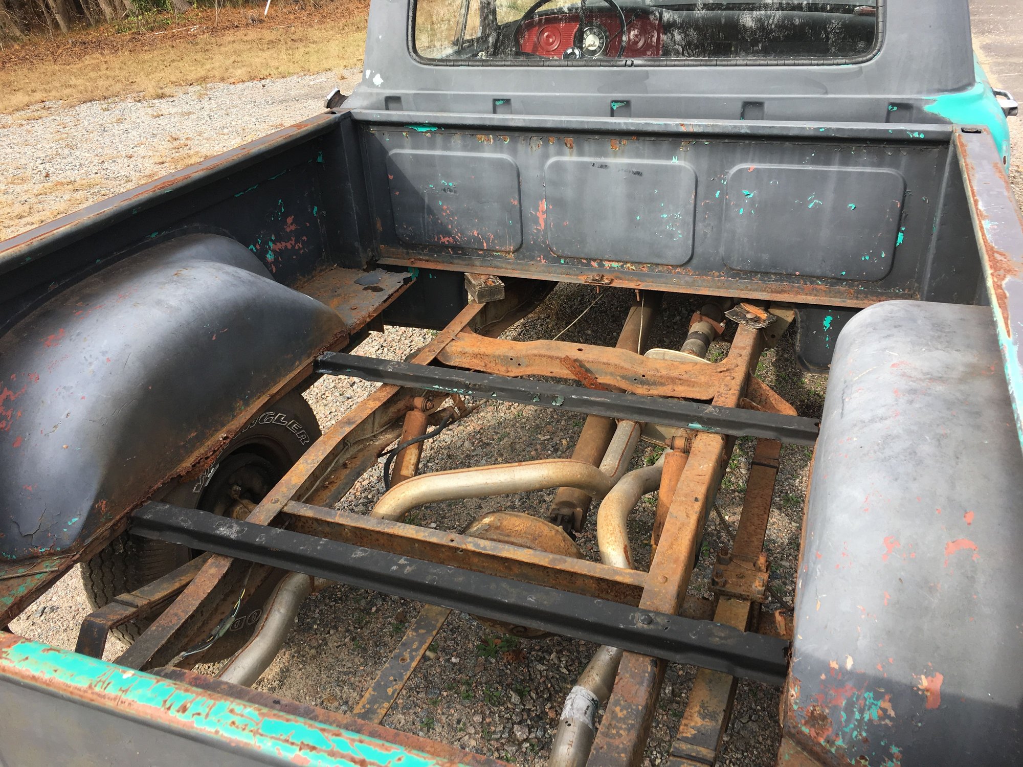

Looking for a few pics of cab mount and bed rebuilds. Been searching the site and it seems most vendors sell the tear-drop style mount although someone turned me onto Carolina classics and it seems like the sell a channel type mount just wondering which is correct?
Also I'm sure someone here has replaced the sheet metal on their bed before. Mine has been ripped out and the corner pieces are either removed or blown out same as the fender well. Would like some pics of how it should be so I can start the cleaning and dabbing process.

First pic is just something I found. Are the corner pieces welded in and the corrugated center bolted to them or all welded in? Also where's the best place to obtain the center? LMC sells it but they are 16" wide am I supposed to weld 2-3 pieces together?

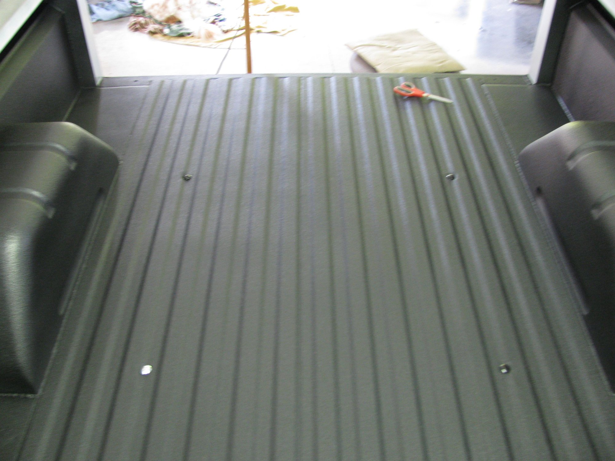

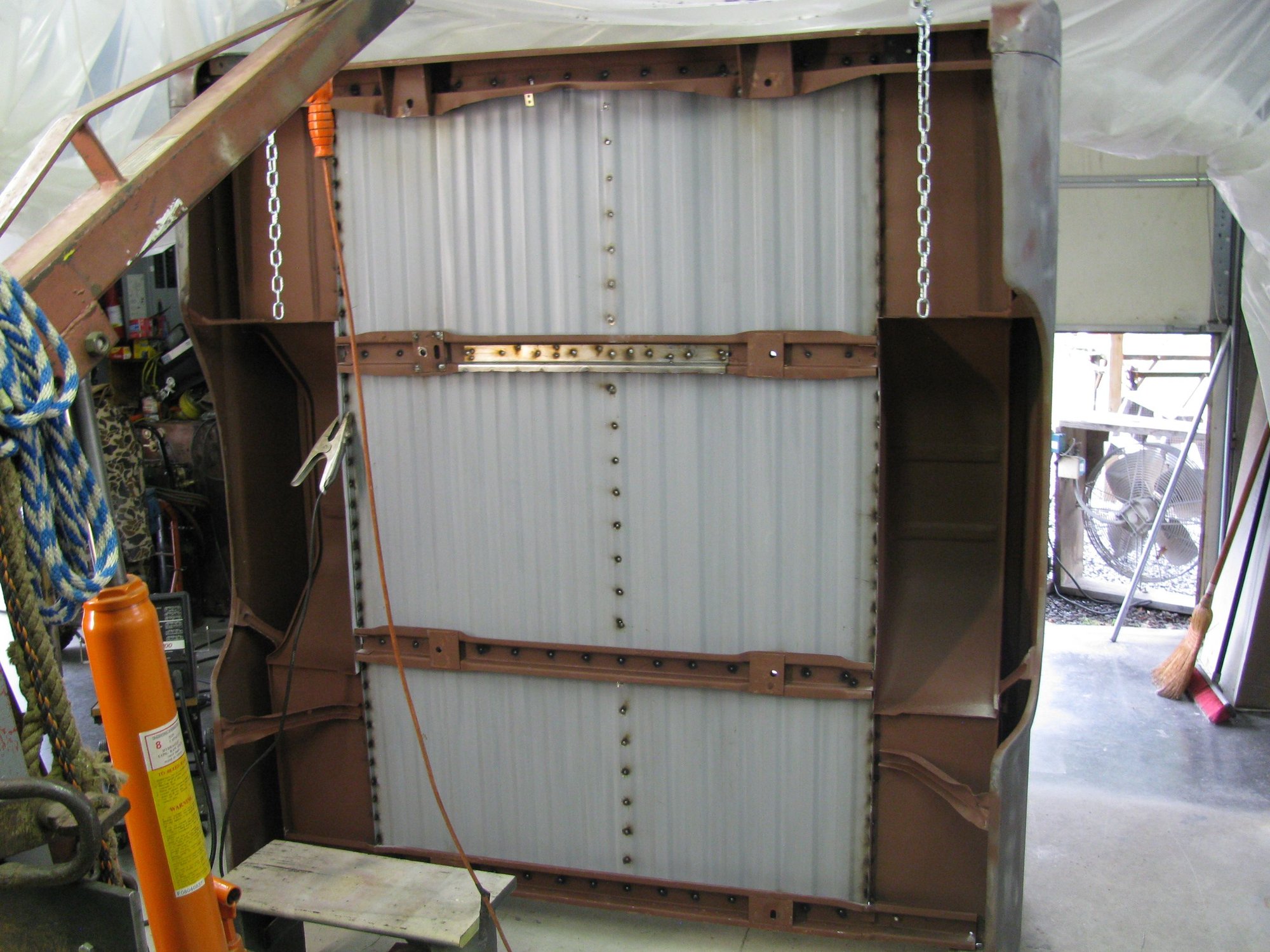

I think you need to be looking for another bed. Here are a couple of pictures of my bed. All the parts in these beds were pinch welded with a spot welder. The corner pieces can be fabricated from sheet metal. I used some bed floor pieces from Key Parts in Lynchburg, VA. '80-'96 BED FLOOR SECTION 1981-099 - Key Parts, Inc.
The main reason I used these was the local body shop supply goes up there to pick up parts every couple of weeks so I got a good price plus no shipping cost. I cut them to the size I needed then had the local sheet metal shop break the edges for the pinch weld.
