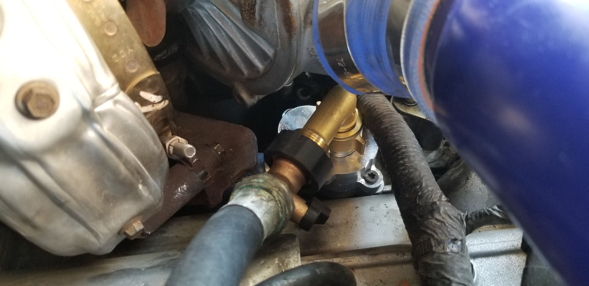

Here are pics of my oil cooler back flush setup

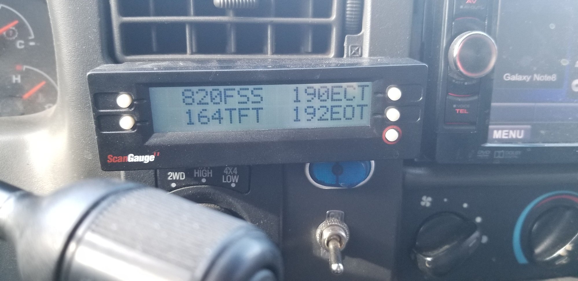

Mine are almost thirty degrees, almost. It is not making me as nervous as it should I suppose.
My oil temperature gets in the high teens, 218, but the ECT is 190 at its highest. This is in July doing 75 MPH for a long stretch. I monitor with Torque Pro and an old phone.
I see some guys with a five degree Delta but their temperatures are in the mid to upper 220s. I mean that is scarier to me since the oil will start to cook the fuel ~ 238°. Right?
If it hits 220F then I'll reverse flush. I guess I should say when....
