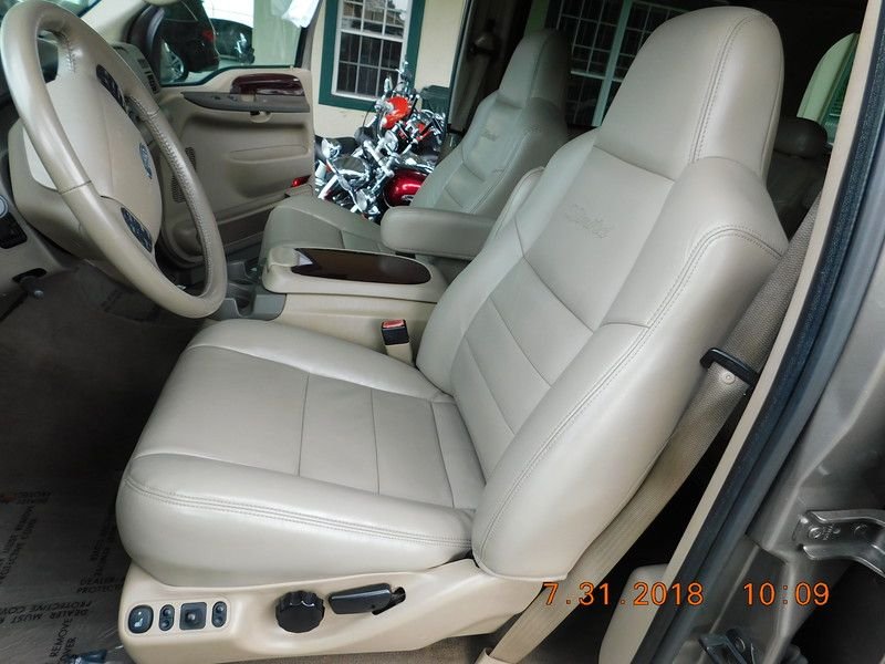

Front seats very unlikely original, third row is unlikely original, second row looks normal. Bonus as long as the replacement/re-covering was done well. A little suspicious that with all those photos they didn't show the driver's seat primary wear area, possibly just an accident. Make sure you get to do a cold start; show up early AM and touch several parts of the engine to verify it's cold before you fire it up. When you crank it be looking through the side mirror for exhaust smoke. While you crank it listen to the compression strokes and make sure the engine doesn't 'skip', speed up/slow down while cranking, it should be dead even compression strokes. It shouldn't sputter to life, it should crank 'till it fires; instant change. Start the test drive cold and drive long enough to get it fully warmed up. Test the billion electronic gismos; power & heated seats, steering wheel controls, 1/4 windows, etc. At the end of the drive when you turn the key off the radio & windows should still work 'till you open a door, then they all power off. If it doesn't do anything strange it's probably got lots of miles left in it. Injectors will be questionable if original. Price seems a little high for the miles, but it looks extremely nice so not bad if it all checks out. If you can get a "bring back guarantee" for a few days, some dealers will, that would be a big bonus.

Like already said the mileage wound really worry me if it checked out okay. The seats don’t worry me either. The seats in the Superduty swap out easily over so many years. Probably had them recovered as the old were a little tore up. If it checked out and I was in the market I would probably buy it. The prices for the work quoted above can be a lot less if you are handy with a wrench.

As has been said, those seats look to have been re-covered. My EX came with 214K had the same new seat covers put on when I bought them. Here's a pic of mine that were taken in July when it was for sale. I bought it it a few days after this picture was taken.
Take as much time as you can to run multiple tests of the electrical systems. I flew down to Orlando, from DC, to pick up this truck and drive it back. Everything tested fine, the 1000 mile drive back was uneventful. I drove it for another 1500 miles after coming back home before it decided to die on the freeway. Took some time ad $$ to diagnose and fix the dead PCM. But the EX is back on the road and running as before.
