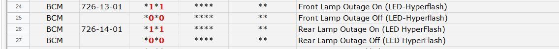

You could have used FORScan to change a setting to prevent hyper flash for your truck or gotten a dealer to change it. The hyper/fast flash happens when the system thinks there is a blown bulb.

I'm still under warranty, so I don't want to give them any reason to turn me down in the event something serious happens. That's why I haven't messed with Forscan. I know my dealer would've at least charged me for an hour of labor in order to do that with IDS though, so that was a no-go as well. I already had all of the housings out since I was changing the bulbs, and it took a maximum of 15 minutes total extra time to install all 4 resistors. I was only out an extra $9 for the resistors, and I'm fine with that. Everything works the way it should.
