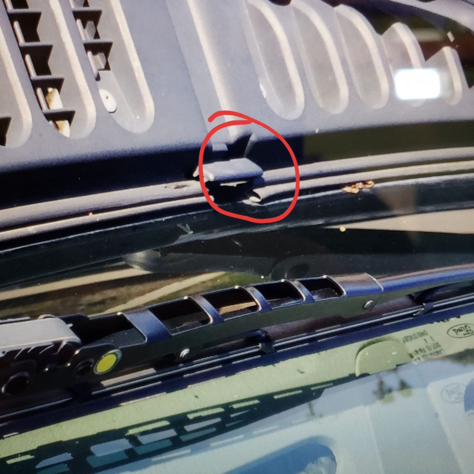

Missing windshield part
I'm getting ready to fix the water leak from the cowl and I noticed that I'm missing this center piece between the weather stripping. Does anyone know the part number for this and if it is essential or can I live without it? I attached some pics of the piece that I am missing. I couldn't find anything about it in the tech folder.

But you are gonna fill it anyway does it matter??
i filled mine and used a piece of plastic to help stiffen up the silicone. I wasn’t missing the piece in question

Seville, thanks for the suggestion but that isn't the right part. The part you suggested is the windshield glass spacer.
Flyboy, the part that is missing looks like it sits between the 2 pieces of weather stripping that sit between the cowl and the windshield not the larger weather stripping between the hood and hood side of the cowl.
Most of the tech folder repairs are between the left and right cowl pieces not that gap by the windshield.

i don't think i have that piece. i filled the gap under the hood like in the tech folder. no more water problems on my end
i am pretty sure the 2 pieces of weatherstripping are supposed to meet in the middle, mine do.

found my pic, i don't have that part. no water leaks through the center of the cowl.
