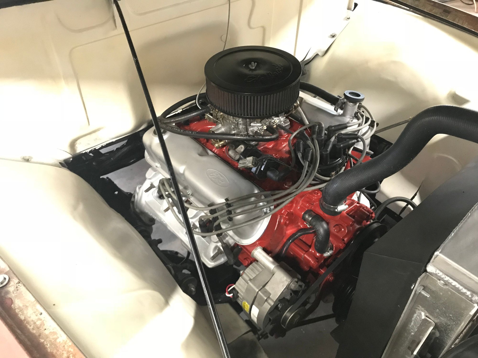

What would you do if you had a stock 351W, $2,500, and was sold on using that money to get more power out of your engine?
Some details for context:
Truck is a toy and not a daily driver - however driven to work 1-2 times a week and around town on weekends
No air, power steering, heater - i wanted the engine bay to be all engine and not accessories or hoses
All stock/basic engine - iron 4 barrel intake, cast exhaust manifold, E7 iron heads
600 cfm edelbrock manual chock
duralast/spark (forget which) control module
basic stock dizzy
bored 30 over - rebuilt about 5 years ago and approx. 5K miles
351W came from a 1985 F-250 - hyd flat tappet
4 speed toploader
3.27 gears in an 8.8
I appreciate your time reading and replying. If you are in this forum and especially the SBF threads you have an opinion on the above.
