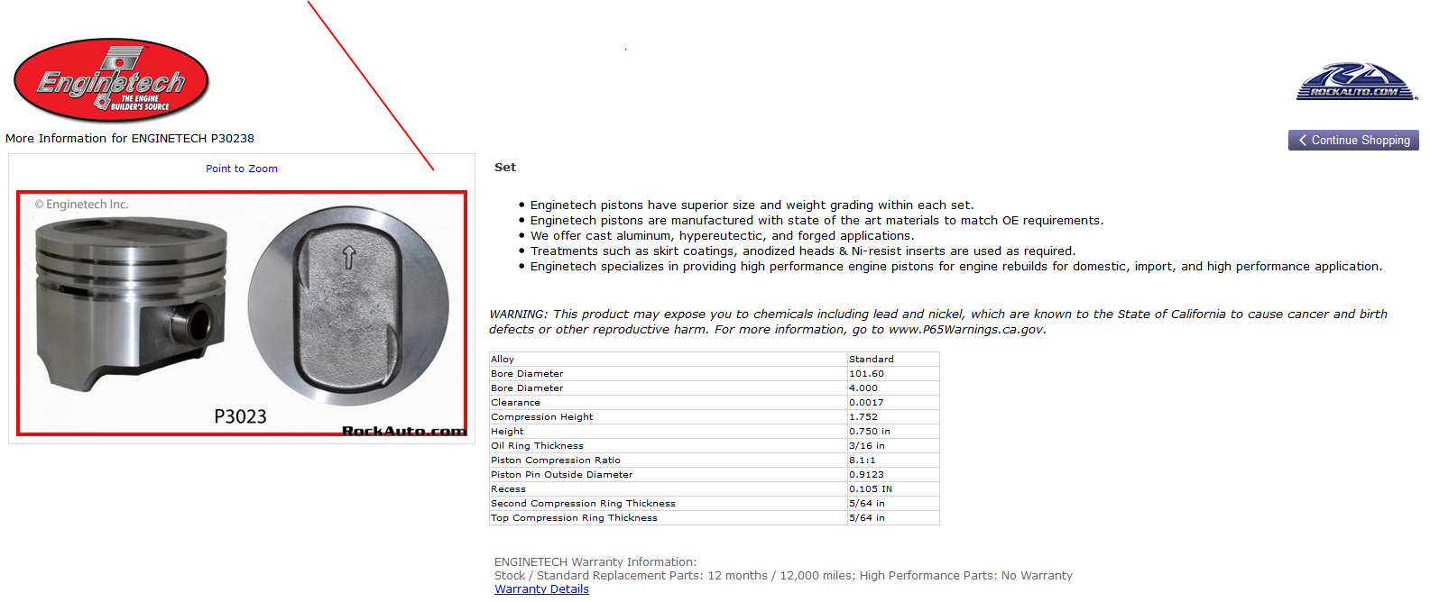

I think the Edelbrock Performer heads have the 1.94 intake valves.
Just wondering, with that AFR 165 head and that cam with .551/.551 lift and .224/.224 duration, would it be necessary to open up the valve reliefs in the piston?
I would check the clearance but those dishes are pretty deep as they are.

Sorry, just looked back to earlier postings (seemed so long ago) and realized you said this before.
My mind is set to the 5.0 engines, so not sure if they also have similarly dished pistons, or what their limits are for valve lift and duration.
5.0's had flat tops with 4 eyebrows. 351 had a generous rectangular dish.

So stock 302 pistons would have much lower limit on valve lift and duration?

Yes, they would. The pistons I see in his pics have pretty generous reliefs in the dish, shouldn't be a problem with the cam specs. They're not stock 351W pistons.

These are the pistons I have in the engine. I assume the recess is the valve relief?

The relief is the round cut in the corner of the dish. That'll be the intake valve relief. The dish is apparently deep enough to clear the exhaust valve.
