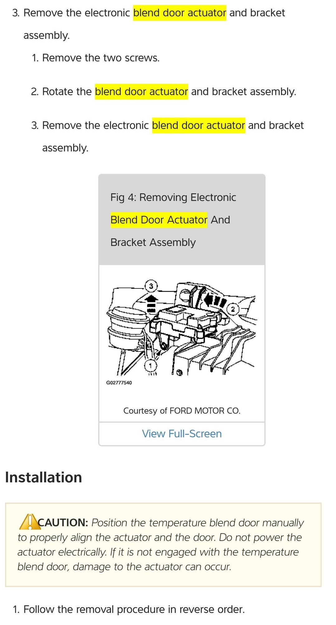

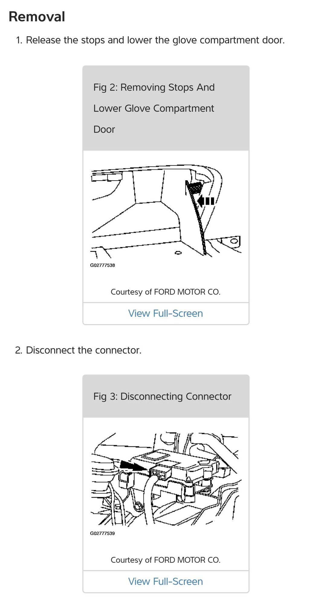

Year? Electronic controls or mechanical?
If the blend door actuator is suspect, it's accessed by lowering the glovebox. It's on top with a plug and couple of screws.
