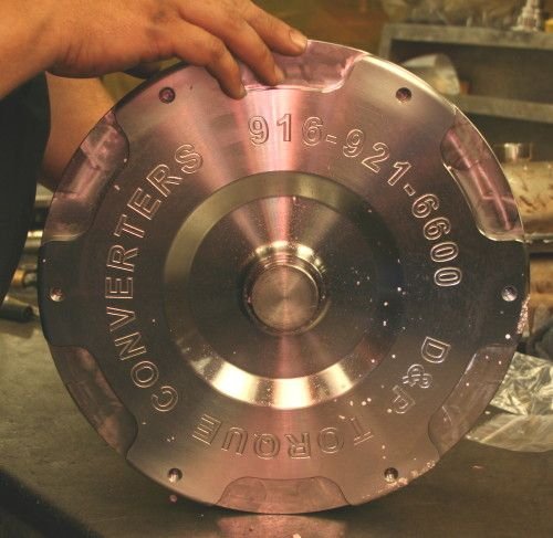

I don’t know squat about the converter you posted but since you are in the market for one you owe it to yourself to call D&P Torque Converters in Sacramento, a small family owned manufacture that hand builds custom converters at a competive price.
I have run them on all my race cars and have one in My excursion.
Give them a call, I think you will be glad you did. (916) 921-6600)
