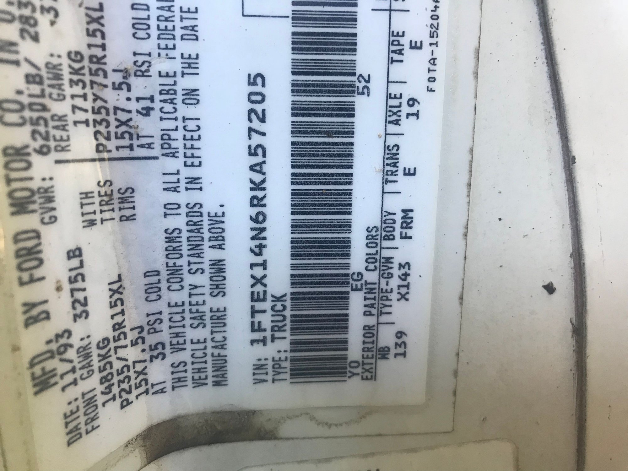

A 1994 302 usually would be mated to a 4R70W. Are we sure it's an E4OD that we are working on?
Maybe Code 629 is directed to an E4OD, I'm not sure.
What is the trans code on the door pillar?

its E, plus on the crossmember says e4od
