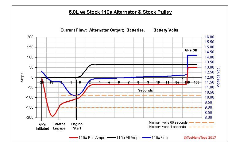

Either one of these will get the RPMs up a little higher without detriment to the alternator and fits without any belt change.
https://www.ebay.com/itm/Ford-3G-6G-...e/191609911806
https://www.amazon.com/OVERDRIVE-GROOVE-PULLEY-output-ALTERNATOR/dp/B014GABSAU/ref=pd_bxgy_263_2?_encoding=UTF8&pd_rd_i=B014GABSAU&pd_rd_r=e34c43ca-e5d9-11e8-986a-c9cb69152779&pd_rd_w=a9HJE&pd_rd_wg=aAZFU&pf_rd_i=desktop-dp-sims&pf_rd_m=ATVPDKIKX0DER&pf_rd_p=6725dbd6-9917-451d-beba-16af7874e407&pf_rd_r=67JT6VWWFTWDTBEKJ38S&pf_rd_s=desktop-dp-sims&pf_rd_t=40701&psc=1&refRID=67JT6VWWFTWDTBEKJ38S https://www.amazon.com/OVERDRIVE-GROOVE-PULLEY-output-ALTERNATOR/dp/B014GABSAU/ref=pd_bxgy_263_2?_encoding=UTF8&pd_rd_i=B014GABSAU&pd_rd_r=e34c43ca-e5d9-11e8-986a-c9cb69152779&pd_rd_w=a9HJE&pd_rd_wg=aAZFU&pf_rd_i=desktop-dp-sims&pf_rd_m=ATVPDKIKX0DER&pf_rd_p=6725dbd6-9917-451d-beba-16af7874e407&pf_rd_r=67JT6VWWFTWDTBEKJ38S&pf_rd_s=desktop-dp-sims&pf_rd_t=40701&psc=1&refRID=67JT6VWWFTWDTBEKJ38S
This is a comparison from the stock 110a to a 140a with the small pulley. I haven't uploaded the graph for the 140a stock pulley publically. The line colors are mixed so that's a screw-up. But you can use the 140a graph and compare what you are seeing for volts currently. Be aware though that these voltage readings are at the battery or alternator, harness reading from the OBD port of power port will be down about 0.5v.
And the price is low enough that if you still want more power you can always go to a higher amp unit.
